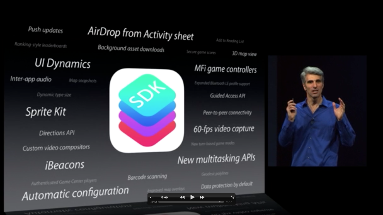

iOS7 WILL support 60fps video!
Confirmed in the keynote today that iOS 7 will support 60fps video recording for third party applications! Can't wait! :D
I really hope it's 1080p60 and not just reintroducing 720p60 fps as a brand new feature. (let's not forget that that 720p60 on the iOS5 4S isn't really 720p: it allows for only half-resolution recording and only at 720p; this means the effective vertical resolution was 360 rows).
I'll very soon test it as soon as I get back my (or a new) iPhone 5 from Apple, assuming it arrives with 6.1.3/4. Will be installing iOS7 on it ASAP.
Don't expect miracles: the same crippled (half-res) 720p60 mode as under iOS5. See https://forums.macrumors.com/threads/1600113/ for my first iPhone 5 report and actual example code.
1. Unfortunately, the currently available 720p60 modes use binned recording in both dimensions, meaning both vertical and horizontal resolution is halved. In this regard, it's definitely inferior to iOS5.
