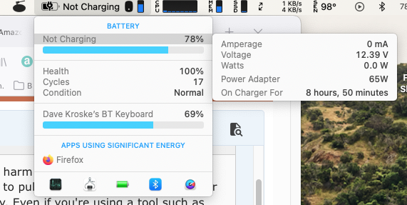

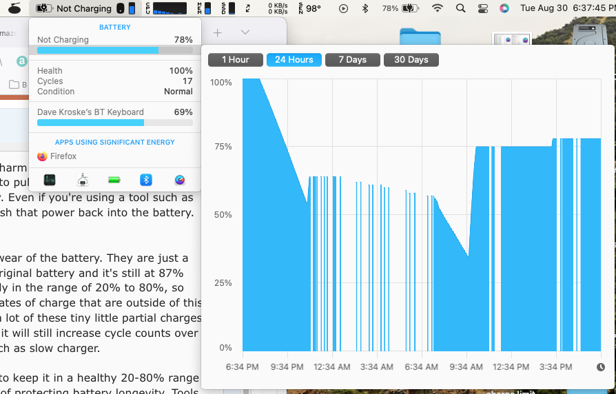

I have my AlDente App limit SoC to 75% and will make every effort not to let the SoC drop below 20%*. During a work day, being plugged in until the end of that day's use, both my Apple 67W and ordered Anker Nano 20W chargers would keep the MBA M2 battery topped off at the 78% SoC level (AlDente set at 75%). I'll have to see if I can tell from iStat Menus if I ever see any actual charging. When I have looked, I see zero watts and zero mA. So far, AlDente seems to maintain a 78% charge, 3% over my set limit of 75%. No big deal.
1) Would the Apple 67W charger's charging profile or the Anker PIQ (PD+) 20W's charging profile with AlDente set at 75%, not actually send current to the battery in a 10-hour work period? Would both chargers just regulate their watt/voltage output to match the ≈ 7.5 watt normal use rate, and jump up to cover the very infrequent spikes to 9 or 10 watts?
2) Would whatever VERY minimal charging over say a 10-hour work period be about equivalent to making up for say the minimal battery drain if the MBA was closed and sleeping for a similar period?
3) Or would it be equivalent to the even much smaller mini SoC drain from the MBA being actually shut down for that same 10-hour period?
There may not be significant difference in maintaining or replacing the SoC in the three scenarios above. My mind just wonders as a thought experiment how the process works. I always appreciate hearing from EE's or knowledgeable folks willing to explain in the weeds technical processes and theories. :)
1) This is a great question. In the world of electronics, there's actually a little saying that states "power is drawn, not delivered". The power adapter actually isn't forcing 20 watts of power into the computer, it's just providing whatever the computer needs, up to 20 watts (or whatever the adapter is rated for). In very simplified terms, the computer just draws whatever it wants to use from the adapter, and if it isn't sufficient, it will pull the rest from the battery.
You might also be curious what would happen if the computer tried to draw too much power from the adapter. The Mac could try and it won't start a fire, but there would be a sudden voltage drop on the power adapter as soon as it couldn't deliver any more amps. This would force the laptop to draw the rest from the battery. Incidentally, batteries themselves have limits on how much current can be drawn too, which is why very old batteries sometimes can't keep up and result in sudden shutdowns on phones and computers.
If, on the other hand, the computer only needs 10 watts, it will only draw 10 watts from the adapter and won't draw any more (which would be wasted as heat if it were to be drawn anyway, which is why it's a very good thing that circuits don't do this!)
If Aldente is set up to not charge the computer, the Mac will only draw what it needs to run the computer and won't send any excess current to the battery unless it drops below the target battery charge. Aldente Free actually will automatically make minuscule adjustments and make sure to maintain that charge, so if the Mac has to pull any excess current from the battery, it would return that current later in minuscule charge amounts. Aldente Pro has an optional "sailing mode" feature that prevents this behavior if you desire it.
2 & 3) A little unsure on these. There are things besides just power drain to worry about as well, the battery management system has to keep up with self-discharge and things of that sort too (although self discharge for lithium ions is typically in the realm of a fraction of a percent per day). I'm not sure how this is handled under the hood, other than that I know that Apple widely uses Texas Instruments chips to do this (the datasheets on them might have more info). Someone else might be more qualified to discuss this sort of thing than I would.
I would guess using a 10W charger in some cases would be more harmful than a higher wattage charger. If you're doing something a bit more intensive and the computer needs to draw more than 10W it'll pull the excess from the battery. So you might be going through a phases where the computer uses power from the charger, then battery, then charger etc. etc. and I can't imagine this is better for the battery than just using a higher wattage charger.
Other than that IIRC the best way to maintain battery health is to keep the battery away from >80% and <20% charge.
