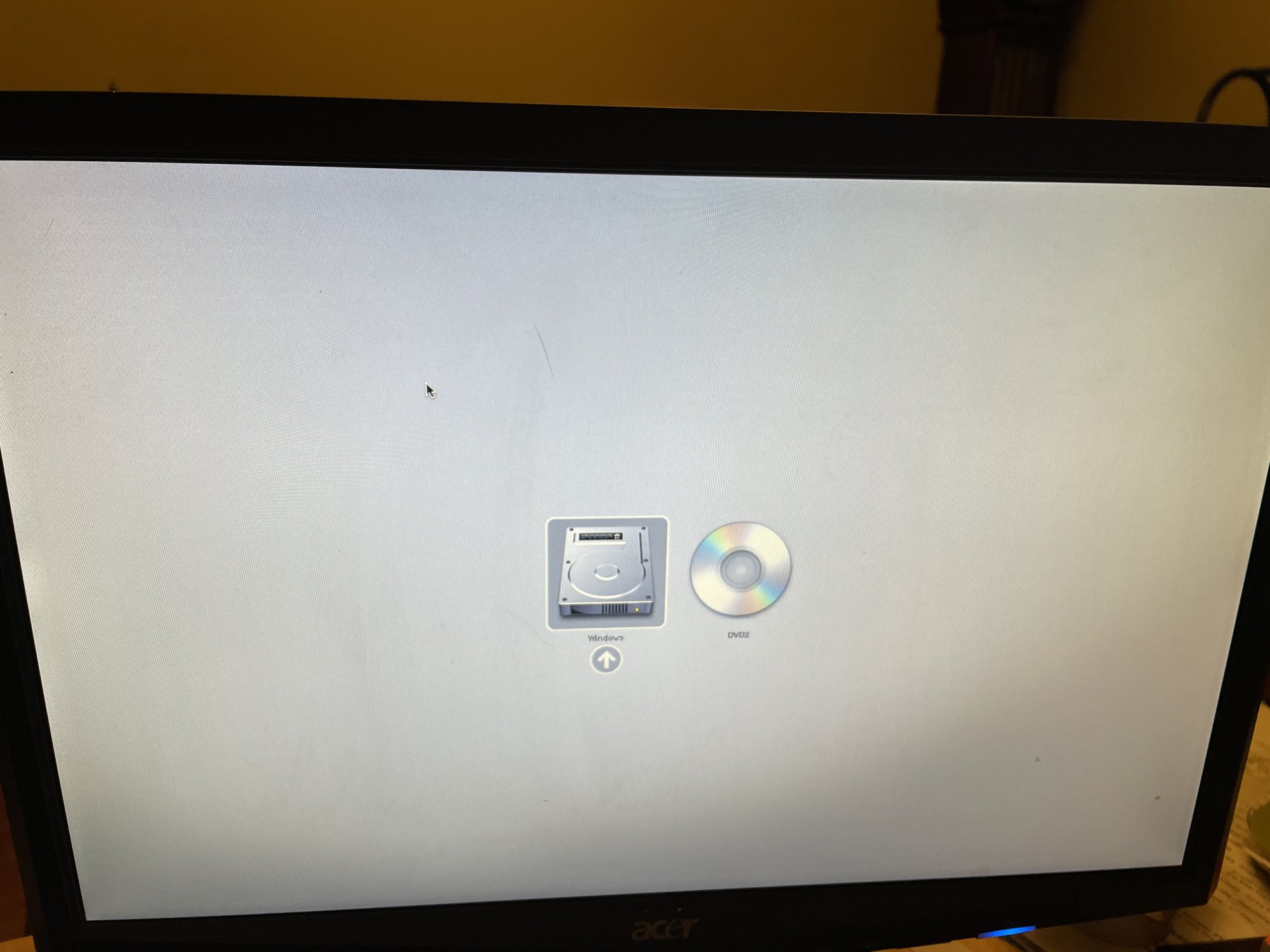

ok, so now it shows the drive but as a windows drive. i try to run the disk as before and still stops at the apple logo. no spinning wheel, and no loading bar. on verbose mode, same stopping point as well.
If I try to click on the hard drive, then it just shows a black screen with the text that reads " An Operating system wasn't found"
I'm guessing then that it has to be formatted using a mac. I did take the ssd to my Brothers and used his Mac to format the ssd. it worked to format it using his mac mini with Monterey on it. when I brought the ssd back to my Mac. it wouldn't see it.
My end goal is to run Lion on it. I had originally thought that I could just buy it from apple.com and they would just send it to me with instructions on how to install it to my mac. That was a rude awakening... now I'm out 20 bucks on that OS, and the 20 dollars to buy this goofy disk with snow leopard, and the 60 dollars to get the native hard drive and gpu it came with when sold new. Apple Support is not much help... One of the "Techs" laughed at me when I told him what I was doing and said I was stupid for doing it!
I know it isn't new. Just not every day someone hands you a mac pro... no matter how old it is, I still say its pretty cool...

At the stage it sees the drive as a Windows drive you should be able to click in the menu bar above and get to Disk Utility.
You could try re-formatting it with that to a Mac format (maybe HFS+ or APFS).
I'm not entirely clear at what is not booting exactly. If the DVD is not booting fully then it might be faulty.
Now it's formatted you could try the internet installation again and see if the drive turns up this time.
Now it's formatted you could try the internet in stallation again and see if the drive turns up this time.
when I formatted the ssd the first time using my Brother's Mac mini, it was before I knew anything about HFS, or APFS. I could have done it wrong... 65877A0F-867D-48BA-8DFB-AB4E29ED0971.jpeg
Is the menu bar supposed to be on this screen?

No.
It will appear if you click on the DVD and it boots fully.
But now the drive is visible you may be able to run internet recovery which I believe you tried earlier?
If you run that and it asks where you want to install macos and your drive is still visible you should be able to install a version of macos.
The different key holding options offer different versions of macos. One offers the OS that your mac came with and the other offers the latest compatible version for your machine.
You'll need to google the one you want as unfortunately I can't remember which is which :)
