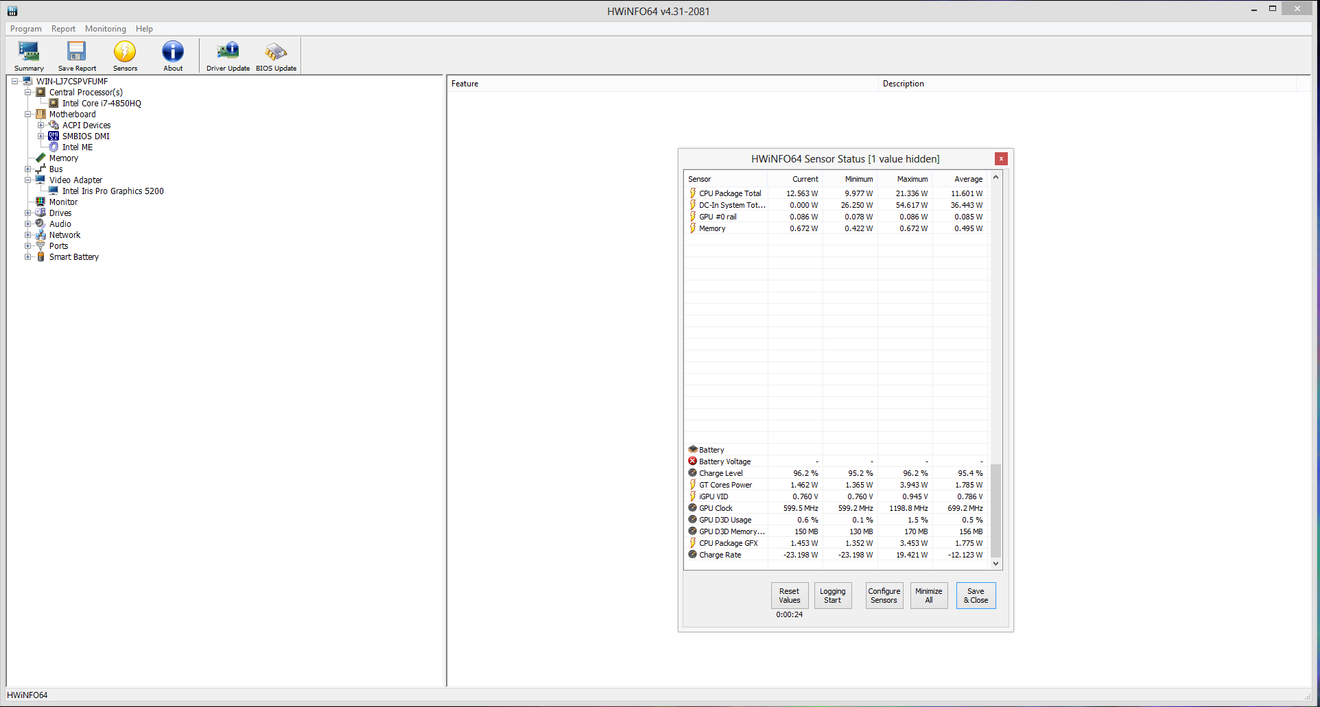

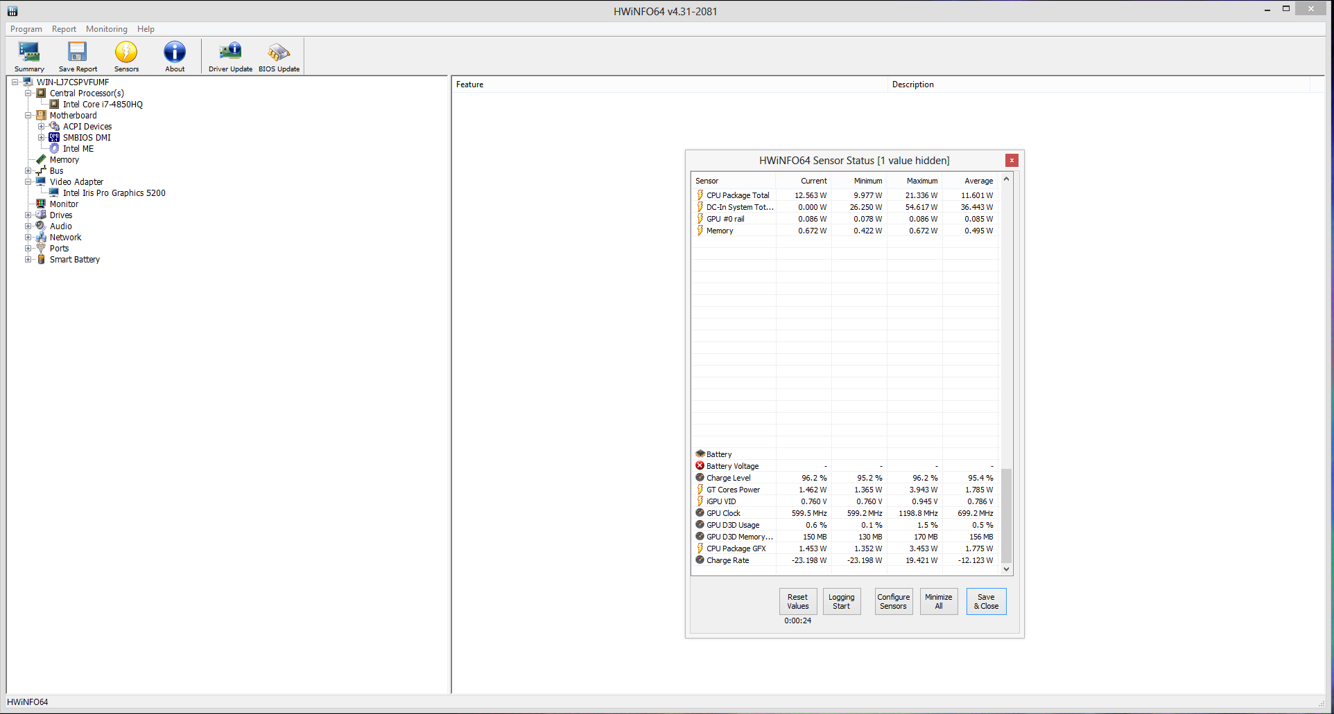

@Andreas,
Great job! Got it to work on mine, too. It was, indeed, the boot-time dGPU activity that prevented the disconnection. Forcing the Iris Pro with gfxCardStatus solved the issue, as you found out.
Now, the weird thing is - I still cannot boot with dGPU powered down. But if I just switch to Intel GPU in GRUB and then boot into Windows and >then< switch the dGPU with the WinGmuxCtrl tool, it works just fine.
Finally, the result is virtually no power draw from the GT750M:
https://forums.macrumors.com/attachment.php?attachmentid=457334&stc=1&d=1390247497
