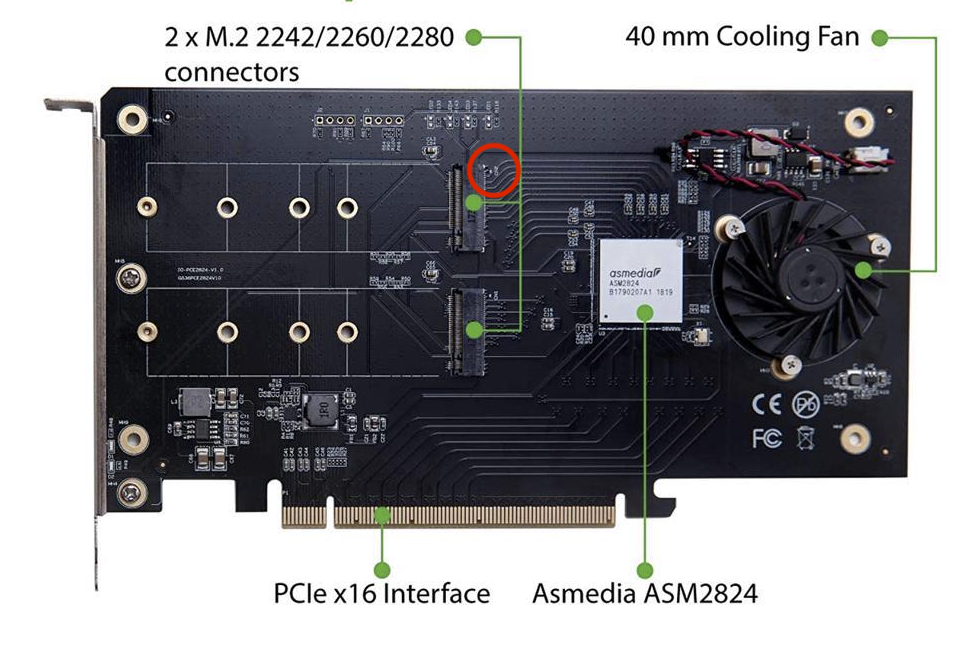

On a side note...I looked over my Syba card before installation and saw no markings for 0 and 1.
Look at the red circle I made, CH0 is circled and you can see CH1 next to second connector.

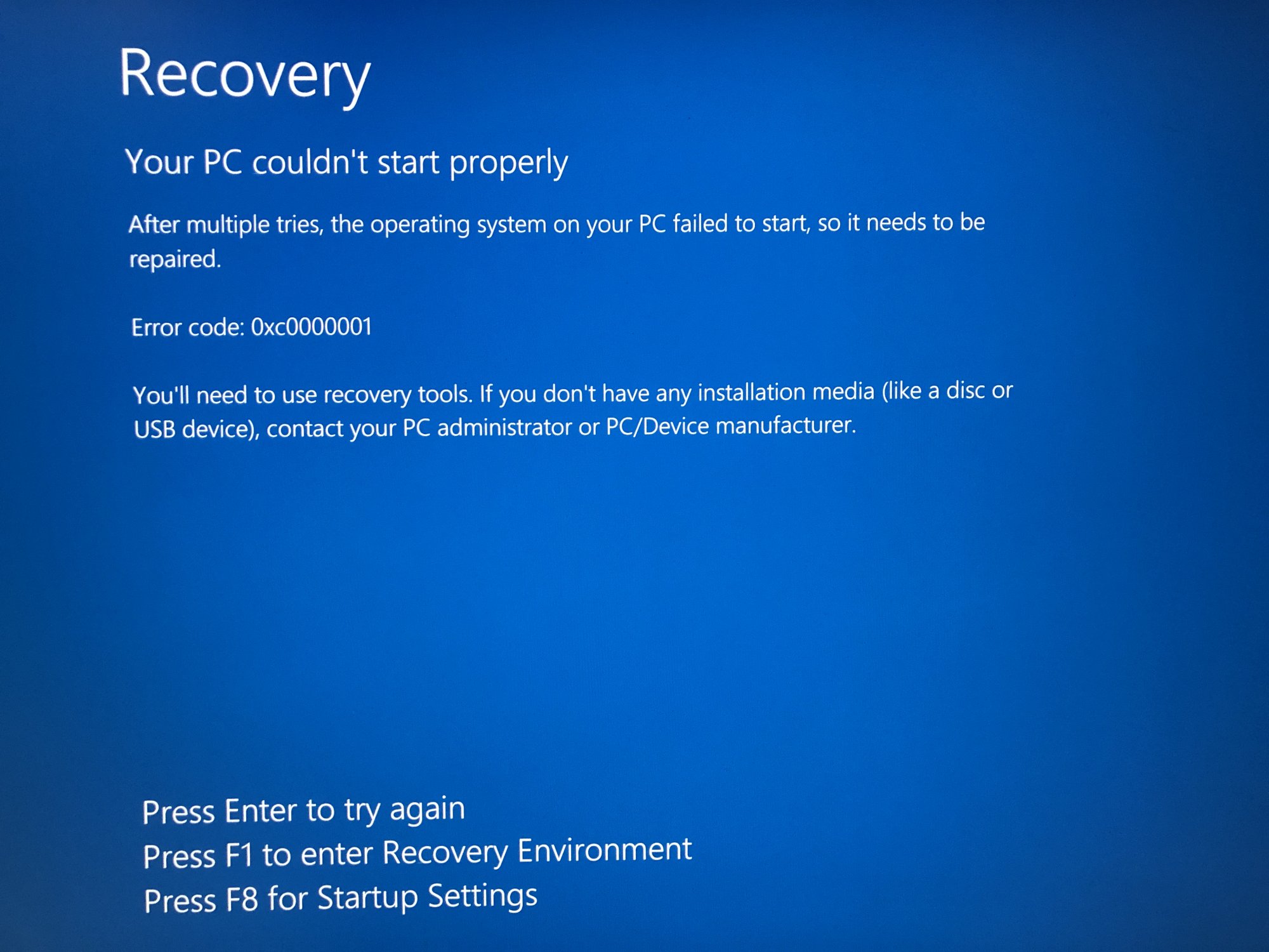

There is something interesting I noticed in Windows 10, once the frozen logo event occurs. After the 3rd reboot, I can access Windows but my Apple Magic Keyboard and Mouse2 are not functional anymore. This occurred twice, so far.
I have to plugin a wired keyboard to login, then remove the non-functional Apple hardware from the list of Bluetooth devices, turn off/on the little green switch on each device, then discover the devices back.

Ran into this again today after a few weeks of no issues. It was installing an update in windows and it then refused to restart past the Blue Logo. I went into OSX and the same Windows partition booted no problem in Parallels. I noticed that the CMP was now defaulting to the windows partition on the Opencore bootpicker instead of my OSX drive on reboot so I reaffirmed the startup disk in OSX as the OSX NVME drive. The next time I booted Windows natively it started right up. Not exactly sure what caused the issue or how it resolved itself. I did see some Windows users on another forum discussing a similar issue with Windows 10 having a brain fart and forgetting which drive to boot from during an update so maybe it’s related.

@calmacfan same thing for me, Windows drive defaults after frozen screen. I have to manually set the macOS drive as default.

Really went to town on this issue last night. I ended up following the instruction in the Opencore Read Me file regarding mounting the Windows NONAME/EFI partition via Clover Config, renaming the partition and dumping the Opencore Boot and OC folders into the Windows EFI Folder. I followed the instructions but on reboot the Windows Blue Logo screen still got hung up. I reversed all the Windows EFI changes including the NONAME renaming back to how I found it apart from the BOOTX64.EFI file which I left as was, dumped from the original Opencore folder replacing the original windows one. When I restarted to the Opencore bootpicker and rebooted the Windows partition it booted no problem. I’m starting to wonder if the Windows Blue Logo hang up issue is related to a corrupted BOOTX64.EFI file/Opencore issue/conflict. I don’t know much about that EFI file but I’ve rebooted a few times now and it seems to be sticking. I’d yanked all of my Opencore Mac drives earlier as well and just booted with the Windows SSD in the CMP. That booted with Zero problems as well but wanted to take over as the sole OS which caused me some headaches. Any thoughts?
For what it's worth, when I get a frozen windows boot that isn't repairable via its own auto repair, a refresh of the windows efi boot files (saved from the USB backup during install) usually fixes the boot for me until the next time it brain farts.
I've noticed it'll happen more often after windows updates.
Pretty sure this is not the case, that is because after 3 consecutive reboots, a Windows repair screen show and I can boot find into Windows. I checked the bootx64.efi file and it is unchanged.
Reboot 3 times, it will work without changing any files the 4th time.
My Windows install wouldn’t take my MS Password so Auto Repair/System Recovery was a complete dead end. Eventually it wouldn’t even go to the full recovery menu and just dumped me straight into the Startup Repair path which again wouldn’t engage because Windows refused to take my confirmed MS Password. Frustrating.
Ah yeah I know, that's what I usually do, but sometimes it'll loop back to the "freeze+reboot x3 + auto repair" again, and again, and the only fix I found for me was to redo those files.
