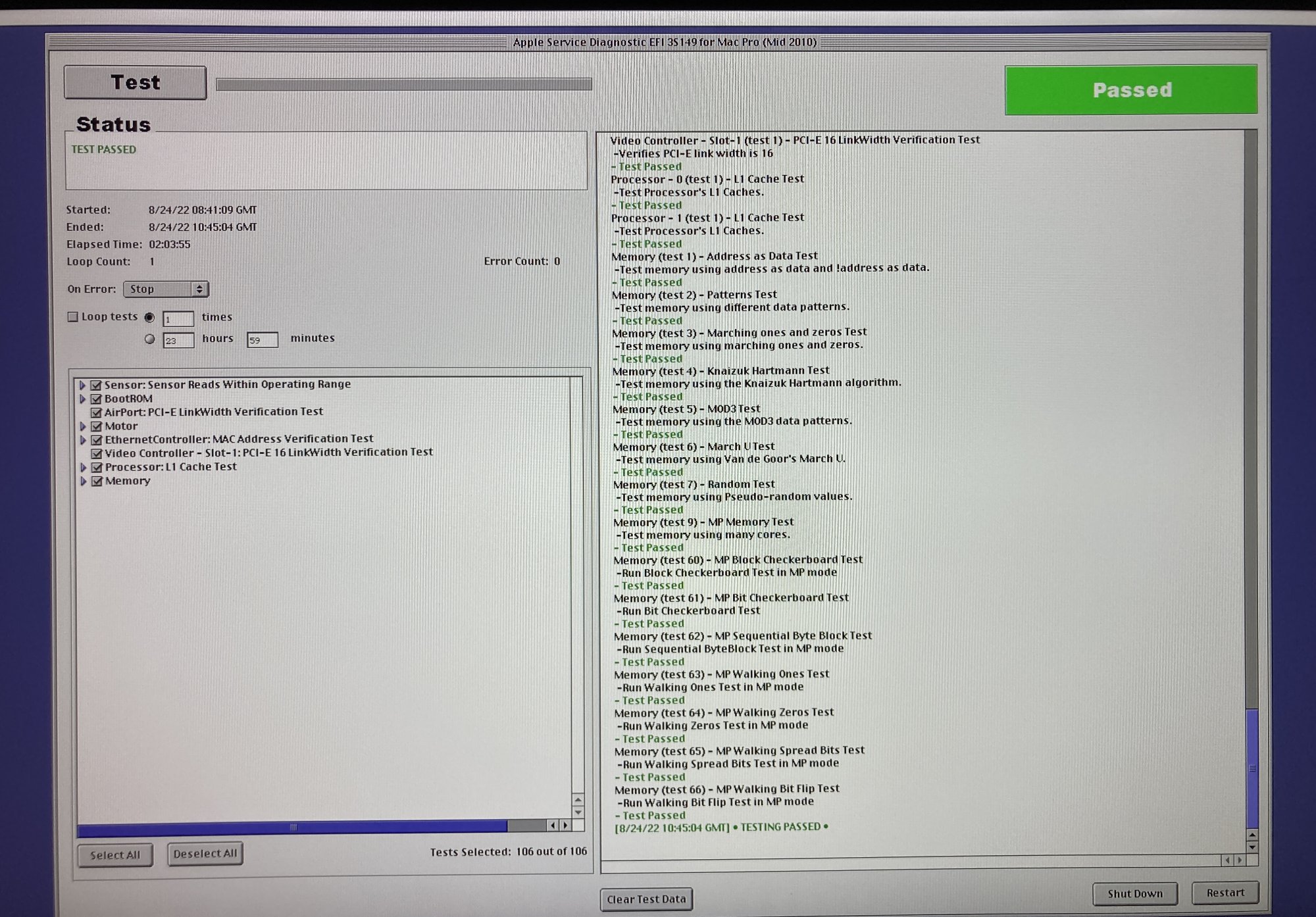

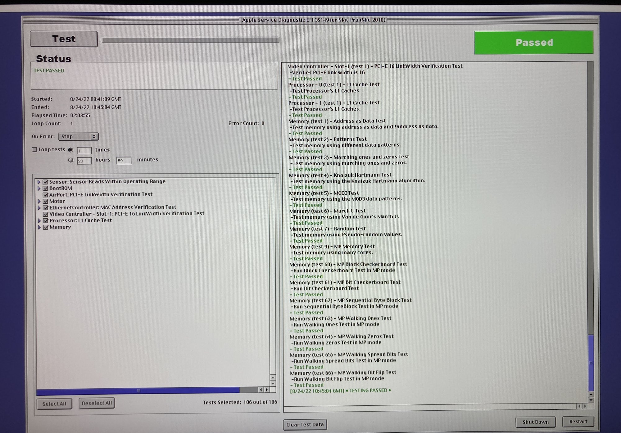

ASD passed. No drives were installed during testing as they are all new and I didn't want to risk any corruption of OCLP or anything.

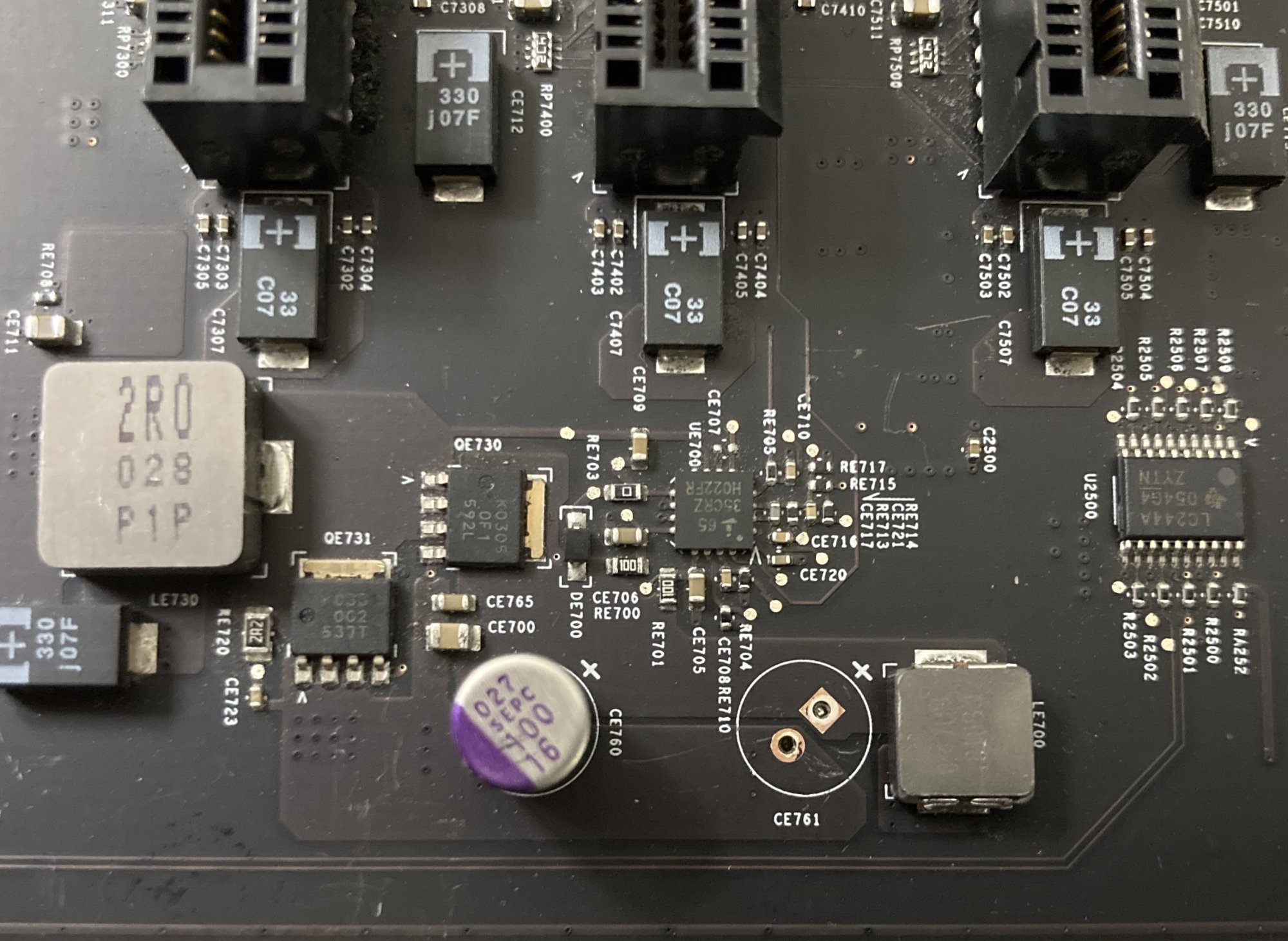

Also, any resources on acquiring the capacitor or should I just search around?
Thanks in advance!

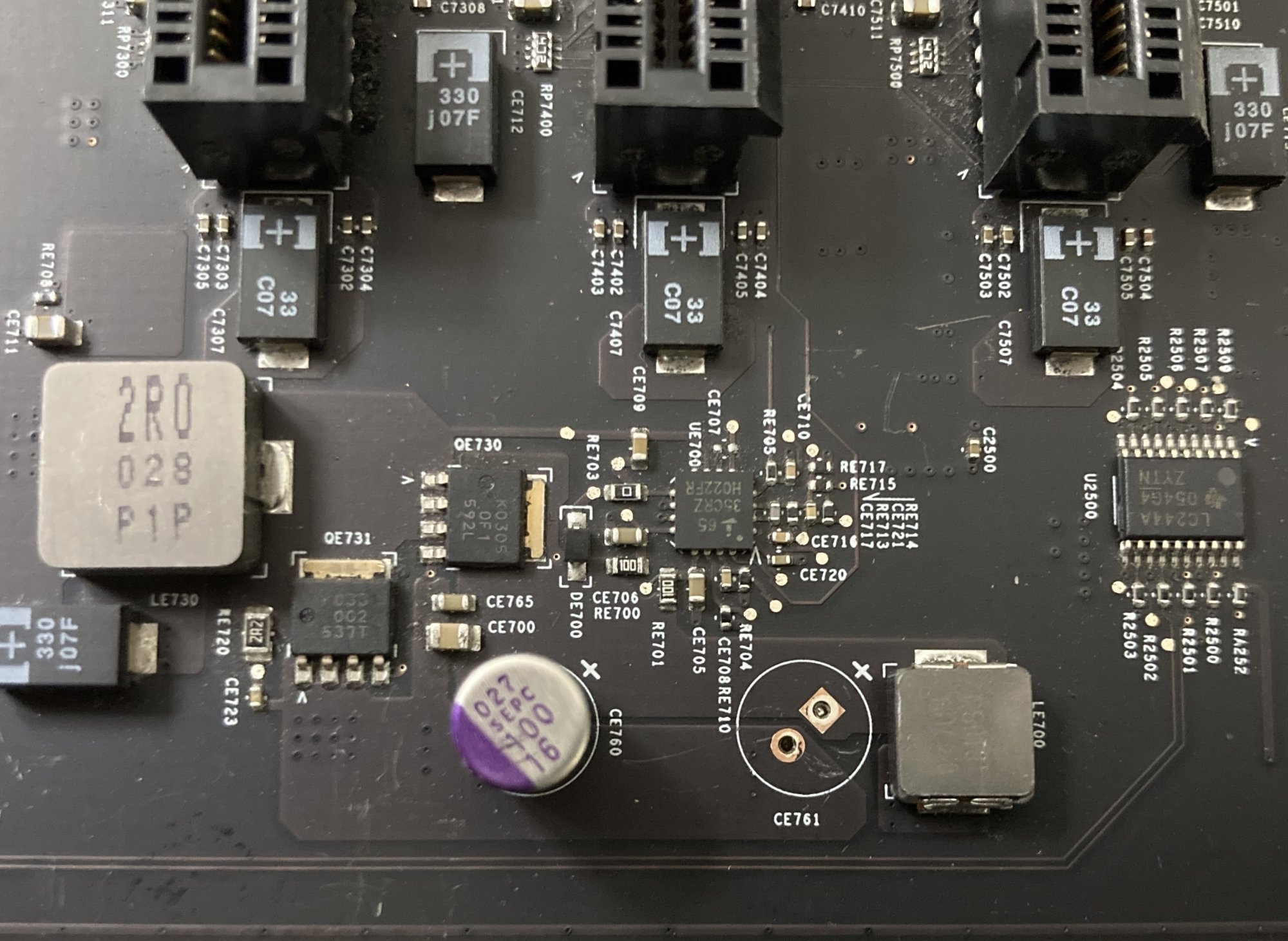

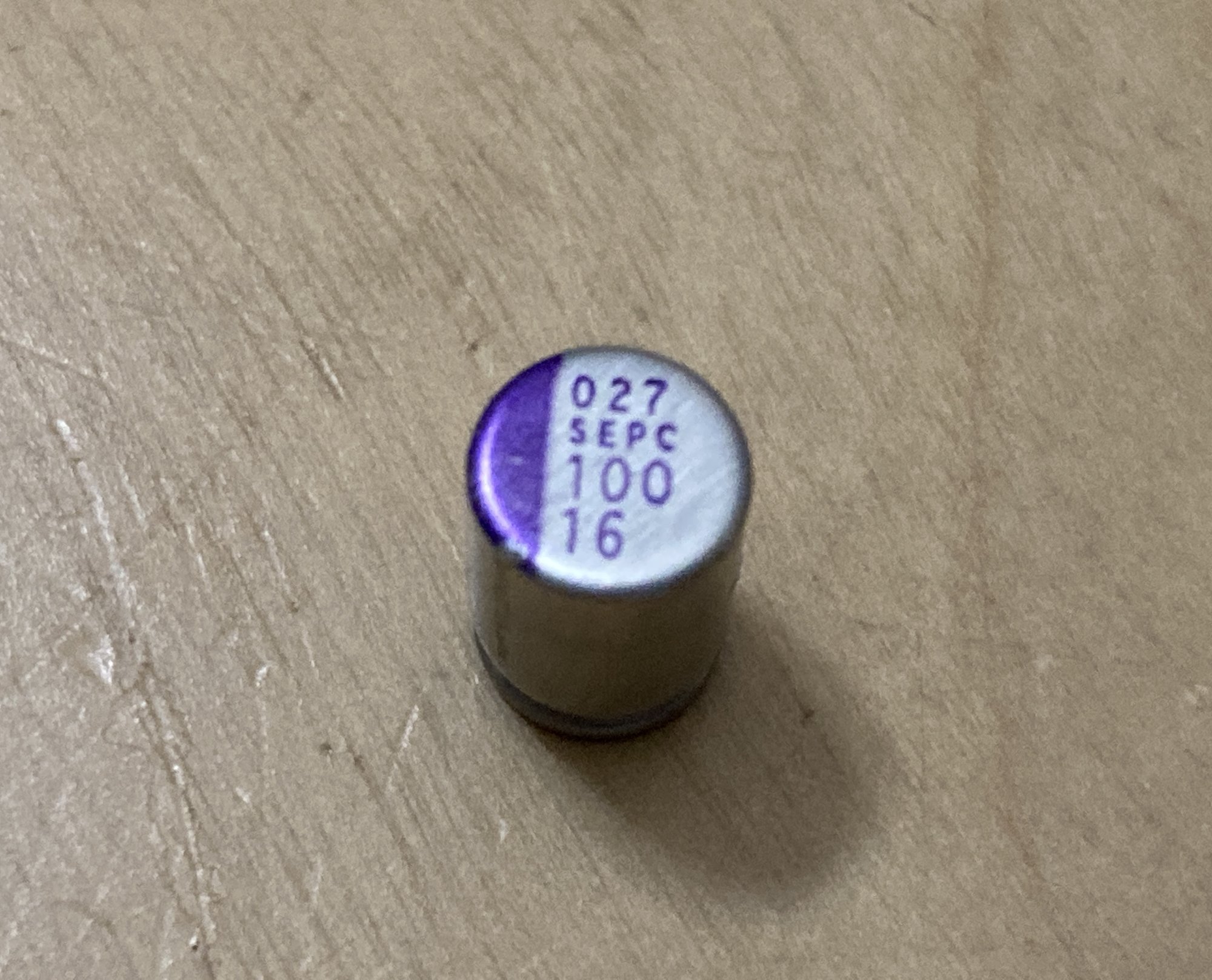

You need to buy the exactly same one, pay attention to the purple color code, I'm fairly sure that this is one is a 100uF 16V OS-CON Panasonic Aluminum Polymer low ESR cap, you should find it on Digikey/Mouser/Farnell.

Yeah, going to try that when I get home. I'm also going to inspect the boards for any other caps that may be missing.

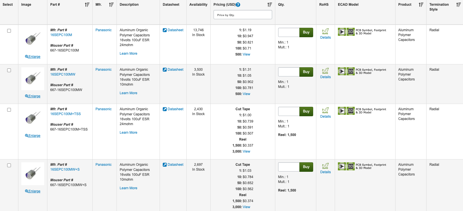

I have it down to four options and I'm not sure exactly which one it would be.

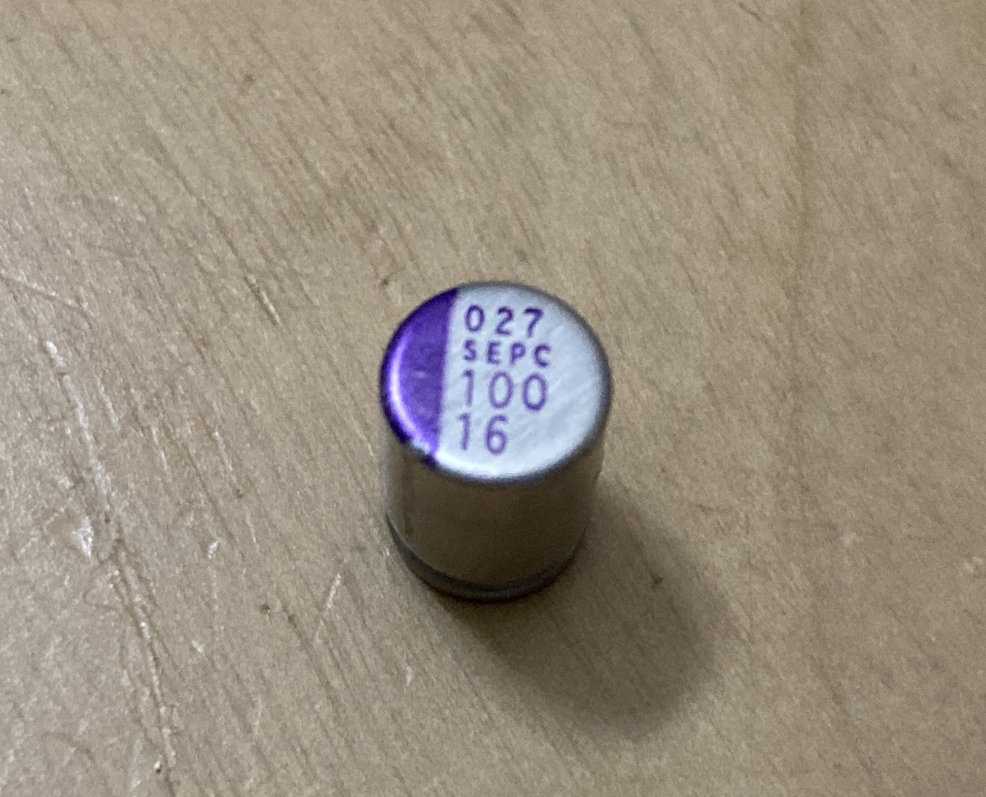

The measured height of my cap aligns with the 9mm version, so that would make it the 10 mOhms flavor as well I presume.
Capacitor Link
You can always confirm the ESR from the identical right by the damaged one to be 100% sure - unfortunately I can't check it for you right now, but I can confirm it in a week or two. It's cheap enough to buy both the 10 and 24 mOhms versions, without thinking twice.

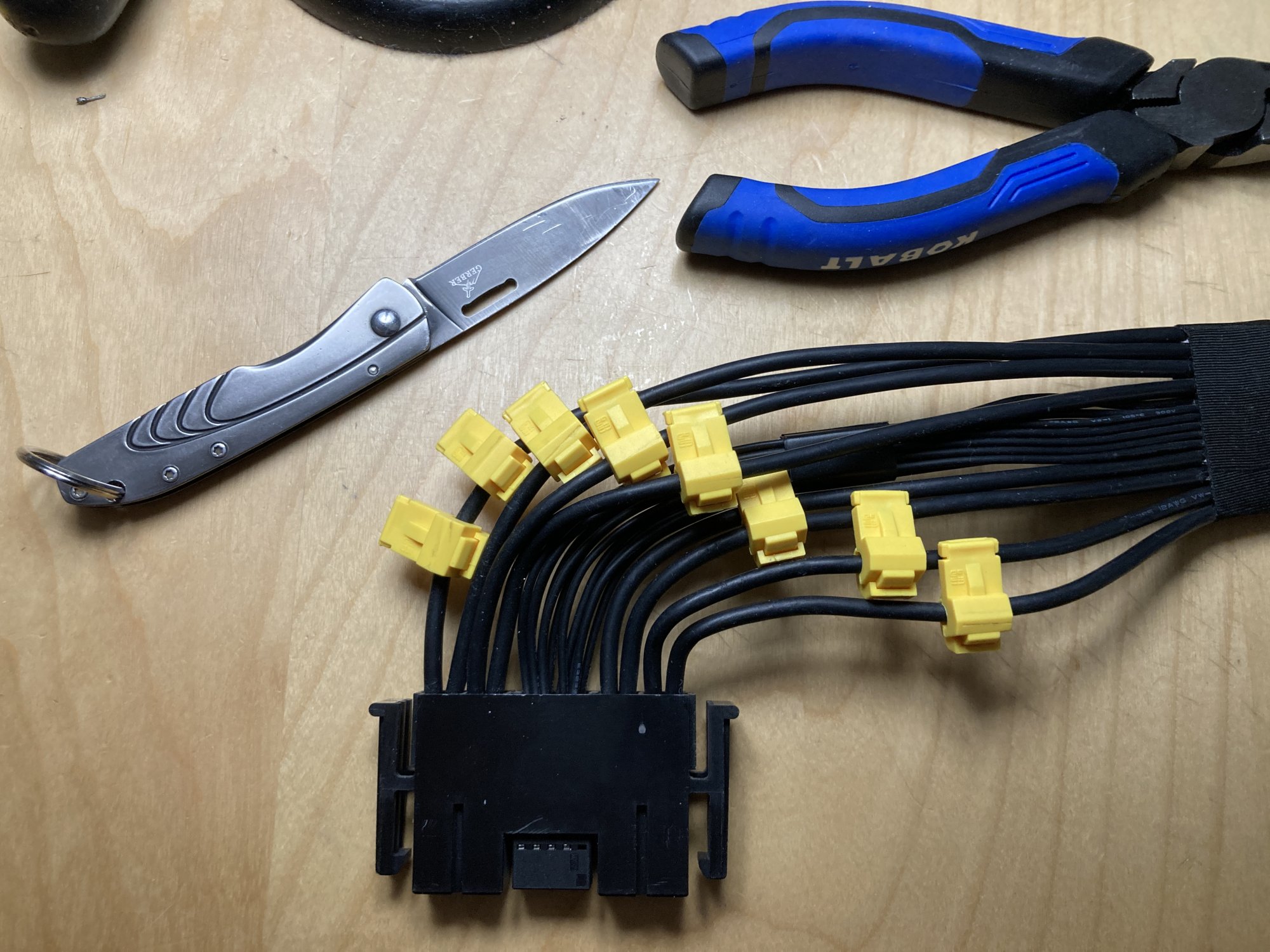

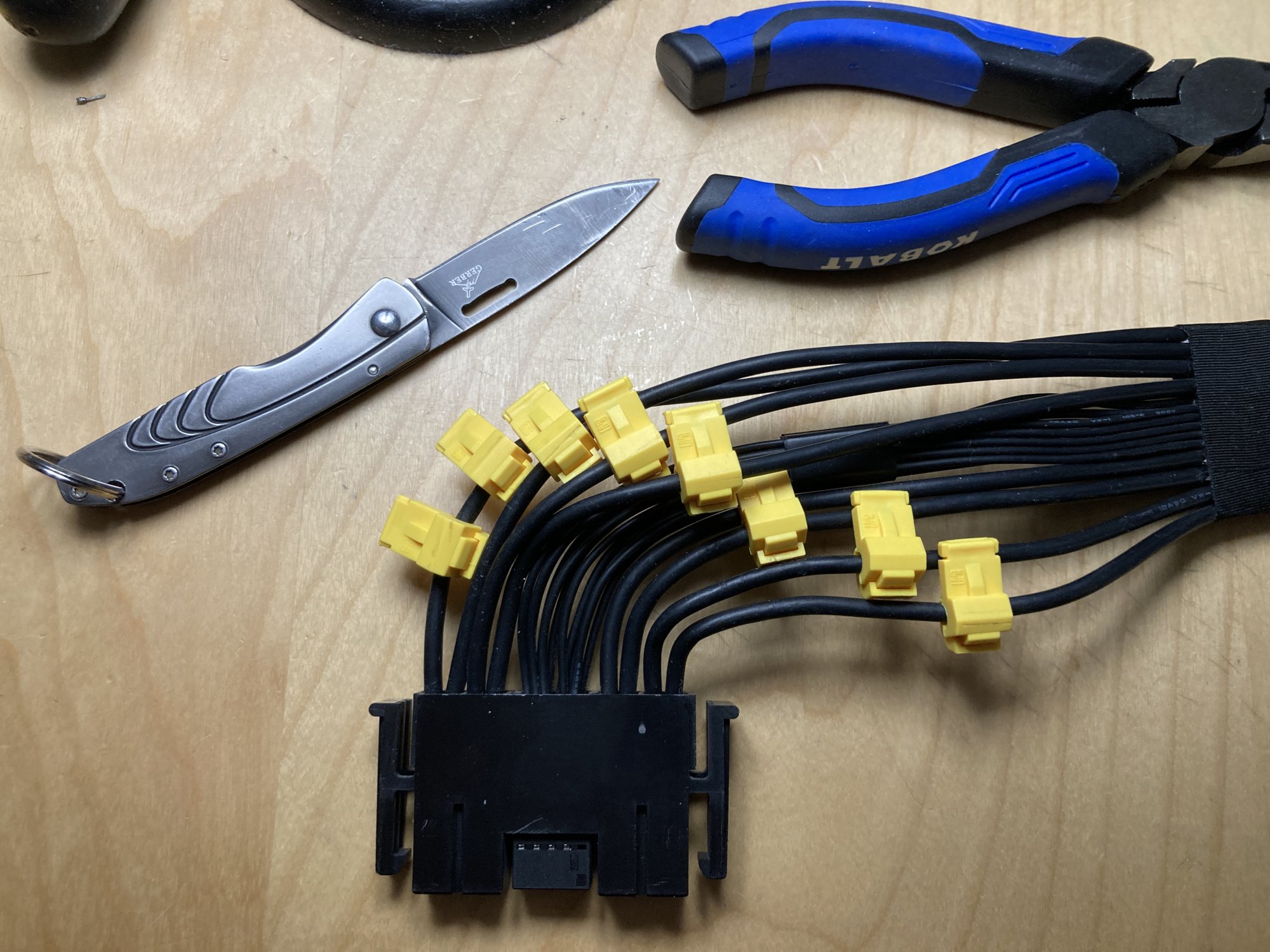

Decided to go ahead and do the Pixlas mod at the same time to avoid taking things apart twice. I know it's not the logical way to go about it as doing one repair/modification at a time to verify the first is okay before moving on to the second is the wise way. Headed to work though so this is where I have to leave it for now.
Well, the new capacitor is installed and the Pixlas mod is completed. The computer works normally, and is still locking up when playing PUBG. Oh well, AVX seems to be the likely culprit. I will likely utilize this Mac Pro for my day-to-day use and home server functions, then build a dedicated computer for Windows gaming. :|

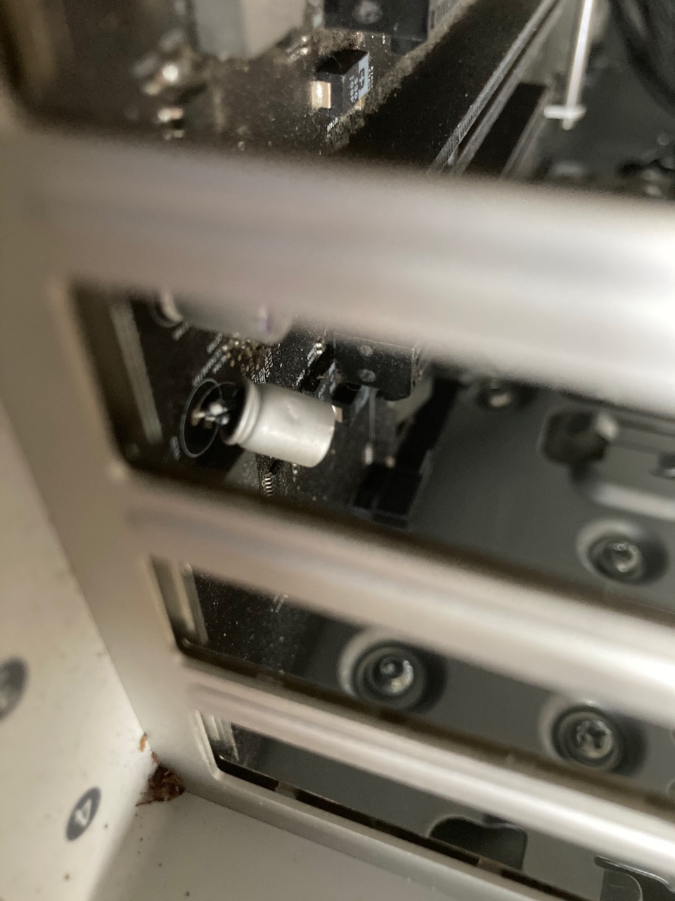

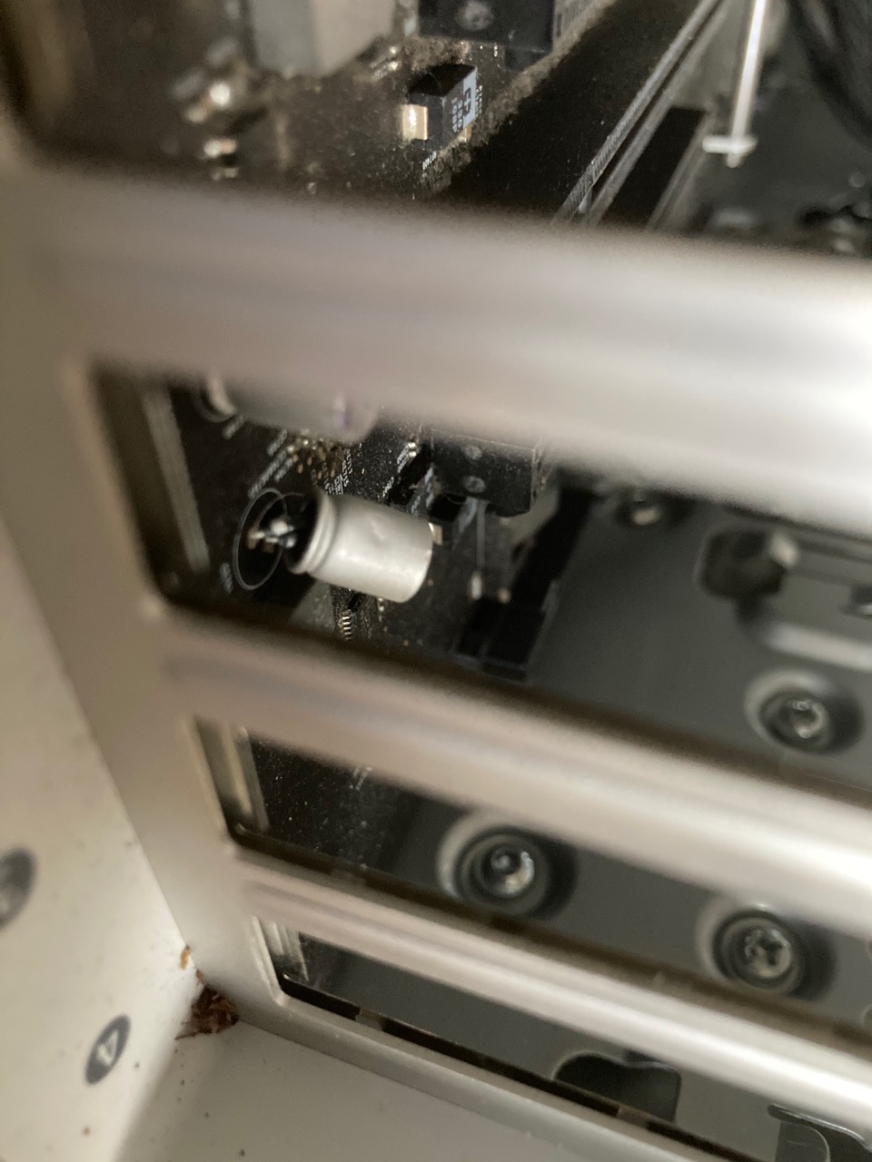

Just thought I would add to this.
While manhandling a PCI card a year or so back, I very nearly broke the same cap in my 2010 cMP. In fact I'm not sure it isn't broken.
I ordered a replacement cap that is very close or the same as original, however due to caution I have not actually done the operation, as everything seems to work fine. It happened 1.5 years ago. Although I have had 'problems' inasmuch as I often get poor transfer speeds between PCI installed storage devices, as posted here previously....who knows perhaps that is caused by this cap? Photo below...do others think it has lost functionality ie is broken? Very hard to see.
Also, for the record, GTAV works fine for me on Windows 7 on this cMP, no missing CPU instruction set problems, tho I have had that with another game Squad: for which they eventually issued a fix/workaround; fine now.
I'm pretty sure that cap is at least not up to spec anymore. And given its location the problems with your PCI bus could come from this. Replacing it shouldn't be too hard. It really depends on if the transfer speed problems bother you a lot. 🙂
Hmm, maybe I'll try GTA V again. Thanks for the info. Yeah, I would have to fix that cap! But that being said, I had no issues running without it for a couple of weeks. For all I know the cap was missing from the board for years. (I just bought the cMP recently)
