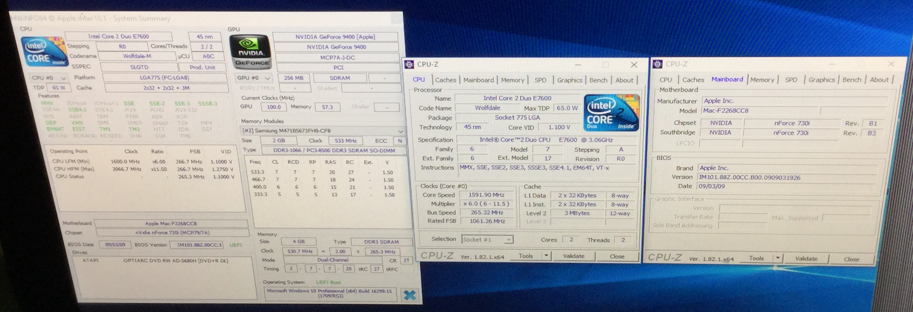

Well, then we are on the same page.
Right now my 10,1 it's all functional BUT
1. I can't restart in the normal way, every time i turn it off I have to enter rEFIt to boot to EFI Shell and let startup.nsh run to get to the system.
2. I'm not able to control the brightness of the screen in any way. (I guess there's a way to enable it on EFI Shell but I'm not able to. I would really appretiate if someone could help. :D)
UPTADE: I was able to get the screen brightness to 100% on Windows 10!!! It's really silly and I don't know why. For some reason, if you suspend the computer on windows 10 wait some time and move and click the mouse to make it wake up, the screen comes back in 100% brightness. (For me it's better than 0%)
