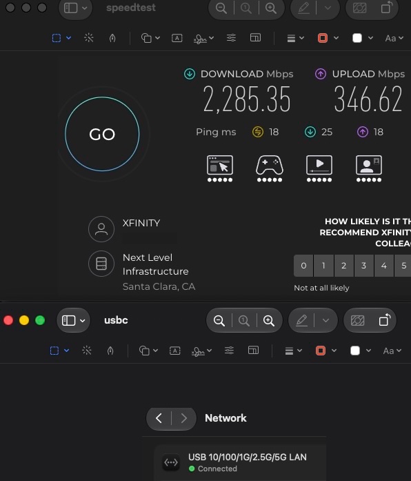

I have UGREEN USB-C 2.5gb ethernet adapter connected to Mac mini4 via 2.5gb network hub, Xfinity 2gb/350 plan.
