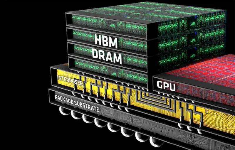

While HBM is essentially stacked DDR, it's a bit like saying LPDDR is just modified DDR (EDIT: to be more clear I am saying both HBM and LPDDR are independently derived DRAM from standard DDR). Like with LPDDR, HBM uses lower clocks and shorter wires to transmit data in bulk over smaller distances with less power. For HBM in particular the stacking + packaging allows the stack to communicate over much shorter distances using much less power. This is also mentioned in the embedded article you and I both linked to:
“HBM has not just superior bandwidth, but also power consumption because the distances are small,” said David Kanter, executive director of MLCommons, an artificial intelligence engineering consortium that, among other things, develops industry benchmarks for AI hardware. “The central weakness is that it requires advanced packaging which is currently limiting supply and also adding cost. “But HBM will almost certainly always have a place.”
For some numbers:
On the low power slide they mention the per pin clock and power for the original HBM is roughly half the power per pin of the then contemporary DDR4. Unfortunately they don't have the numbers for LPDDR4. This isn't the only determinate of power efficiency (after all GDDR ain't exactly efficient), but it is a major source of it.
Further as my link in the previous post mentions one of the primary power consumptions is the bus itself - once those are equivalent, they have the same 1024bit width, you are now measuring the difference between LPDDR and HBM which are both using wide, low power designs but one achieves it with even shorter distances because of the 3D stacking while the other requires powering 16 modules with many more total RAM packages, while HBM is just powering a single, much smaller stack of memory packages for that same bus.

Here from Semi-analysis likewise claims that LPDDR cannot challenge HBM in power per bit:
In accelerators, LPDDR has emerged as the best option for a “2nd tier” of memory that provides cheaper capacity at a lower (slower) level than expensive HBM. It falls short in building highest capacities and in reliability features, but beats DDR5 DIMMs as it consumes an order of magnitude less energy per bit of throughput. LPDDR5X packaging goes up to 480GB available on the Nvidia Grace processor, which is about 10x the capacity limit for GDDR configurations (which are limited by rules of circuit board layout and chip packaging required to meet signal in consumer gaming systems), and in the same range as medium DDR server configurations. Larger capacity DDR5 is possible using R-DIMMS of size above 128GB, albeit costly due to packaging complexity and the additional Registers (a kind of buffer chip) on the DIMMs.
LPDDR5X has a large advantage in power consumption vs. DDR and in cost vs. HBM, but the energy per bit cannot challenge HBM and it requires many lanes (connections to the CPU) which crowd board layouts at larger capacities. It also has a weak story on error correction (ECC) which becomes more important at larger capacities as there is greater chance of an error. To compensate, some capacity must be diverted to support extra ECC. For example, the Grace CPU has 512GB of LPDDR5x per compute tray but seems to reserve 32GB for reliability features, leaving 480GB available for use.
Then there is HBM3E (High Bandwidth Memory gen. 3, with an enhanced “E” version). It prioritizes bandwidth and power efficiency but is very expensive. The 2 defining characteristics of HBM are the much wider bus width and the vertically stacked memory die. Individual HBM die have 256 bits each of I/O, 16x more than LPDDR which has a bus width of only 16 bits per chip. Dies are vertically stacked, typically 8 or more, with I/O grouped for every 4 dies; in total the package can deliver 1024 bits of bandwidth. In HBM4 this will double to 2048 bits. To make the most of HBM it is best co-packaged next to the compute engine to reduce latency and energy per bit. To expand capacity while maintaining a short connection to compute, more dies must be added to the stack.
If nothing else, vertically stacking HBM will mean less distance for traces on the motherboard / SOC to link it to the processor, and power will be saved purely due to that.
EDIT: Isn't the distance from the RAM to the CPU with well-positioned LPDDR just as small or smaller than it would be with well-positioned HBM?
I'm not sure about vertically stacked HBM ... HBM is vertically stacked already. And remember even if it is low power it still has to be cooled. There is also 3DRAM, but that's different from what we're talking about (that's changing the way DRAM works). So I'm not sure what is meant by vertically stacked HBM.
Stacking LPDDR onto the A-series processor is all well and good but you can't have high bandwidth as the density isn't big enough (as the semianalysis article states LPDDR is one of the least dense of the various DRAMs) and well ... heat. That's why it works for the phone, not so much for the M-series processors. And I think there was even a report that said Apple was going to stop doing that, move to more M-series-style packaging. Also, I think the stacking of the LPDDR memory on top of the A-series processors was primarily for space reasons, I'm not sure how much power it saved.
So let's reverse my question from earlier, why use HBM at all if it is so expensive and the bandwidth gains seemingly so minor? In addition to my suspicion that HBM is slightly more power efficient at those bandwidths it is because I've left out a really important detail - space. To fill a 1024bit bus with LPDDR5X modules requires 16 such modules - that not only takes up a lot of room, but even worse, just like the minimum HBM stack size is no use for smaller chips, the minimum LPDDR5X module with full bandwidth I believe is 6GB. (I believe 2GB modules are offered but at reduced bandwidth, single data package/rank, while the minimum Apple offers at the max bandwidth is 6GB and I think that is indeed it). Let's assume it is 6GB. That means in order to provide 1.08TB/s of bandwidth from LPDDR5x you would have to have a minimum of 96GB of RAM from 16 modules. HBM3e can provide that level of bandwidth in a single stack of 24GB. That's the HBM advantage and why people build with it.
So you can in theory build an LPDDR system with as much bandwidth as an HBM3e system, as long as you are willing to provide that much more base RAM and pay the cost in package size. So in theory if Apple wanted to provide 5TB/s (matching Grace Hopper but Blackwell) levels of bandwidth - the system would have to have a minimum 480GB of LPDDR RAM - this isn't completely crazy as Grace Hopper in fact comes with that amount of LPDDR memory on top of the 100+GB of HBM3/e memory (Nvidia uses a smaller LPDDR bus size since it is feeding the CPU, it doesn't need that level of bandwidth, GH's CPU bandwidth is 500GB/s as opposed to 5TB/s). However, as per my arguments in the rest of the thread, I'm not sure Apple will be building an individual chip quite that size to be honest and I'm not sure how you would distribute that over interconnects or even what Apple's interconnect speed will be. Also, how $costs compare at that point to just using HBM I'm not sure and might depend on whether or not you are measuring $/GB or $/TB/s. My suspicion is that LPDDR would be much better in $/GB but worse in $/TB/s. Further, I'm not sure if there are limits to how many LPDDR modules/HBM stacks are possible in a single system or if the limit is just space and money.
