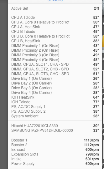

Hey everyone,
I have a 2009 Mac Pro with dual de-lidded x5690's. I installed them using a single line of arctic silver 5. Everything runs fine, however, my temps during normal usage (i.e. browsing the web) stay around 55c on CPU A and about 45c on CPU B. Anyone else have this setup running at these temps? Think I should reapply the arctic silver using a different method?
Thanks,
Matt

[doublepost=1463753755][/doublepost]So, I ran a 30 min geek bench stress test. CPU A got up 90c while CPU B topped at about 84c, what bothers me is the fan never went above 1600rpm. IOH stayed level throughout so no problems there. Any thoughts anyone?

That seems a bit high to me. The temperature usually stay at around 85C. Not sure if the dual processor model will allow the CPU temperature to go up for another 5C. Anyway, the 85 is observed from my W3690, since the X5690's temperature is 10C higher than my W3690. May be the system automatically adjust for that and allow the CPU run few degree warmer and keep the fan as low as possible. (This is normal, the SMC will try to keep the Mac Pro as quiet as possible, but just maintain the CPU at a temperature that not overheat)
Anyway, as long as it's stable, there is not much to worry about, the Intel XEON are very reliable. They will throttle themselves if require.
On the other hand, If you want better cooling, you may install the fan control software and setup your own fan profile.

Can anyone tell me why my fans didn't ramp up when temps reached 90c?
My personal guess, most likely the Mac is working backward from the "processor hot" temperature, it will try to keep your CPU around 10C away from it, regardless what's the actual temeorature.
As long as your processor is not that close to overheat, the fan stay idle to keep the quietness.
