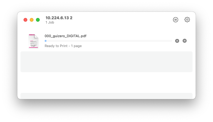

Well, I'll need some more help If you can.

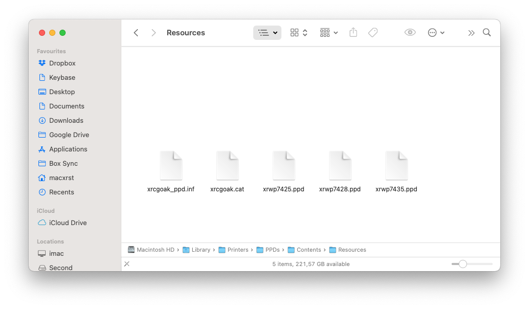

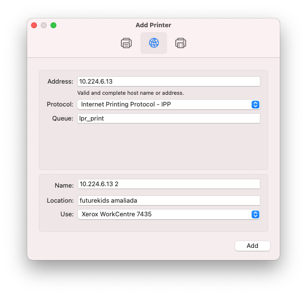

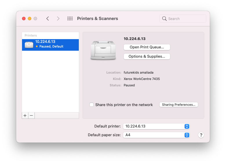

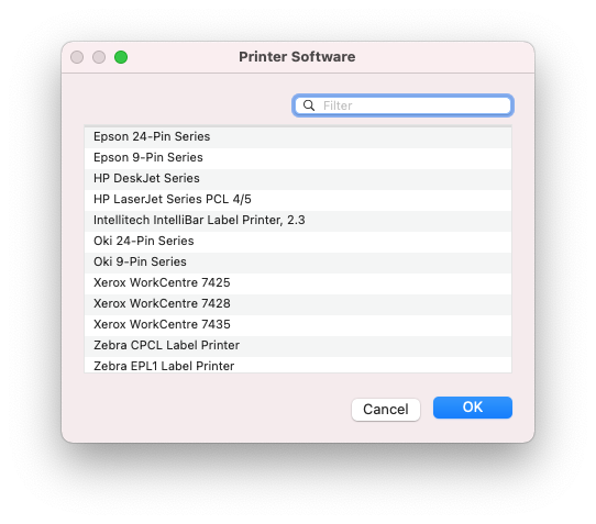

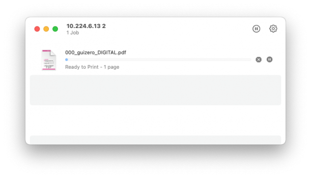

I'm doing what (I understand) you said, seems the printer added, but when I'm trying to print, the print job stops and the printer seems paused. I'm adding some photos so, you can have a better understanding what I'm doing.

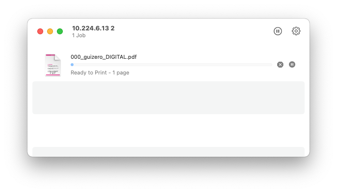

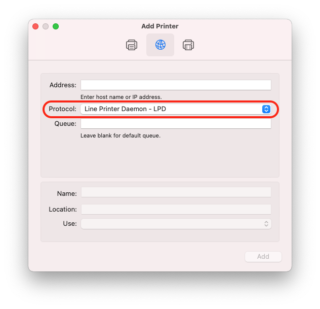

I finally made it ! 😎
The problem was the protocol I was choosing. It needs LDP instead of IPP. I'm leaving this in a screenshot for future reference if anyone needs the same infos.
Thank you again for your valuable help.
