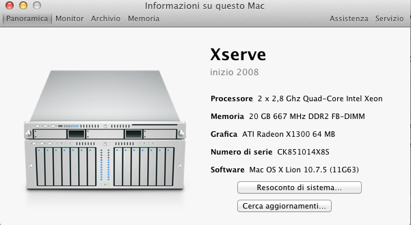

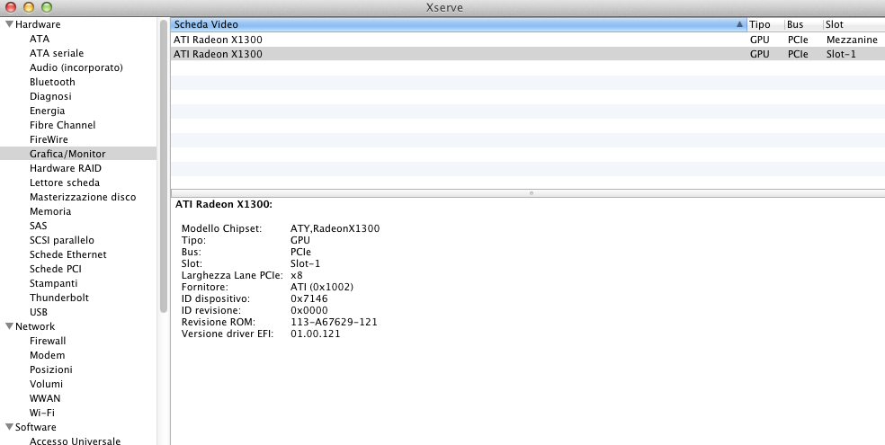

Hello, i'm new.... thanks for the interesting posts, I recently bought an xeon xeon xeon core with 10.7.5 and an integrated x1300 mezzanine, and I added another PCIe ATI x1300 video card, the card is loaded correctly, but nothing appears on the monitor in any of the VGA or DVI outputs, even after the OS is fully loaded ..
could someone help me to understand what must be done to make these two cards work together?
Thank you

The first question is which OS version are you using? Second question is why on Earth would you waste a PCIe slot on another X1300? I'm pretty sure support for that particular ATI chipset ended around the same time the Xserve2,1 was delisted from PlatformSupport.plist, and I shudder to think what you might have paid for one. There are dozens of single-slot PCIe cards that are passively cooled, have support (mostly) built-in to the latest versions of OS X/macOS, are cheap, and will blow the X1300 out of the water, if you are ever able to actually get it to work. Try any fanless GT 610 - 630 or GT 710 - 730 for under $50, and as long as you can live without the boot screen (you'll still have the X1300 for that) you'll be much happier.
HI Jamall, nice to meet you , as written in the post I installed 10.7.5, I used a second x1300 because they gave it to me free, and since it's free I do not see why not use it .. the card, as you can see from the attached images is correctly recognized without errors, but I do not have video output, can you help me? What can I check in the PlatformSupport.plist? my xserve is used in a recording studio, I do not need graphics acceleration, I need not spend money .... Thanks
