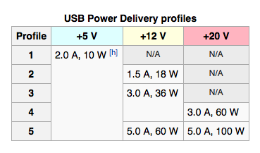

Here's a chart showing USB's different modes
