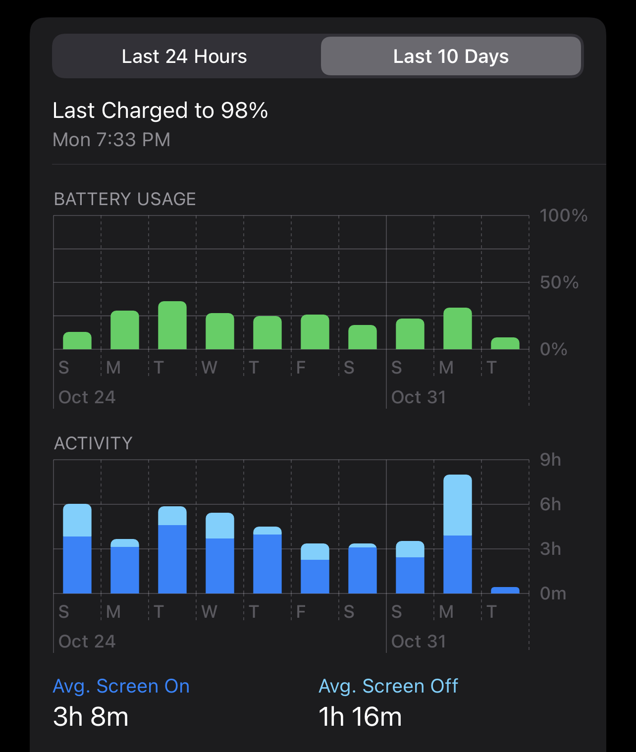

See my attached screenshot, one day I had 12 hours, but that was 6/7 background stuff so screen off. Usually most of the days before Saturday where with 50% screen off (Apple Music, Homekit activity, find my).

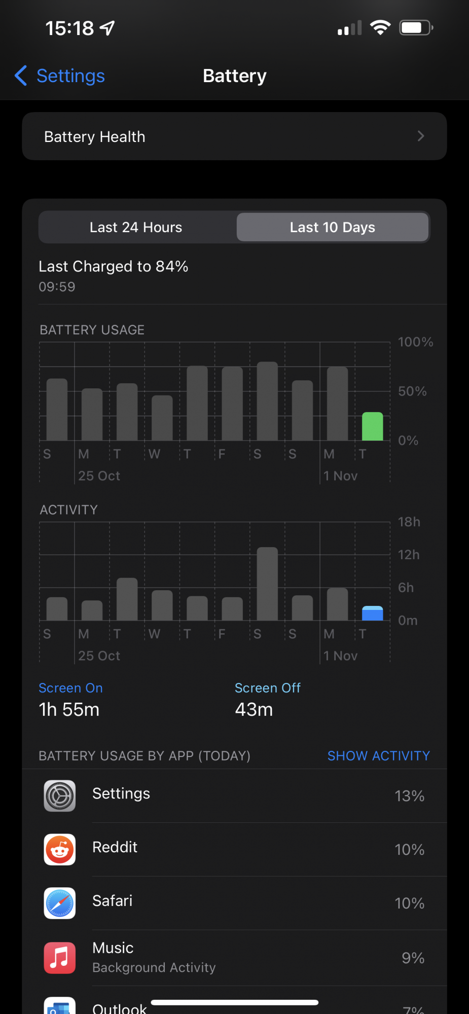

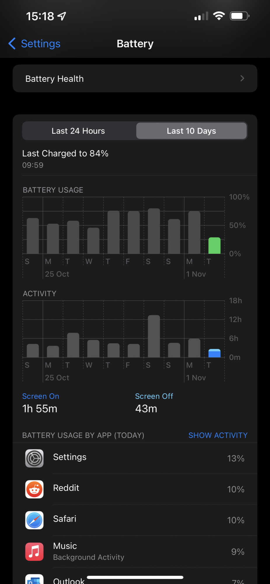

Wow that's horrible battery life above. As long as you're on wifi, cellular signal shouldn't affect you too much. I used to live in a deadline - so much so I couldn't receive/make calls - and being on wifi resulted in no abnormal drain (at least for me).
I'm a light user but here's my 13 Pro Max: (set up a new watch yesterday hence the abnormal usage there)

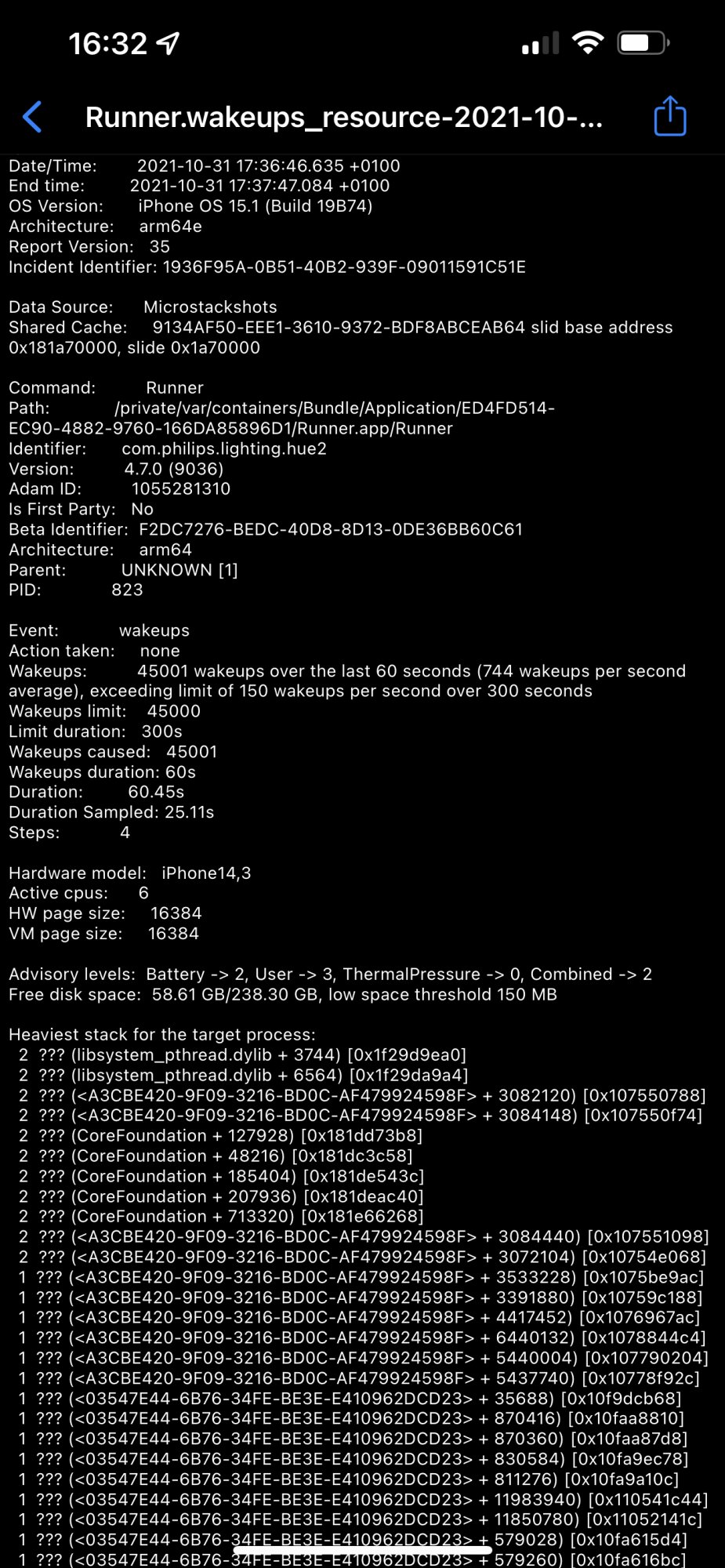

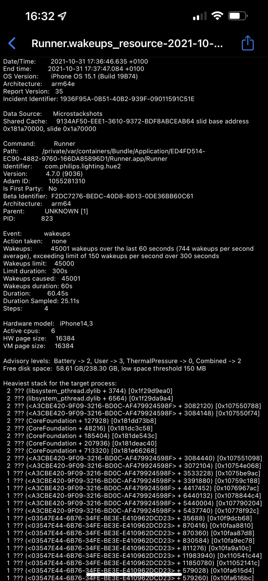

Checking the analytics logs I found a log called Runner.wakeupds_resources and apparently you only have this when this issue occurs (checked my collegues iPhone) and it happens that my Hue lights wake up my iPhone for more then 45001 times in 150 seconds (WTF), see my screenshot. Gonna unpair that crap and hopefully solved then.

Interesting. I have no logs called "Runner.wakeupds_resources." But I have several "backboardd.wakeups_resource" which show the same thing: "45001 wakeups over last 257 seconds..." Problem is all the mentioned threads and processes appear to be system/iOS processes without an obvious cause.
