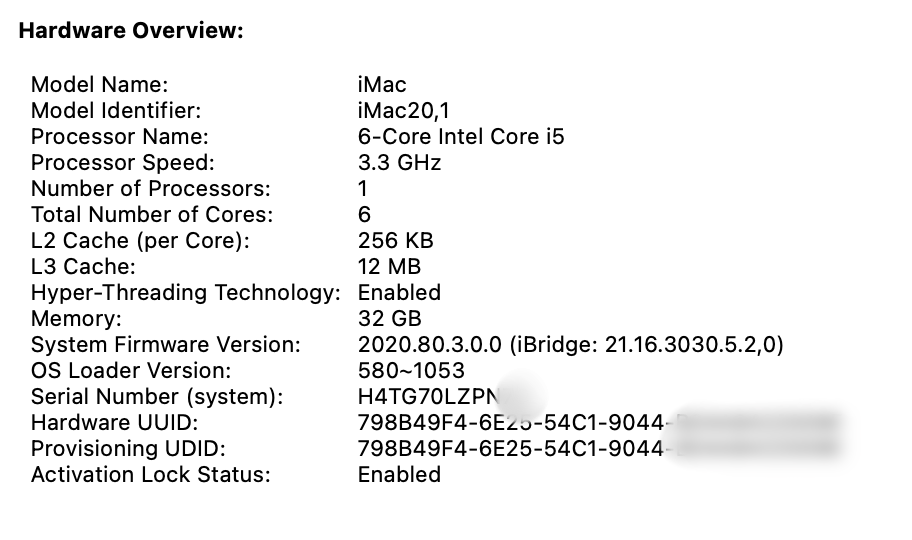

Then show off your Firmware Version in the SystemReport :)
Maybe you missed an MacOS Version and a critical Firmware Update to be compatible with these type of Ram.
Had this several Times with Mac´s.
Btw.: what MacOS are u using ?
The Other successful Users of these Crucial Ram´s could also post it to be sure.
Btw. i use Crucial Rams in many Mac´s and Hacky´s with no Problems.
If that does not help there might be a Problem with at least one of these Ram Modules leading to this....
As far as i can see you have done anything normally needet, also SystemReport shows identical charge Number...
Difference to the posted working Modules is also yours are showing much shorter info strings so what MacOS are you using ?

Firmware: 2020.80.3.0.0 (iBridge: 21.16.3030.5.2,0)
MacOS: 14.2.1
Note that Software Update has not been offering new firmware (though it's of course now pushing MacOS 14.3)
Hardware system report below

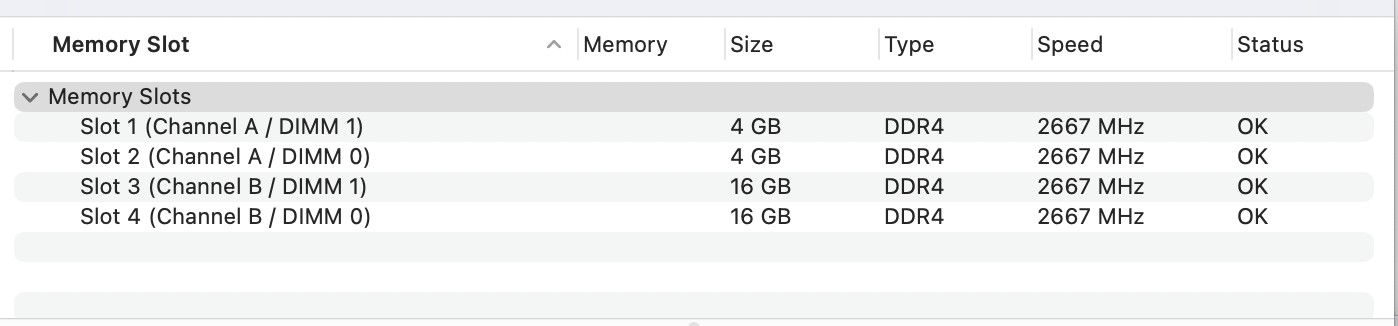

The 2020 is a little turd when it comes to RAM. OWC branded RAM won't make a difference, this was how I ended up getting mine to run them at full speed:
Apple sticks in slot 1/2, then the new sticks in 3/4.
With this arrangement, 16GB will run in dual channel mode, and the remaining 24GB will run in single channel mode (which is effectively at half speed). This is known as "flex mode" per Intel. You cannot control which part of memory is being used by a particular process.
This is likely to result in slower overall memory speed than having all RAM running in dual channel mode but at 2133 MHz.
I can report that, as someone doing no rendering or compiling, 2133 MHz in dual mode is surely as fast as you probably need. I don’t feel any latency.

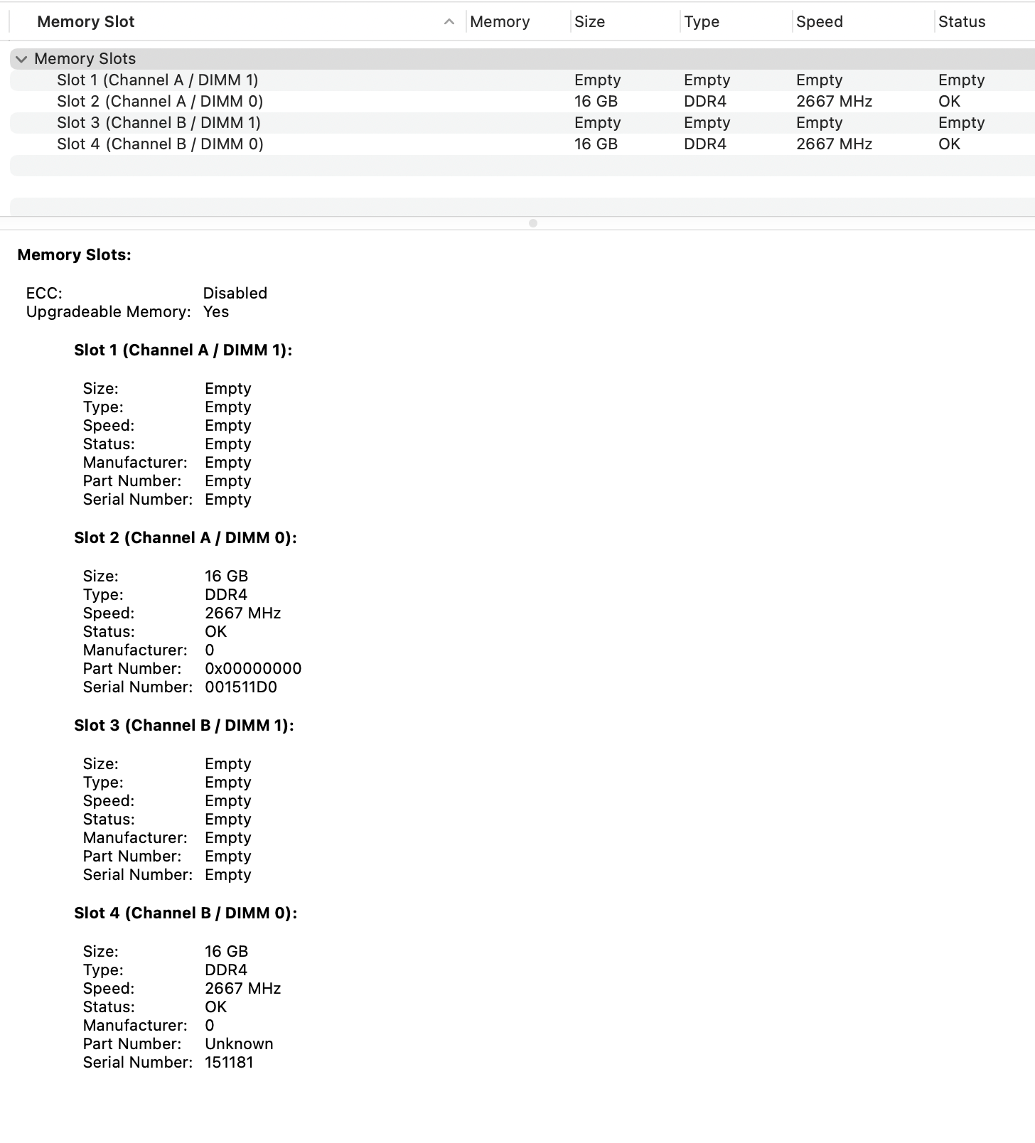

Here's a more detailed report, in case it's of interest to anyone.
FWIW, an OWC tech confirms the weird zeroed-out data for manufacturer and part number, says it all looks ok.
