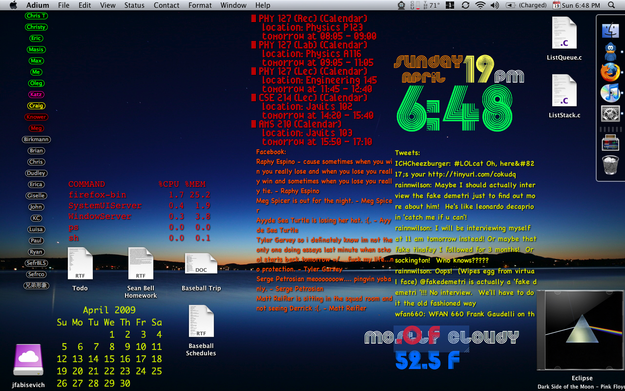

Here are my GeekTool scripts, just set up. Unfortunately the calendar I had to do manually for now, which means I'll have to update it each month (the current date is being highlighted automatically, but I'll have to swap out the monthly calendar because the cal command doesn't let me do a single line calendar).
jW
