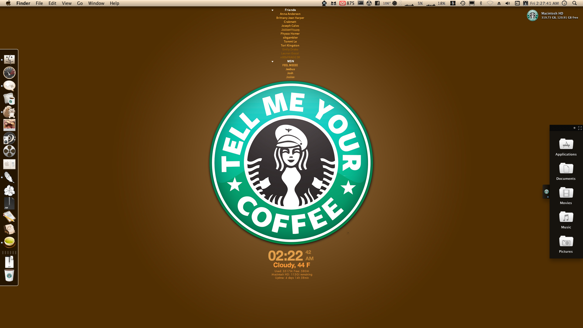

Hey guys, inspired by a picture off lifehacker, I decided to totally redo my geektool layout. Thought I'd share. I'm including the before and after. If you get a chance let me know if you think it's an improvement or not.
Also, feel free to ask for any of the scripts. In case anyone's interested, I figured out a way to make stock quotes appear in red if they gone down and green if they've gone up - but didn't include it in this screenshot.

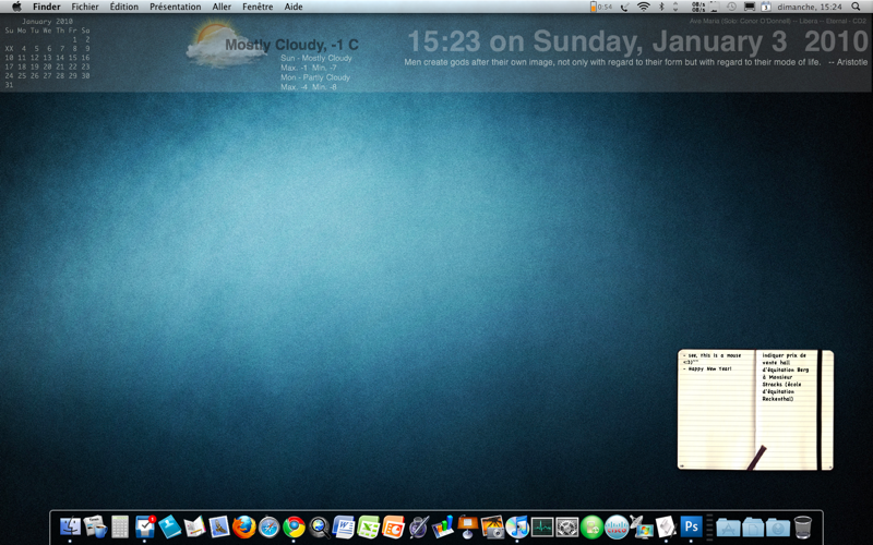

I've been trying to figure out how to fix this... It fixed itself now that it is 2010, I'm wondering if anyone has any ideas on where I may have gone wrong...
One thing thats bothering me, is there a way to center things on the desktop? Cause my OCD is eating away at my patience.
I actually cant tell if its Geektool or Adium thats not entered...

Is anyone else having the problems with the simple code for the date not recognizing that the year has changed?
Code:
date +%G
My calendar seems to be messed up. Any ideas?

Here's my new desktop for January 2010 I like the minimal look.
If you want to know how to put the month like "jan" instead of "january"
just put the code in lower case i found this out on my own.
