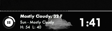

Getting the weather image is a 2 step process
The first is a shell script that grabs the image (but you see no output, it puts the image on your drive)
The second step you use the image shell to get that image and display it
Step 1
Image grab
Got to Yahoo Weather and put in your zip code
When the page loads with your weather, copy that URL
Use this code in a shell script, but past your URL instead (keep the quotes around the URL)
You won't see any output from this
Code:
curl --silent "YOUR_YAHOO_URL_ADDRESS" | grep "forecast-icon" | sed "s/.*background\:url(\'\(.*\)\')\;\ _background.*/\1/" | xargs curl --silent -o /var/tmp/weather_image.png\
Step 2
Image display
In another geeklet, use this code to display the image
Code:
file://localhost/var/tmp/weather_image.png

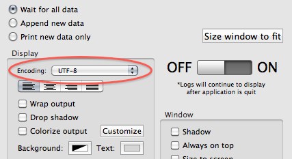

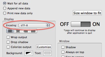

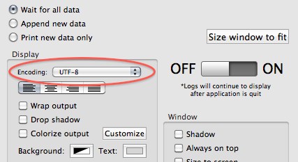

Perfect tutorial but I am having one problem. How do I get rid of the odd character between the number and degree.
Strange character before degree symbol
I took the degree symbol off of mine because I couldn't get that strange character to go away. I think it has something to do with the font, but I haven't been able to figure it out.
Try changing the text encoding from ASCII to UTF-8.
