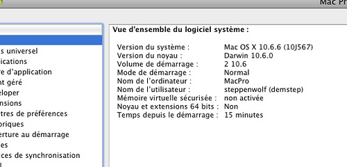

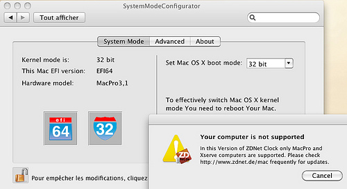

Well it seems as if this got broken somewhere along the way in snow leopard. When I first got my macpro1,1 in late December 2010 I was running snow leopard and zdclock was working fine. Just tried it now with 10.6.7 and now get the CPU unsupported message. But it was working last time I tried it which was probably February time frame. Maybe 10.6.5 or whatever was available around then? So I think it was broken at either 10.6.6 or 10.6.7.

I'll try some old realeases of snow leopard : downloading combo updates of 10.6 and applying them...
perhaps ?
I'll post my results here 😉
