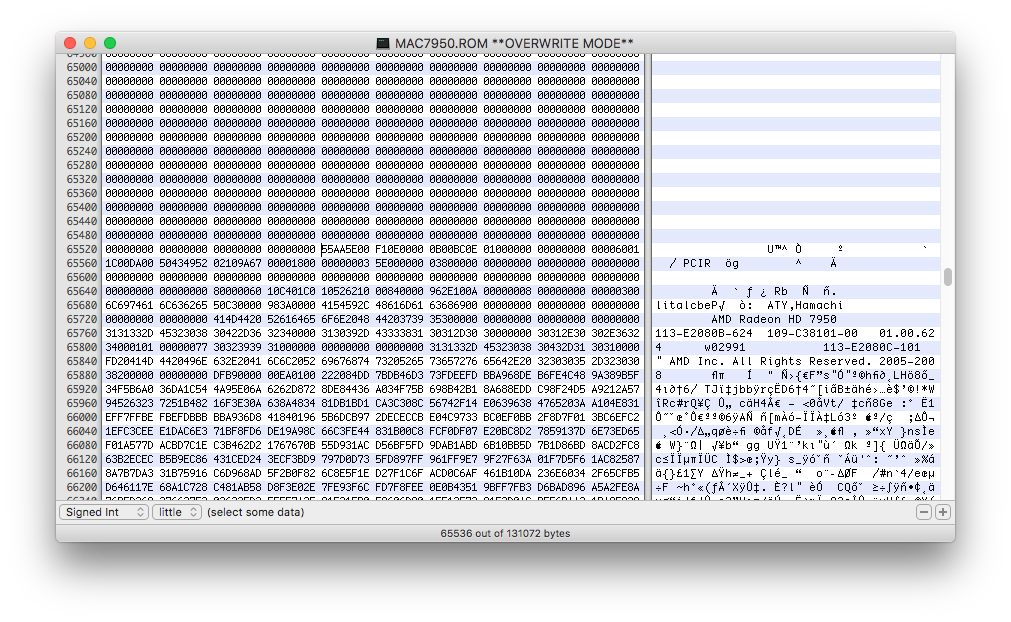

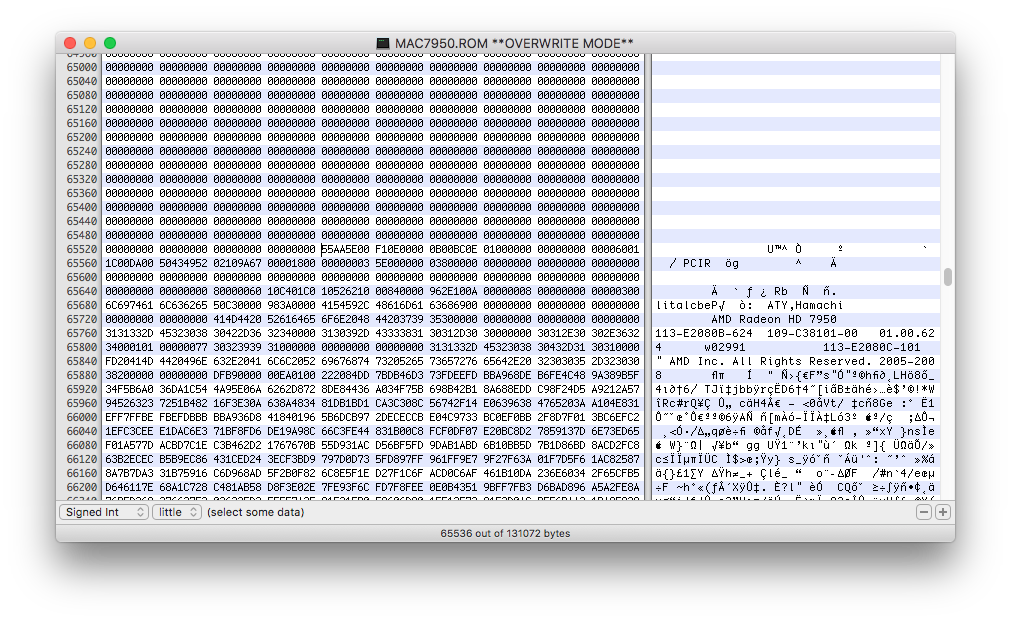

If your card has UEFI Bios, then you could only copy/paste the EFI part (Gigabyte and MSI R9s have it).
Look where i left the cursor in the screenshot (65536)
From there to the end of file you copy from MAC EFI rom and paste (from the same spot to the end) into your original BIOS (it should be the same length in the end - 131072 bytes). Anyway, you should go through the first few pages of the above topic (netkas' forum link) and everything should be a lot clearer after that.

http://forum.netkas.org/index.php/topic,5619.0.html
