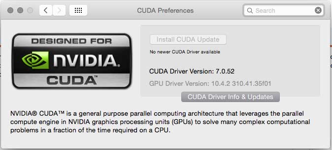

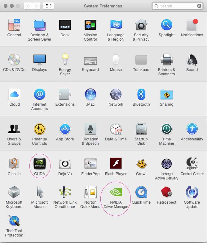

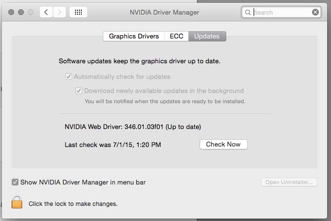

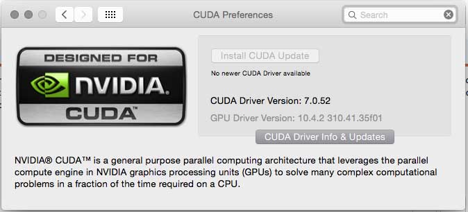

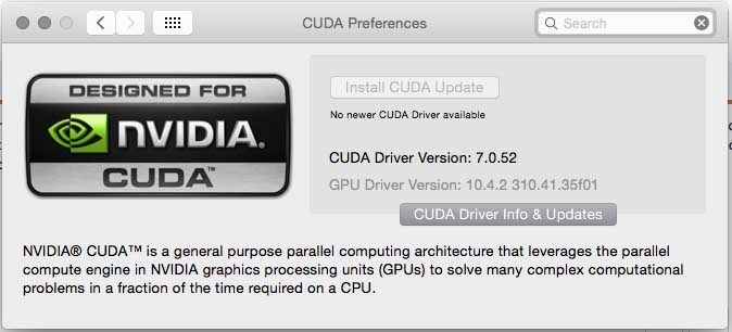

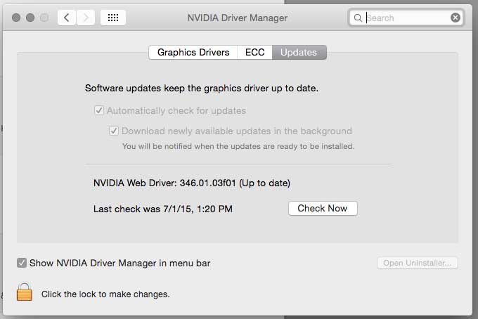

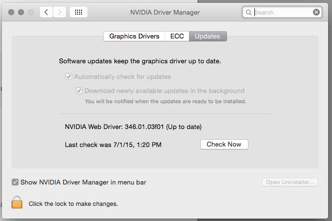

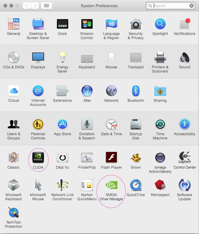

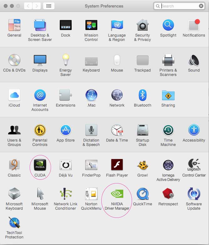

^^^^Two ways actually. Go to "Control Panel" If Cuda is installed you'll find an icon, click on that icon and you'll get the installed information for the Cuda Driver and the Nvidia Driver installed. If Cuda is not installed go to the Nvidia Driver Manager, click on it, then click on Updates on the far right (Top). The installed Nvidia Driver will be shown.
Edit - Actually, it appears that the Cuda Control Panel no longer shows the correct Nvidia Driver????? It's showing the Apple Nvidia Driver, which I know is not being used????? This is very strange, it used to work correctly?????
Lou

	^^^^Ah, just noticed your on a MacBook, so your Nvidia Graphics are of the mobil type. The Nvidia web site says that the Web Drivers only support PCIe cards in the Mac Pro. However, Cuda is supported on your machine, and the latest driver that works with your onboard video is here:
http://www.nvidia.com/object/macosx-cuda-6.5.45-driver.html
I recommend you download and install it. After installation follow the steps I outlined above, and you'll see the Apple Nvidia driver you have installed on your machine.
Sorry for the misunderstanding.
Lou

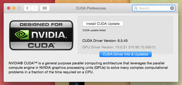

Ok so i installed CUDA and it said there was a CUDA update. I clicked on install CUDA Update and it fully downloads and get 75% thru the install and then it fails... see below. wtf do i do now. haha. is there a way to update the drivers any way else to see if the driver version i have now is up to date
There is an update (Cuda 7.0.52) but it is not for your card, it's for newer cards. I'm attaching the link:
http://www.nvidia.com/object/macosx-cuda-7.0.52-driver.html
I gave you the link for 6.5.45 because it's the latest Cuda Driver that is designed to work with your card.
Lou
