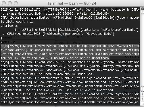

This could be relevant to the broken QuickLook:
Reactions: ChrisCharman

Will be due to naming convention differences between 10A190/10.6.8 and 10.5.8 Frameworks. Is this on the mainline image(s) or only the custom reverted 10A190 and 10.6.8 Framework version?
This is on the image with updated frameworks from 10a190 (“Nvidia” one).
I can try it on the generic one tomorrow.
