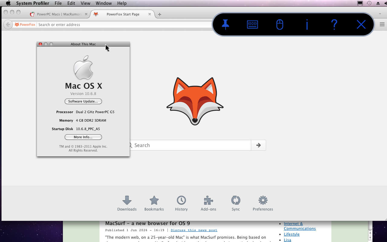

Booted with shift key at Apple logo (safe mode). System initially booted into mode too high for my monitor but I copied display overrides from working 10.5.8 system to 10.6.8 like described here
and it booted (again, in safe mode) so I finished set up, and logged in!
Set Screen sharing to ON, network and sound and GPU all seems to be working on first sight.
Oh, I need to disable energy saver/sleep mode!
Ah, it already set to infinity 😉
Copied Powerfox (G5 version from my Leo partition), seems to be working.
Safari also works (I use wired internet connection).

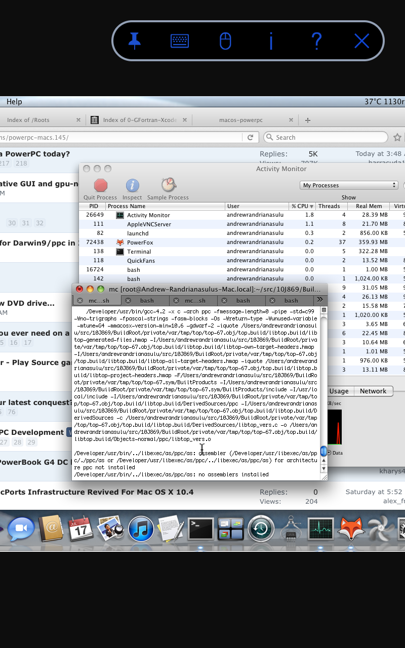

Developer Tools for 10.6.8 (developer version 😉)
Install these AFTER installing Xcode 3.2.6. They will overwrite unusable x86-only binaries.
Three [set of] components are here:
1. ld64 and its tools, ver. 97.17, which corresponds to Xcode 3.2.6. LTO is disabled.
2. Apple gnumake, ver. 3.81, same as in 10.6.8, just built for ppc.
3. cctools from darwin-xtools by Iain Sandoe (maintainer of GCC for Darwin), ver. 1.1.0. (ld64 components are dropped from here, since ld is much newer in xtools and may not be totally compatible with old Xcode gcc.)
Specifically, I installed the OS, installed standard Xcode 3.2.6, then installed these three pkgs.
Then I installed PPCPorts, synced sources, and I am able to build software (I have built several fundamental ports now). So ld, as, make and gcc work.
Notice, this does not mean that everything will work, since there are a lot of x86-only binaries which are not dealt with here (gm4, bison etc.). However, from what I can tell, this is a minimum that makes installation functional.
Archived pkgs:
Identical installers can be built from source using the following portfiles:
https://github.com/macos-powerpc/po...efd85f522897b98eddef30216/devel/darwin-xtools (use darwin-developer-tools subport)
Notice, these ports cannot be installed (as a safety measure to not overwrite binaries in /usr/bin accidentally). Use them like you use `MacPorts` port: build the installer via MacPorts, then run the installer to install the software (outside of MacPorts).
Installers are built with `sudo port pkg ${port_name}`.
DISCLAIMER: If you install these, please make sure you know what you are doing, or at least try on a clean system with no valuable data, so that you can wipe it out if something goes wrong. While I have tested this and confirmed working on a clean installation of 10.6.8, no guarantee is given whatsoever, as usual.

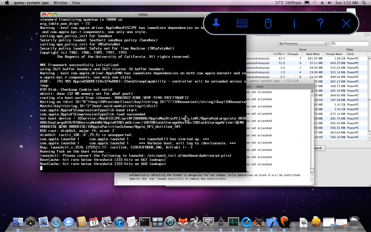

I created a raw image with qemu-img create -f raw 'diskname.img' 'size in' GB.
Then I added it to my Tiger VM and initialized it there. Shut down the VM and mounted the new disk and the 10.6.8_PPC_A5.dmg.
Then I just opened Disk Utility, selected the mounted new disk and hit 'restore', then selected the mounted '10.6.8_PPC_A5' disk as the source and hit the restore button.
That was it.
Then I start Qemu with these minimal commands...
Code:
 qemu-system-ppc    -M mac99,via=pmu   -device usb-mouse -m 2048m -hda 'path/to/the/new/img'   -prom-env 'boot-args=-v ' -cpu 7457 -boot c
I tried this on 10.6.8_A5 itself, using PPCPorts and qemu 5.1.0 (higher versions like 6.1.1 compiled on Leo with some manual patching but failed to even reach OF prompt).
Sadly -cpu 7457 apparently bugged in this version, and default (G4?) for mac99 machine does not boot restored to virtualhdd image ...
I guess 9.0+ may work better, but depending on host and compiler? I getdifferent results on OSX Leopard + gcc14/16 and Linux with gcc15 on same ppc (G5) Hardware ...
I wonder if using -shadow method from this Stackoverflow Superuser answer will keep image bootable?
I tried it on 10.6.8_a5 itself, and shadow file indeed was created. I promptly deleted it without converting back to original ...

Ah, there was fix in the end of 2021:
target/ppc: Disable software TLB for the 7450 family
(Applies to 7441, 7445, 7450, 7451, 7455, 7457, 7447 and 7447a)*We have since 2011 [1] been unable to run OpenBIOS in the 7450s and have not heard of any other software that is used with those CPUs in QEMU. A current discussion [2] shows that the 7450 software TLB is unsupported in Linux 5.15, FreeBSD 13, MacOS9, MacOSX and MorphOS3.15. With no known support in firmware or OS, this means that no code for any of the 7450 CPUs is ever ran in QEMU.Since the implementation in QEMU of the 7400 MMU is the same as the7450, except for the software TLB vs. hardware TLB search, this patch changes all 7450 cpus to the 7400 MMU model. This has the practical effect of disabling the software TLB feature while keeping other aspects of address translation working as expected.This allow us to run software on the 7450 family again.*- note that the 7448 is currently aliased in QEMU for a 7400, so it is unaffected by this change.
Something simple enough to try right away ...
edit: it was probably false alarm. Changing this mmu type for 7457 in slightly different file in qemu 5.1.0 dies not prevent black screen on boot if this cpu selected even in OF.
But plain G4 seems to boot, just .. slowly! Like 10 minutes on grey apple logo before kernel show up its messages.
I was using 1gb of virtual ram and 256 mb of translation cache - this was too muc for poor Mach, and qemu segfaulted, eating above 2.5Gb of virt memory.
Limiting mem to just 512m and default tb-size allowed Snow Leopard on emulated PPC to go further into boot.
Hopefully it boots as I write this msg.

So, not sure what helped, but after removing stale kext cache AND selecting 10.6.8_a5 as boot volume and re-applying multiboot trick
Code:
sudo nvram boot-command=multi-boot
AND removing power cord for few minutes
My machine boots fine into all 3 OSes - 10.6.8_A5, 10.5.8, Linux

While ppcports works now, I tried to set up darwinbuild and this one calls Xcode for building even small utility like 'top'
And replacing as there (in libexec) does not help, sadly it (xcodebuild) says assembler not registered?!
Do you have it working on your ppc 10.6.8_A5 machine? (I think intel may just work)
I don’t remember if I tried. Darwinbuild assumes x86, it makes sense to inject ppc where it is missing and build on official 10.6.8 with Rosetta installed. It has everything for this.
