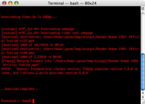

Whilst streaming 360P works ok on Tiger, downloading 1080P and adding audio returned this error:
On Leopard, I tested streaming 360P and downloading 1080P and they're fine.

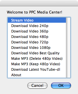

No more options have been added yet - is that correct, as the menu appears the same as before?

I’m recompiling ffmpeg right now with some additional settings. For some reason it linked liniconv from 10.5 instead of 10.4 even though I told it to not do that.
Yea no additional features yet I just want to see if I can cross compile everything from leopard.

I made sure it linked libiconv 5.0.
On Tiger streaming 360P works but it errors out with the 1080P download - nothing reported in Terminal window but I've attached the output from Console.
