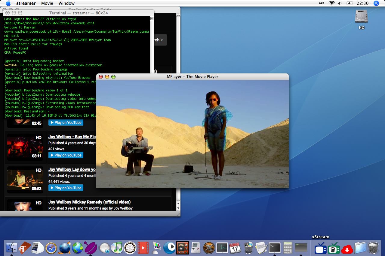

Don't forget that 3gp can be made to play in OS9.
Transcoding obviously opens up lots of possibilities but I've steered away from that in the past because addressing low end systems in the first place means any transcoding is going to be laborious.
This was the nearest I attempted:

My streamer/downloader (linked earlier in thread) or better still SMTube will do the same with less CPU but more effort is required in the install. The problem on low end systems is QuickTime.
