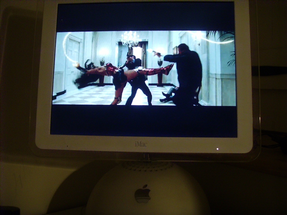

Ok, cool! It would be neat to get HD video on my 733MHz G4, but that probably won't happen xD
Should do, this is 1024 x 426 (to fit the screen exactly) MPEG4 at 1500kbps on my 800Mhz G4 iMac/OS9/Present Movie - your Powermac benchmarks higher than my iMac and has L3 cache.
