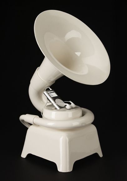

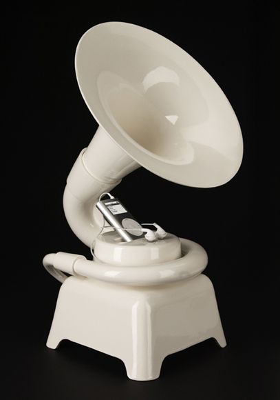

iPhone speaker.jpeg Bloody hell, didnt even know you could put an ssd in an iPod lol. You live and learn.
Unrelated, a few weeks ago i ordered this nice speaker for my own iPod classic ;-> Bloody briliant!
