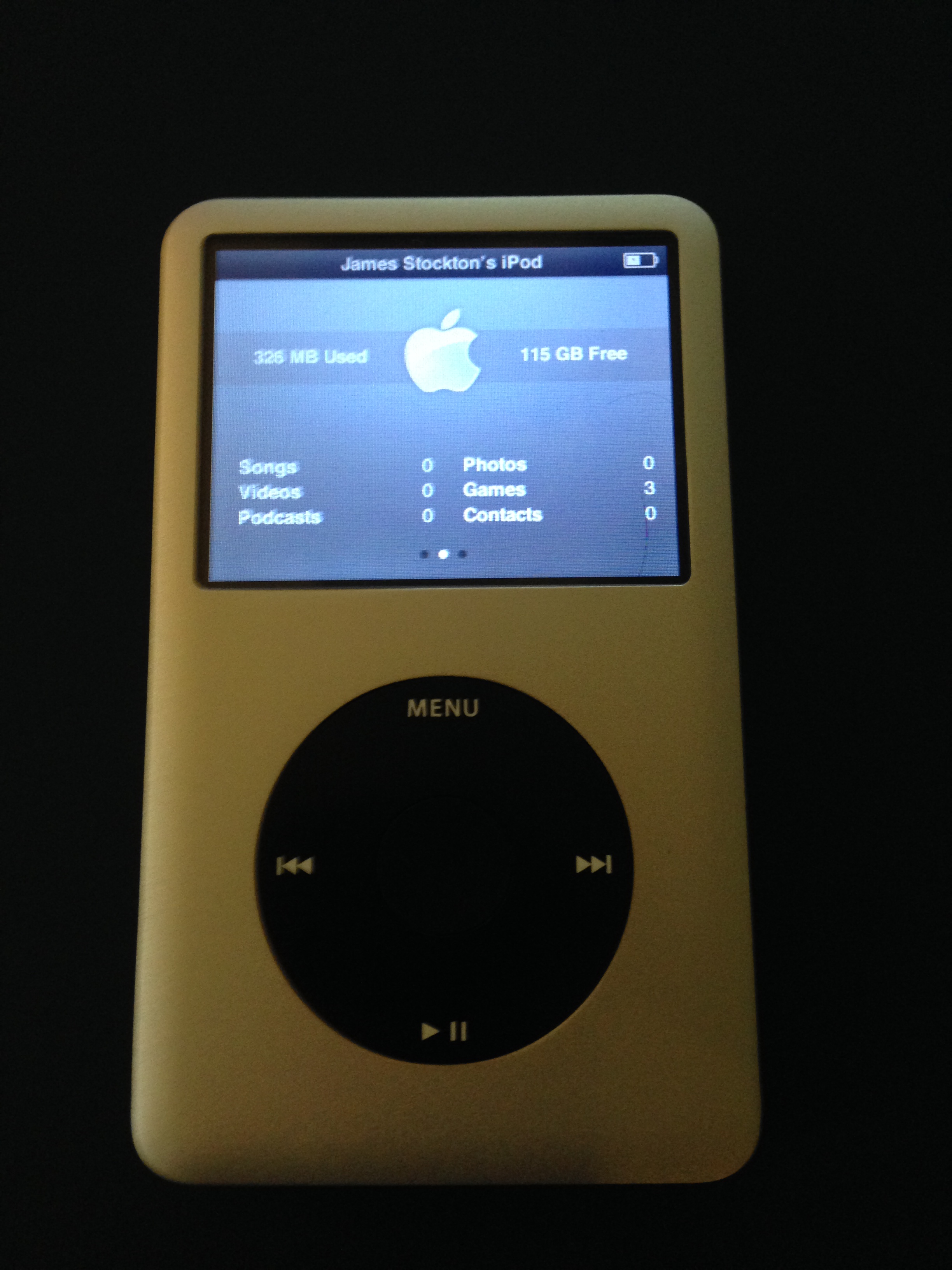

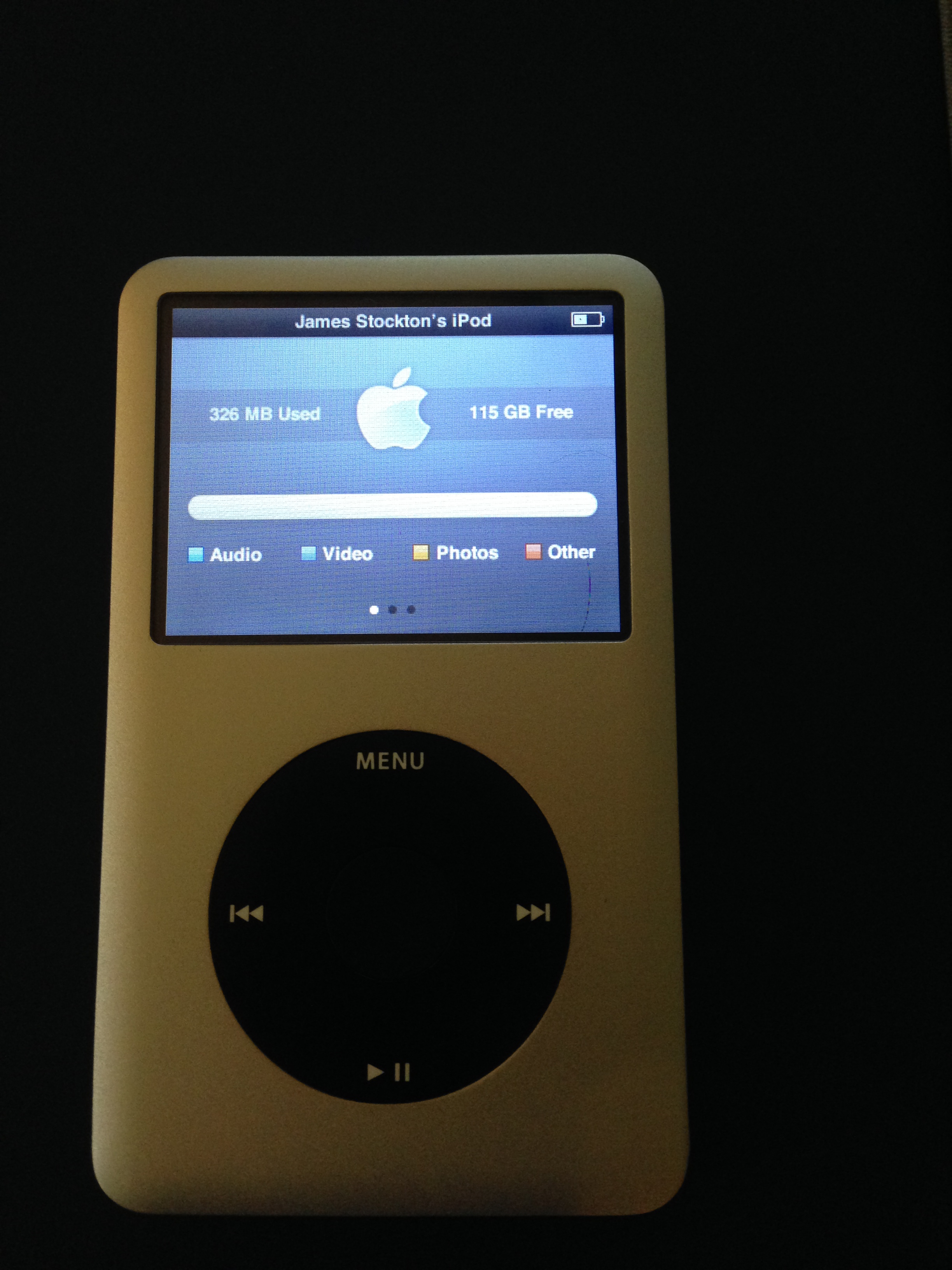

And here it is! All finished :D

Unfortunately, I wasn't as careful as I should've been and got a hair (likely from my puppy) stuck between the screen and LCD.....will probably bug the heck out of me, though not enough to go through the trouble of opening it up again! :p
Almost done loading all my music on it - not sure why only 115GB free.....probably should've done a re-format before loading music onto it but at this point, I'm still a ways off from hitting the 100GB mark for my music anyways!
Its amazing how much lighter the iPod seems with the SSD - and I'm stoked at the additional 35GB of space!
