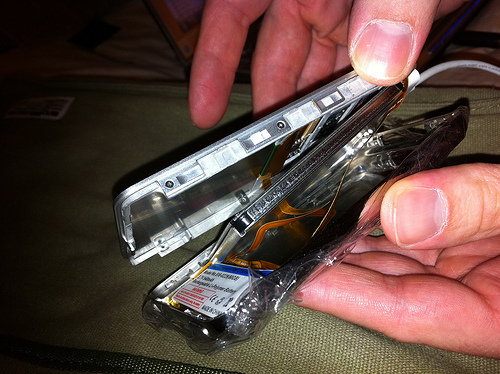

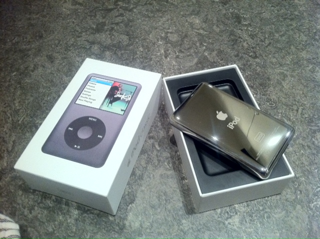

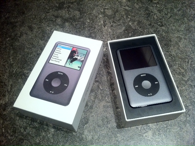

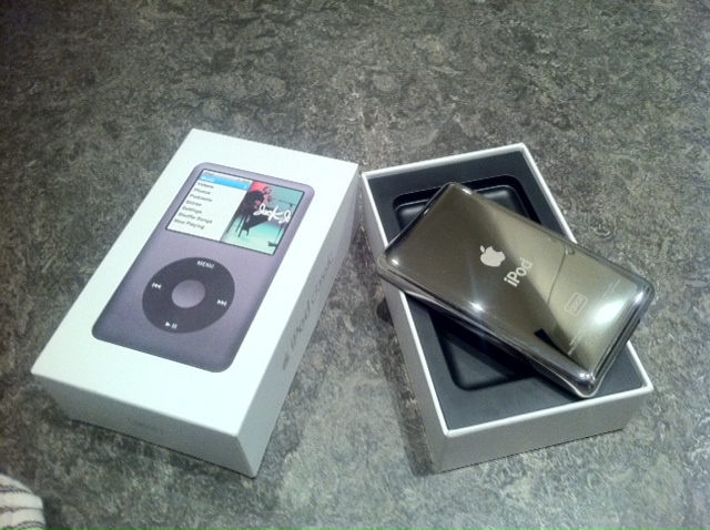

And now with new front and new back.....
Like new.... with SSD :)

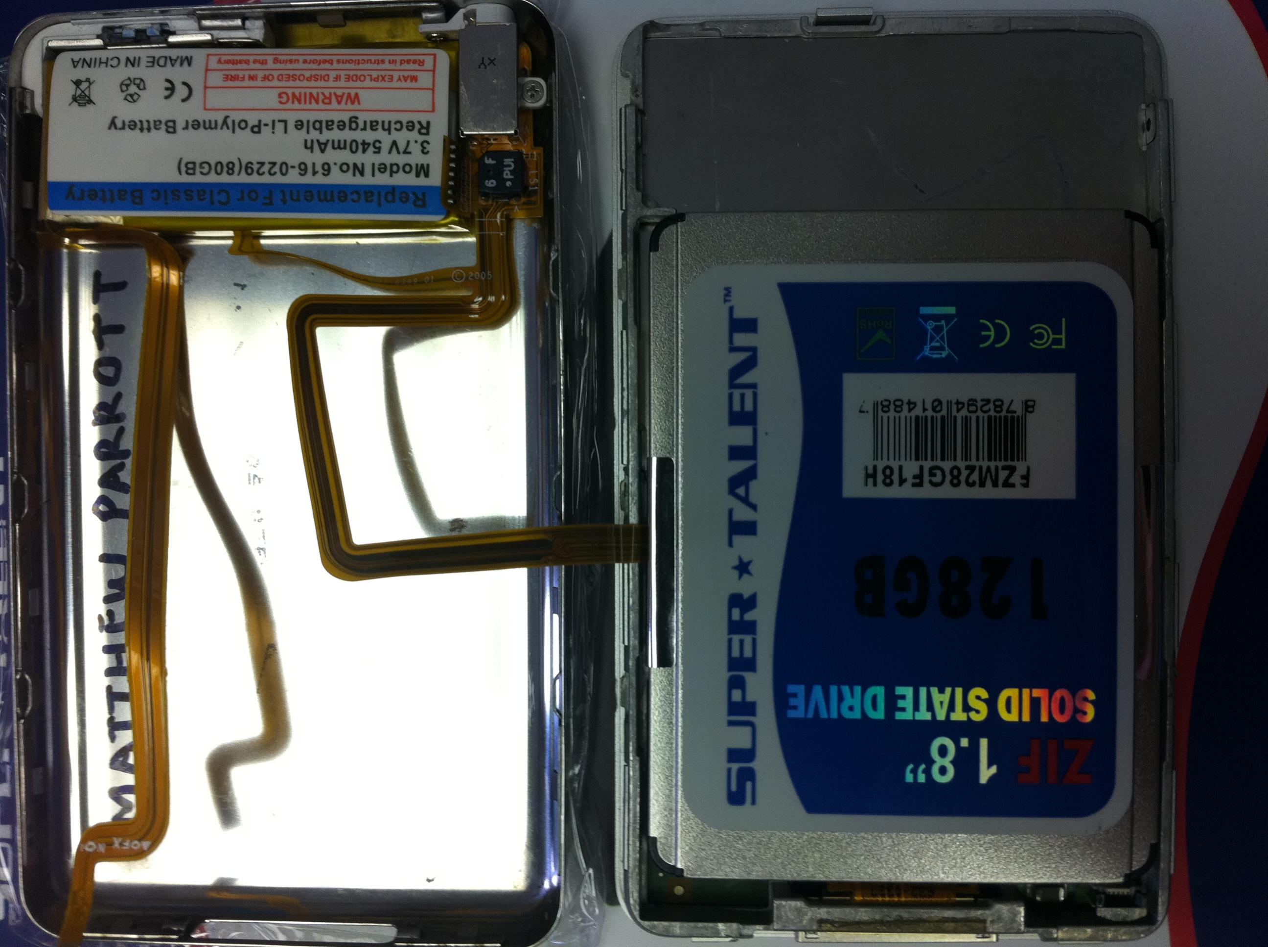

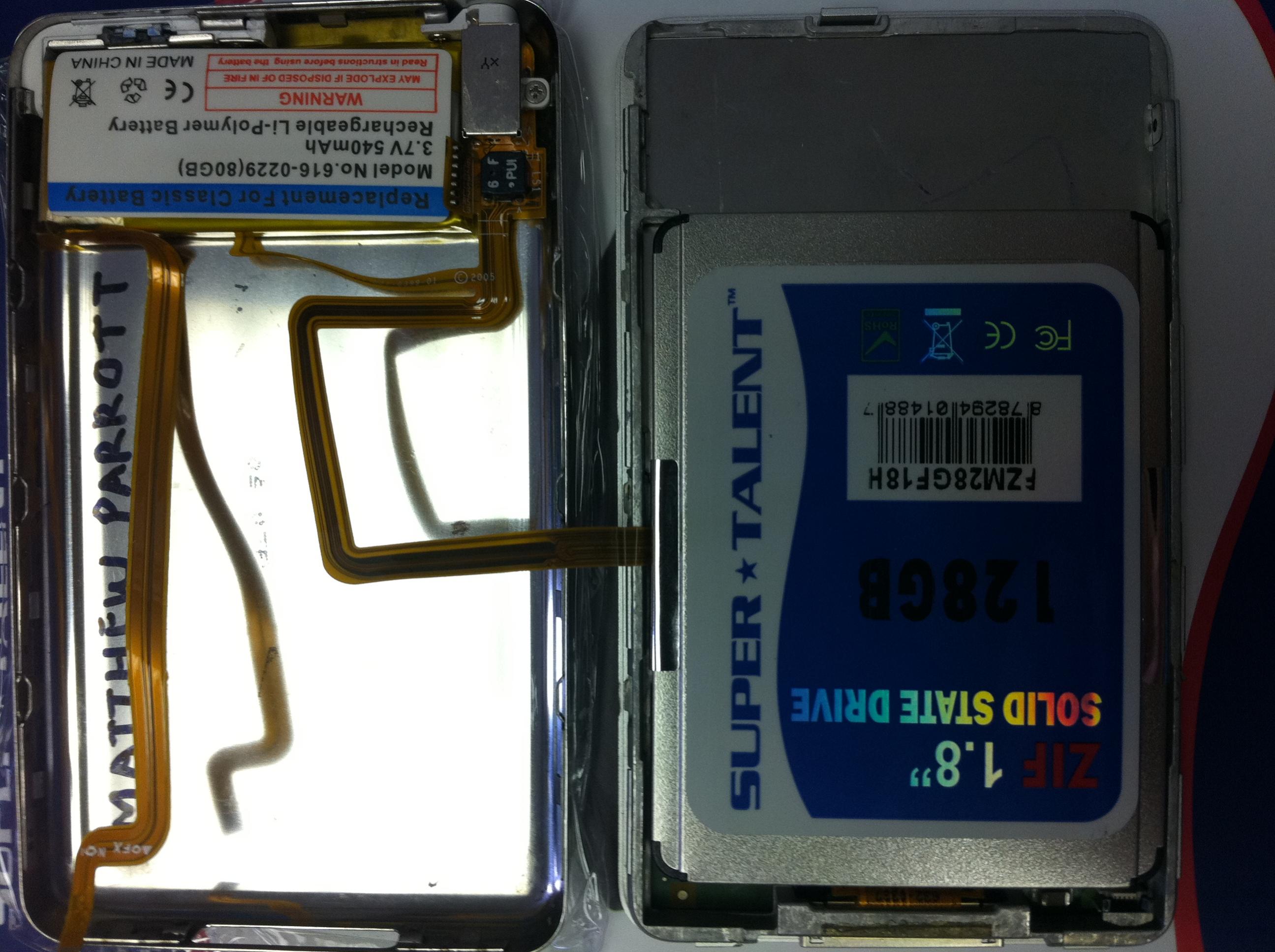

GOBMarlow:
Super Talent FZM28GF18H will work :)
My drive specs:
Specification
Mfr Part Number: FZM28GF18H
Capacity: 128 GB
Form Factor: 1.8 inch
Interface: 40-pin PATA ZIF
NAND Flash: MLC
Plays 39,5 hours music with full audio volume... the battery is a brand new.
Nice:D I wish I could do that without destroying my iPod :p
Battery life should greatly improve if you switch songs frequently (I do and it kills the battery much faster)
Gorgeous!
Streem, that came out really nice.

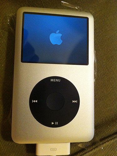

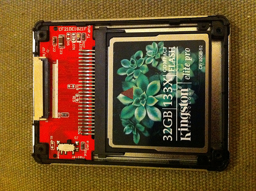

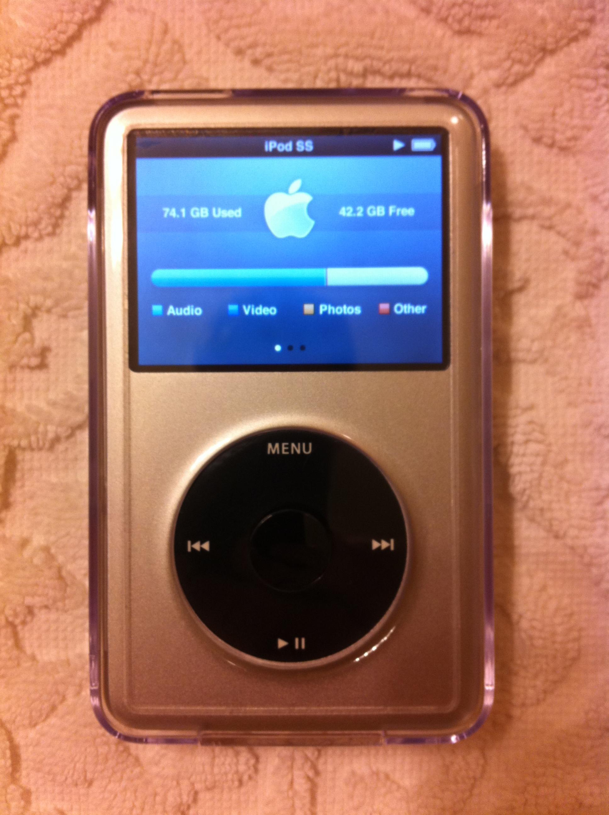

I'm waiting for the SSD to come in so I can complete this ipod built from parts.
Tried it the other night with this to test it, and it worked great
Can't wait for the real deal.
The RunCore speeds looked faster, but I decided I probably wouldn't notice the difference and went with the one you showed worked.

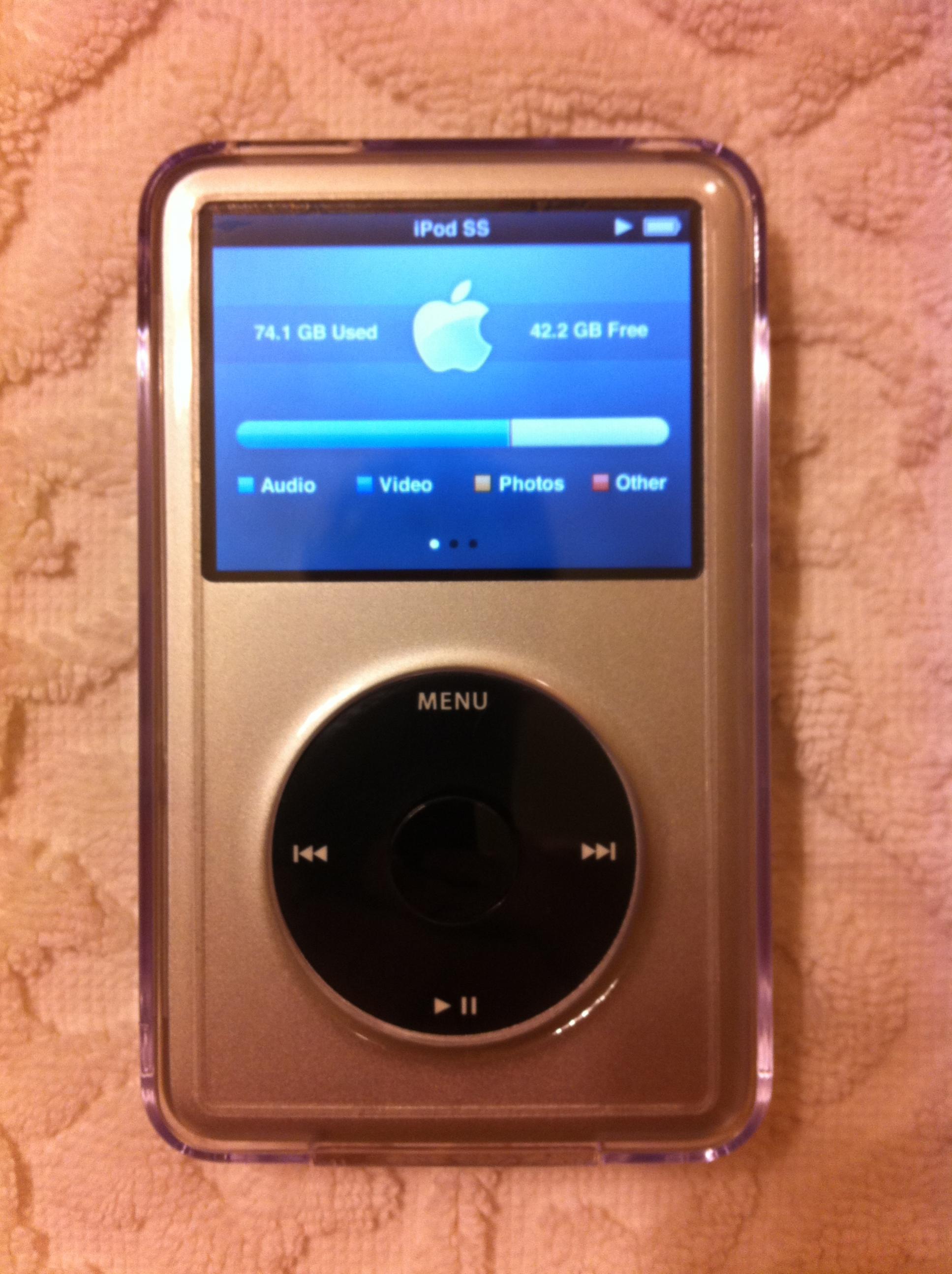

The drive is in and has been for days
works like a charm... Still trying to find a good case... Want to get one made out of the smooth, clear, flexible, hard rubber...

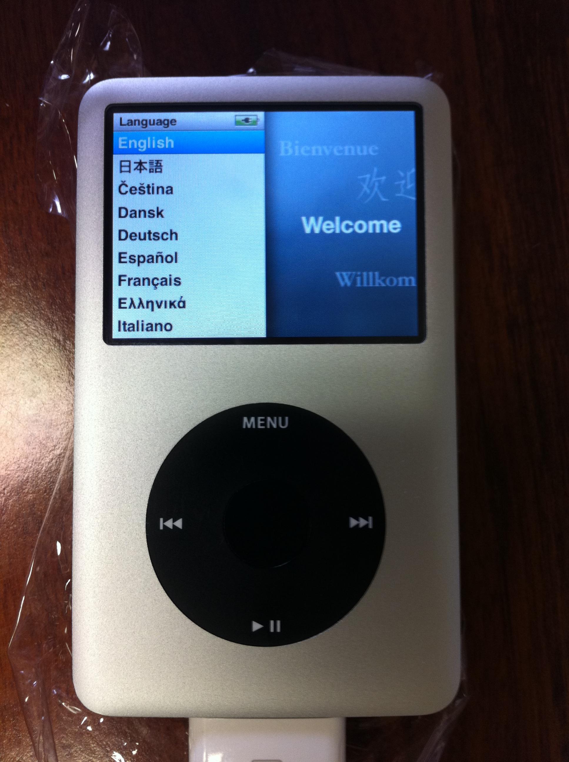

Well there was no lag. It ran fast and long... While it ran :(
I wanted to test battery life. It ran for about 38 hours on full volume. Now it's a brick. I can't get it to turn on. When I woke up the battery was dead after playing for nearly two days. I plugged it in to my iPhone charger and the grey screen with the white apple came on. I assumed that meant it was getting power and would charge. When I picked it up tonight expected that it would at least come on, but nothing. I tried resetting. I tried charging via fire wire and then resetting. I haven't gotten so much as a Pixel of light.
Any ideas?
I let it charge on my wall charger from my 3rd gen last night. I hit the menu button this AM and let there be light. Thought I had it licked. When I unplugged it, it continued to run and showed a full battery. Took a shower and picked it back up and thought it was odd that when I tried to fire it back up I got the grey screen with the white apple again. It never made it to the menu. Put it back on the wall charger and it immediately came to life. Trying to restore it right now.
Any luck getting it to work?
So is it working now?
It SEEMS to be working again now. I will say that I will NOT let it run all the way down again. Seems if you do, you should plan on restoring it.
After restoring twice, it started working again.

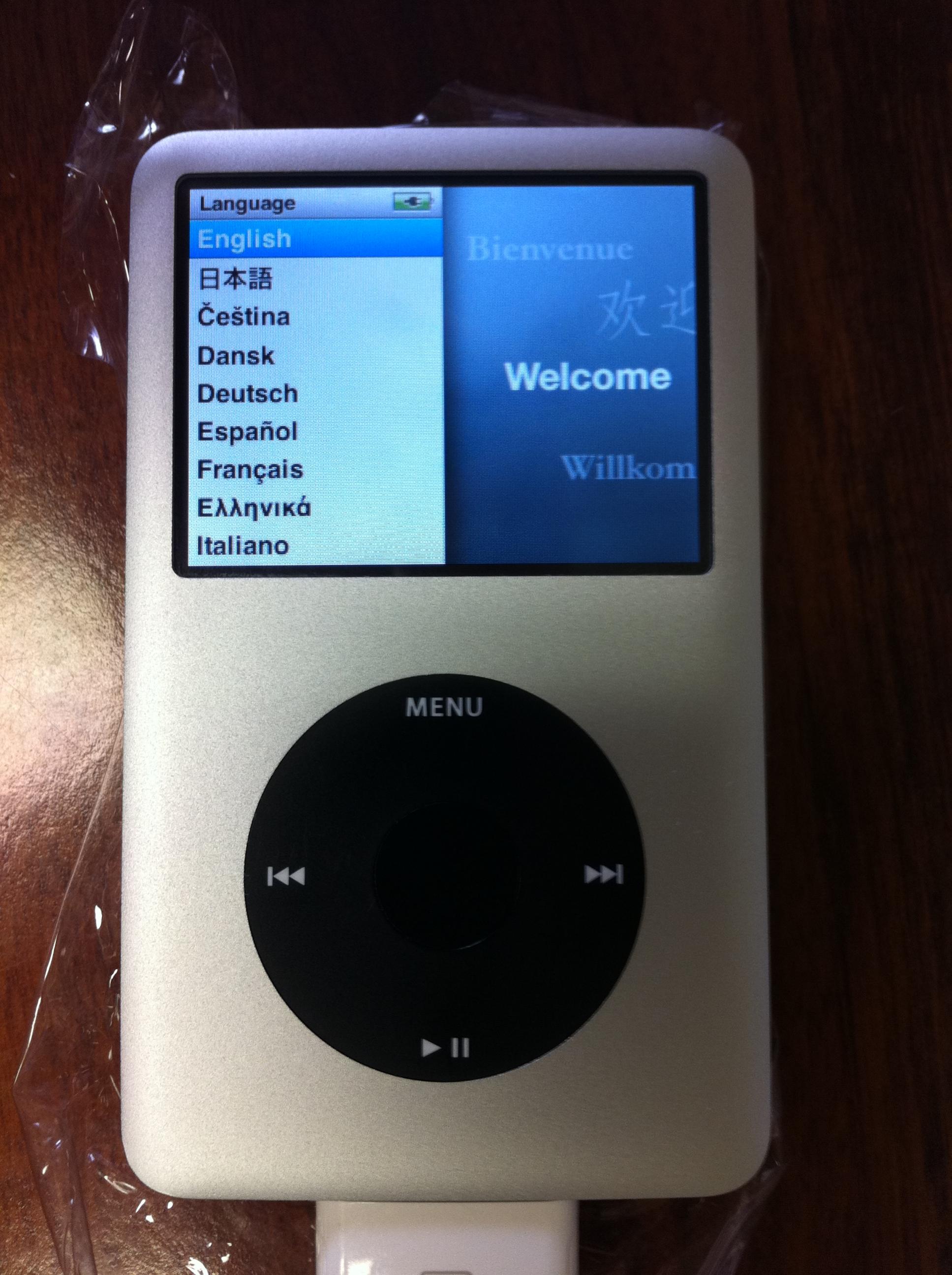

I used a 5th Gen iPod Video 80Gb (Black) and a Samsung 64Gb SSD taken from a original MacBook Air. I didn't even stop to think if it would work just did it. The only thing it asked me to do after completing the mod was to restore the iPod in iTunes.
Due to the size of the 64Gb SSD there was actually quite a bit of spare space inside the 80Gb iPod which had to be filled with packing. Im pretty certain that the 64Gb would fit nicely inside a 30Gb iPod Video with ease.
If your considering doing this mod I think you will find that you can pick up MacBook Air SSD for a pretty penny on eBay. Alternatively if a manufacture states that the drive will work with a MacBook Air I think you'll be fine to put it into any iPod from the 5th Gen to the current model.
Good Luck to all and Happy Modding
i wish i knew about this before i swapped the hard drive in my 30gb 5th gen ipod video. i replaced the 30gb drive with a later model 120gb HDD. if i knew that i could have put a 128gb air sdd drive in it, i would have held out and searched for one of those. :( oh well. if the drive ever goes out again, i know which one is going in next.
