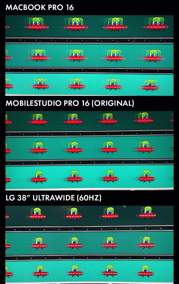

Here's a very unscientific test...
  1. iPhone 11 Slow Video (240fps)
  2. Dragged UFO browser test between the MacBook and 2 displays connected to it.
  3. Then played back slow speed on phone while recording iPhone screen
  4. Compiled the 3 displays together and converted to short looping GIF
To my eye, the MacBook Pro 16 does have a lot more ghosting or smearing. Depending on what you look at and how you move it, it's very noticeable to see an after image just after something changes direction or when something stops, a trail catching up for a split second.
The Wacom MobileStudio Pro 16 is not perfect either, has some smearing or ghosting that is not as bad, but no ever complained as what can you do with such a nice product I even see a red hue in ghosting areas often.
The LG 38" Ultrawide 38UC99, not perfect, not a gaming monitor, but feels like a standard monitor and better than the previous 2
Note: I purchased a pre-built high-end model from an Apple store shortly after it was released.
