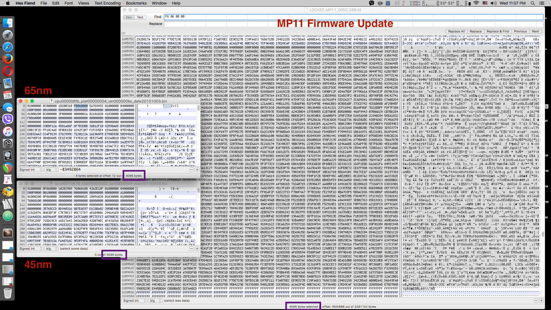

creating a firmware flash for 1,1/2,1 with microcode that would allow the old computer to run next generation of Xeons (LGA 771-socketed Harpertown Xeons based on Penryn microarchitecture), which support SSE4,1. (Pros: you get a 3,1 Mac for 1,1 price. Cons: even more extremely unlikely, as 1: the Penryn microcode from an Intel BIOS would need to be decrypted first, which - given the current state of cryptography - would happen somewhen in 26th century
Looking at the Intel microcode for LGA771 Xeon (both 45nm and 65nm), and comparing it to MacPro firmware update packages (for 1,1, 2,1 and 3,1), i saw that all of them are 4096 bytes long.

So I'm about to do something very stupid, very soon, in that regard...
Just need to get few things first, eprommer (or a clamp), one E5440 and few more days of online digging. :D
I don't think i can let it go until i try it.:apple:
Remember to get the Harp-town (45Nm) chips with a SLAxx stepping as thats the only stepping the Mac Pro 3,1 firmware work with... (SLBxx stepping chips wont work tho on a side note i wonder if this can be used to add SLBxx stepping support to 3,1s) another thing is the checksum of the firmware update may change and the firmware updater program (im talking the one that runs at the EFI level not OS X) may need hacking to account for this IIRC something like this was done for other firmware updates like the Mac Pro 1,1 to 2,1 SMC flash http://forum.netkas.org/index.php?topic=5454.0 read here for some more info
Please do not do this. You will destroy your processor. instead. Let XNU load the modified firmware (see debug output of boot process).
