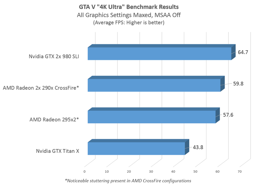

Here is something for you to look at since you said you wanted 4K and max settings:
That is still with MSAA turn off. And, the only thing to break 60FPS was $1100 worth of GPUs in a system that likely cost over $3K.
