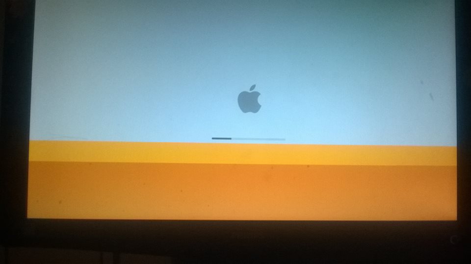

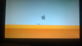

I am not quite sure if I am phrasing it wrong, so I will try to be more exact.
My monitor has DVI and VGA inputs. Originally, I was using a VGA cable from the display, and taking it to an adapter that would then plug into my DVI port on my GPU. No video from either card, with any configuration no matter what I tried from anybody here.
Then I thought that the adapter may have been the problem, so I removed the VGA cable and adapter all together, and connected my DVI CABLE from monitor DVI IN to my GPU DVI OUT (so, straight DVI). This allowed me to use my GT 610, yay! But, no GTX 750 no matter what I tried.
At this point, I am pretty sure this is just an incompatible version of the GTX 750 or something. If anyone can give me another idea, I will try it, but I am resigned to the fact that it will not work. I have quadruple checked that the proper Web Drivers are loaded, tried various different cables, tried the card in different slots, tried the card with no other expansion cards installed. Nothing out of my GTX 750.

Hi mac lovers :) Im new here, and i glad to see this helful mac forum.
I have a big problem. I bout a second hand mac from ebay.uk two weeks ago. http://www.ebay.co.uk/itm/252058297464
Apple Mac Pro 8 Core Intel Xeon 2.33Ghz 8GB RAM 250GB HD nVidia 8800GT 512MB j.
yesterday i updated the mac.. and the display start to flashing and freezing.. i restarted and won't boot anymore in any mode.. only with the option key, i see the HD Macintos and Recovery 10.10.5 , bot if i click does not respond..
I found this forum, and i folloved the instructions from the 1 page , i installed the pached yosemite to usb flash drive 8 giga with my laptop apple macbook pro late 2010, i used the disk utility to restore pached yosemite to usb drive.
and now want to install, the install starting but in 30% starting to flashing the screen, and it's frozing..
Please help me , what ca i do :(
Did you install Yosefix before updating? Or had it been installed previously? Have you checked the graphic card is compatible with Yosemite 10.10.5? Not clear why you updated the OS in the way described if it was already running 10.10.4 when you bought it. You could have just installed Yosefix - if not already installed, and downloaded the 10.10.5 update from Apple.
I did not instaled Yosefix, I do not know if it was instaled previously. And
I don't know that I should not install new version yosemite :(

Try resetting the nvram: https://support.apple.com/en-us/HT204063
See if it will boot.

On the ebay link it says it is running 10.10.4 - depending on how this was achieved you may need to install Yosefix (referred to in the 1st post of this thread). This ensures that the updated files required to enable Yosemite to run on your Mac Pro are not overwritten by any future Apple update. How did you perform the update that seems to have caused the problem?
It was normal update from the internet ..
I thinking about my NVIDIA GF 8800 GTS 512 MB OC DUAL DVI, maybe is Dead ?? How can make a test to be shore ?
