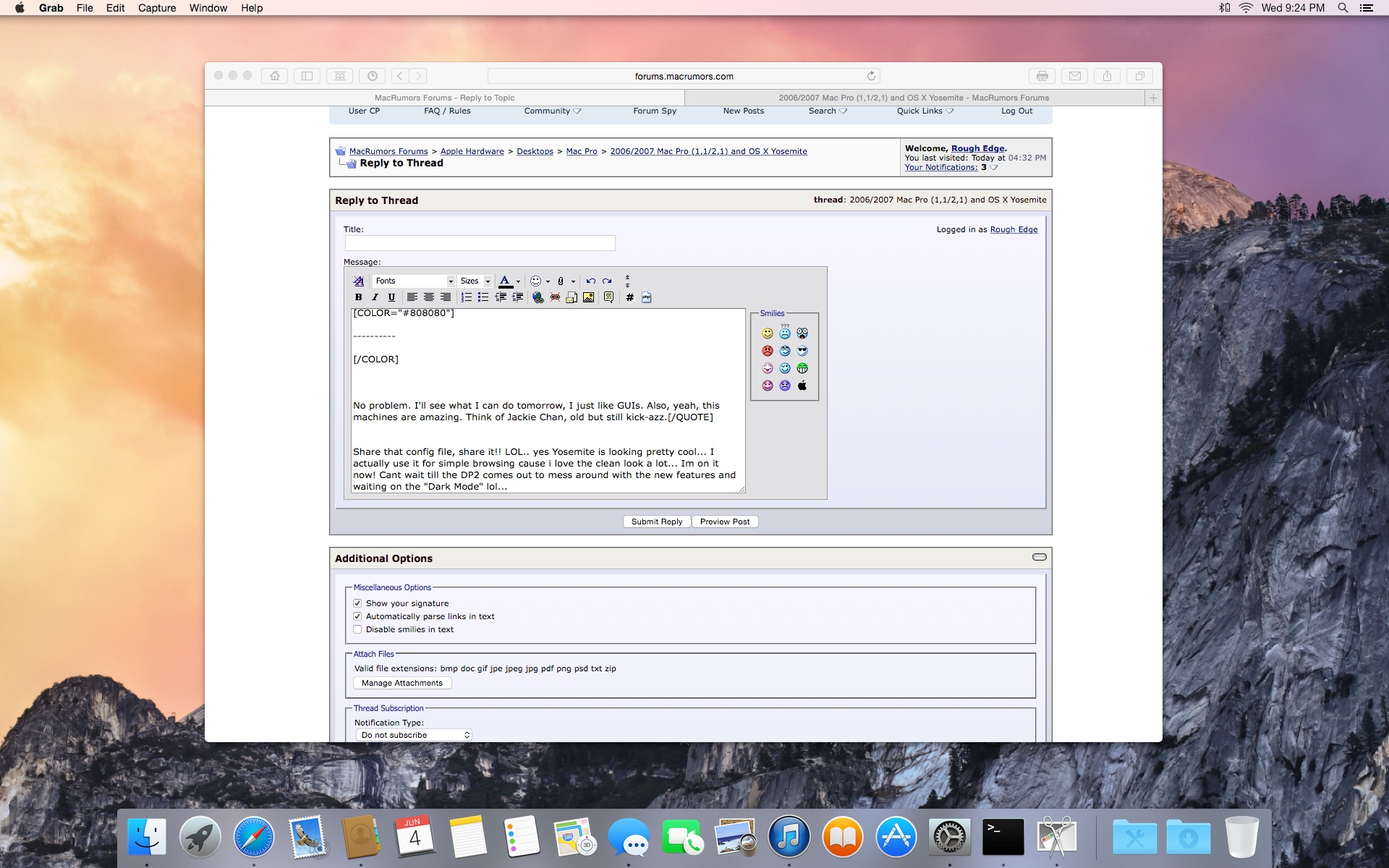

Share that config file, share it!! LOL.. yes Yosemite is looking pretty cool... I actually use it for simple browsing cause i love the clean look a lot... Im on it now! Cant wait till the DP2 comes out to mess around with the new features and waiting on the "Dark Mode" lol...
Its coming, although I don't think you don't need it, its just for the boot options.
