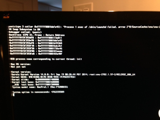

Yosemite Broken
Since yesterday i get this message when i try to boot Yosemite. Any1 know what it means?
Not sure how to fix it besides reinstalling the OS but here is what you need to search for on Google and then do some reading:
"launchd init kernel panic" (without the quotes)
