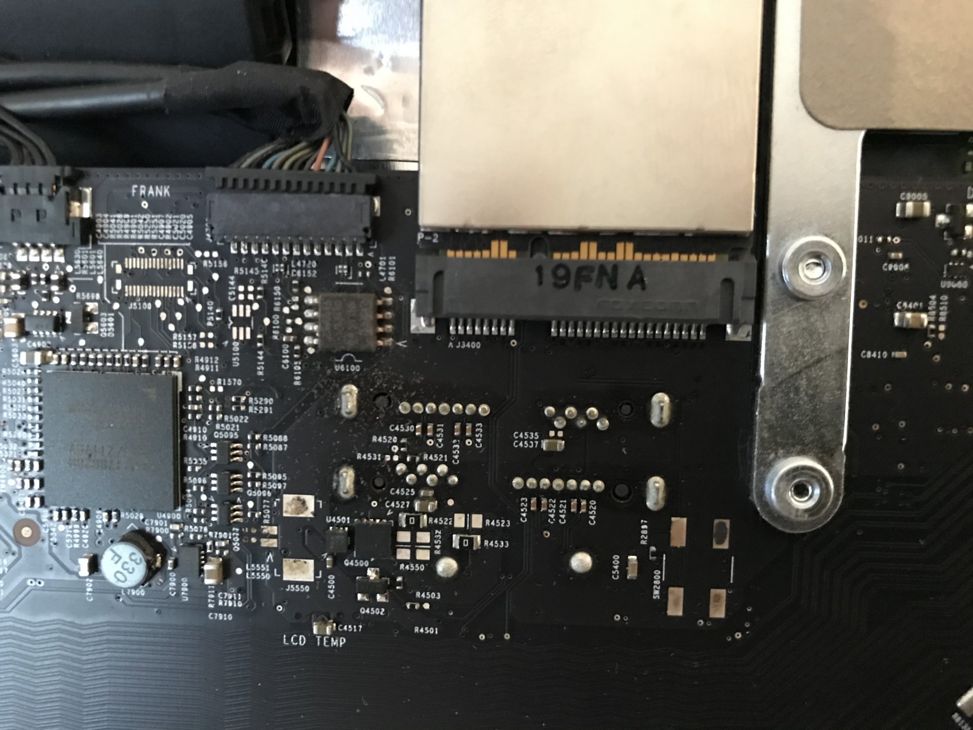

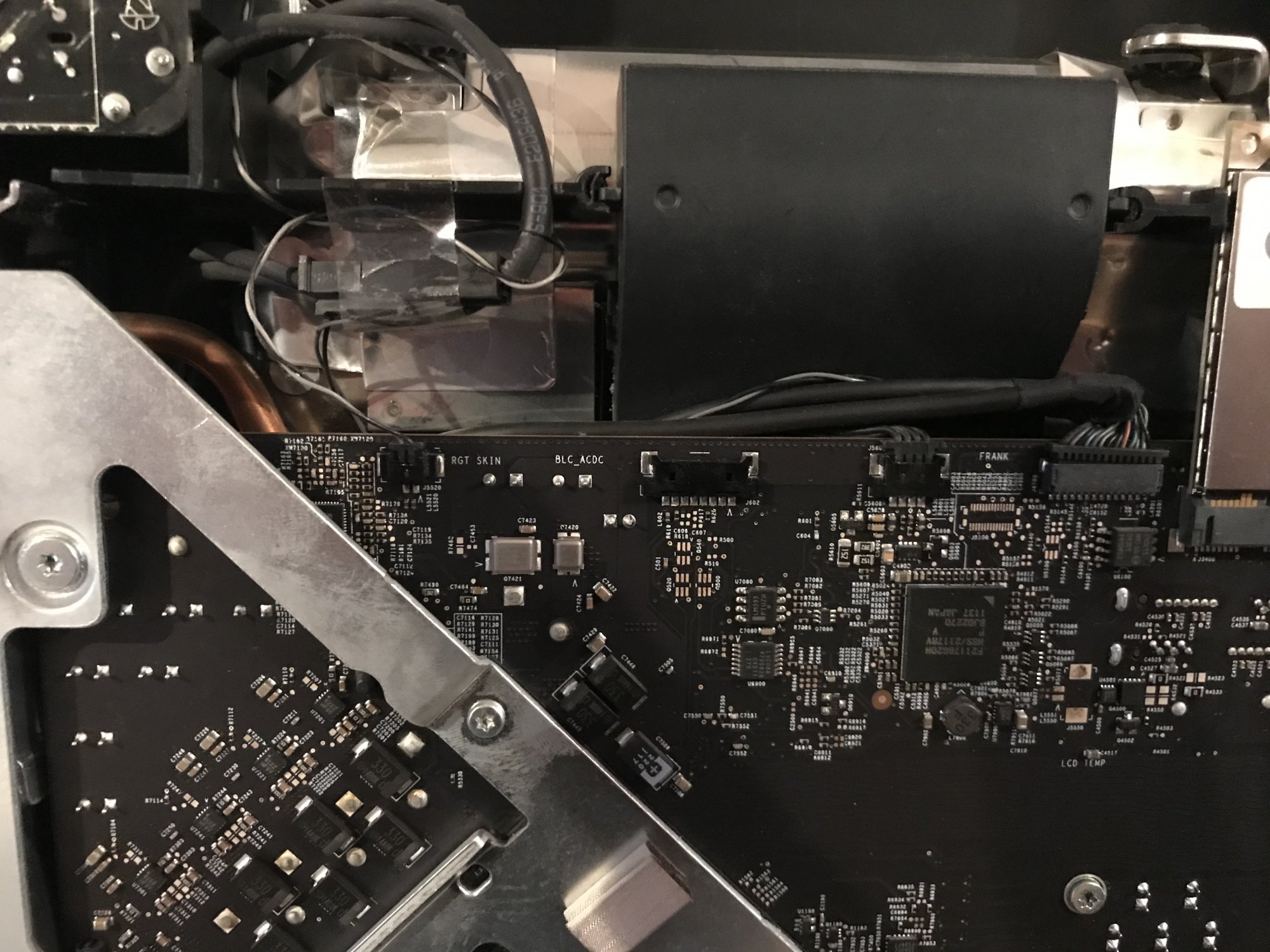

So I failed. It appears that me trying to get the programmer clip to stick on the bios chip has damaged the mainboard.
there should be four capacitors on the left of the bios chip. Now there are only two. I’ve attached a before and after picture. Both capacitors are nowhere to be found. Even if they are still in the case or even my house for that matter they are so small that searching and finding them would be near to impossible. Even if I could find them I don’t have the soldering skills to reattach them.
I’m thinking of buying a secondhand board.
Or if anyone has a better suggestion....
before pic
after pic
As it appears so... Yes.
I just tried the old clip on the bios again without success and when I stopped and wanted to boot the iMac it showed the same symptoms as before.. just starting and stoppen the fans.
So I cleanes the area around the bios chip with some alcohol and drew the pencil lines again, it took two attempts and increasingly thicker lines but the iMac is booting again. :)
Reactions: Dilli and jborko
