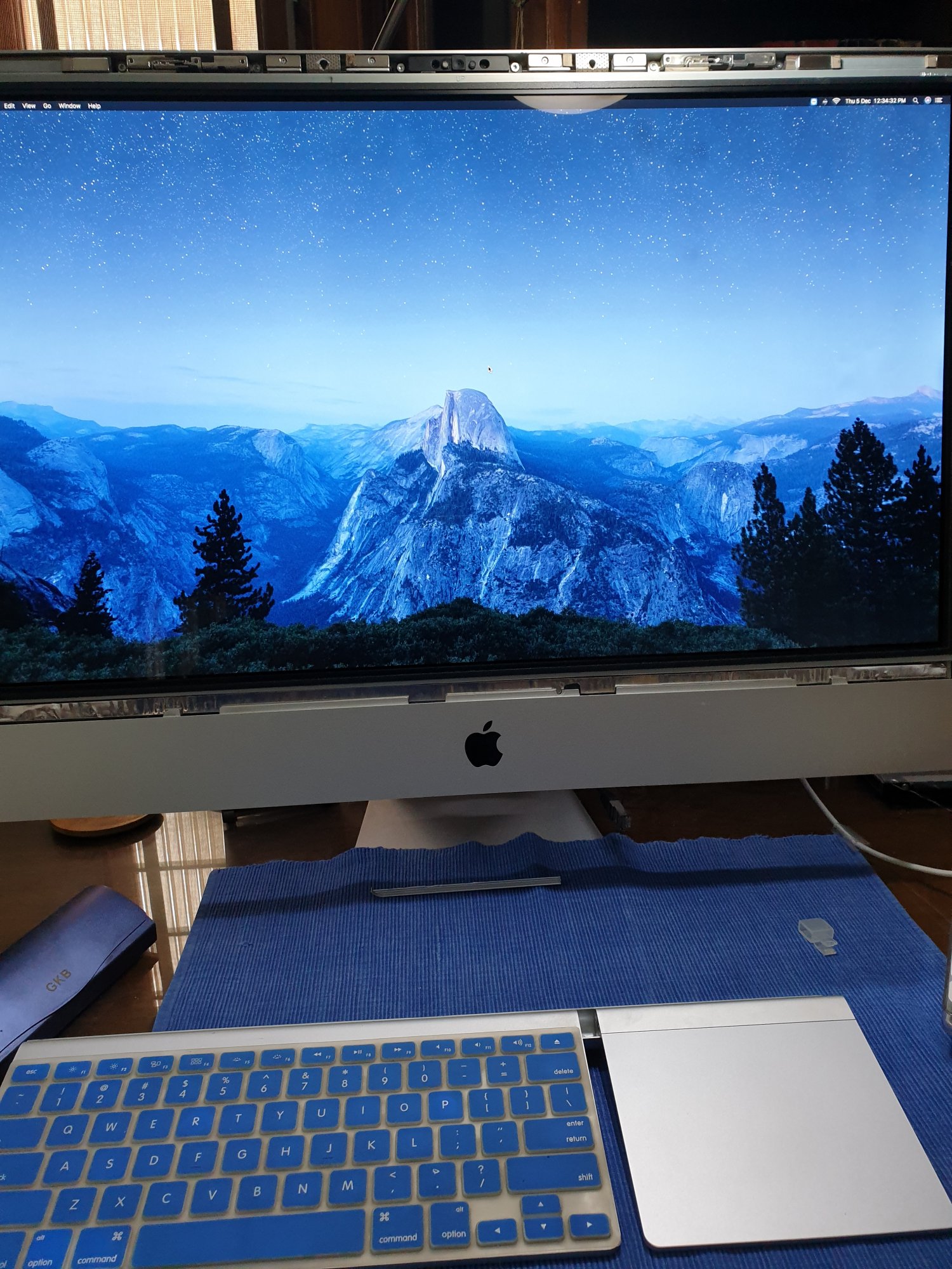

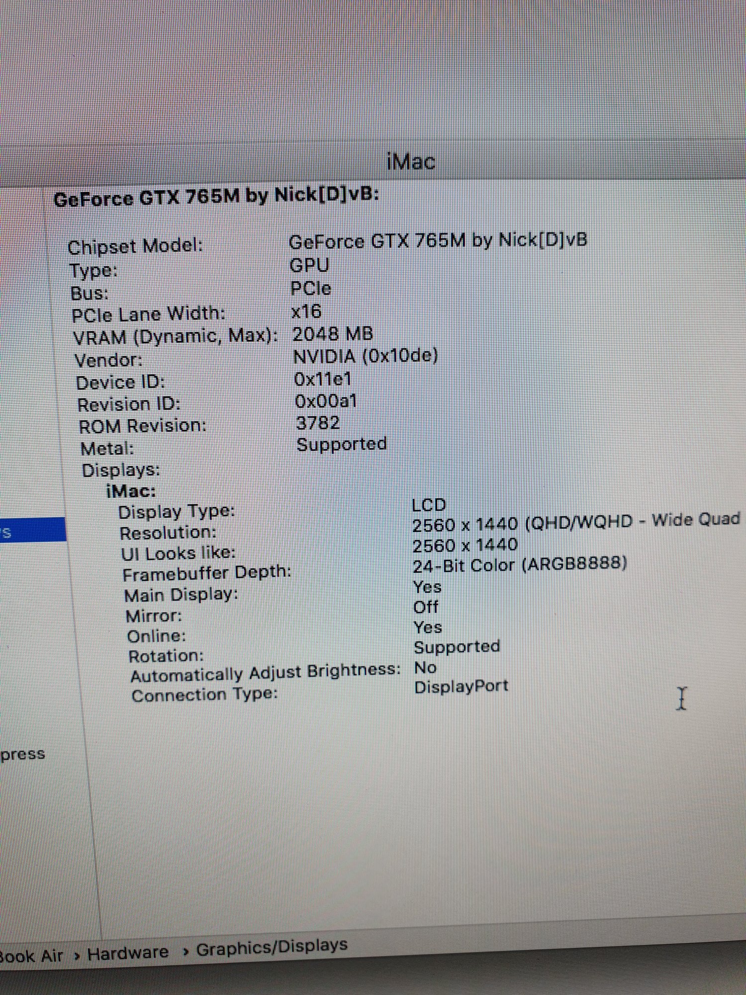

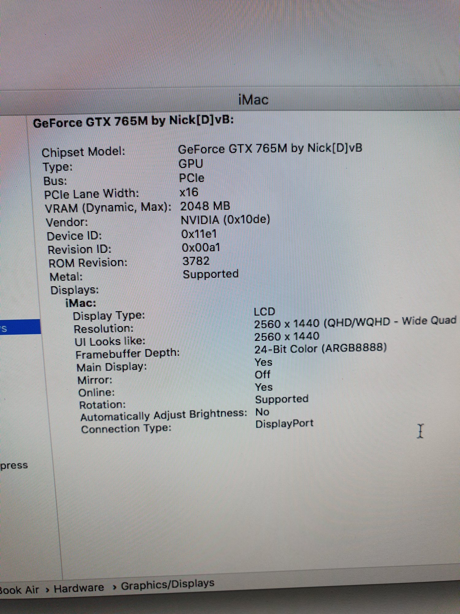

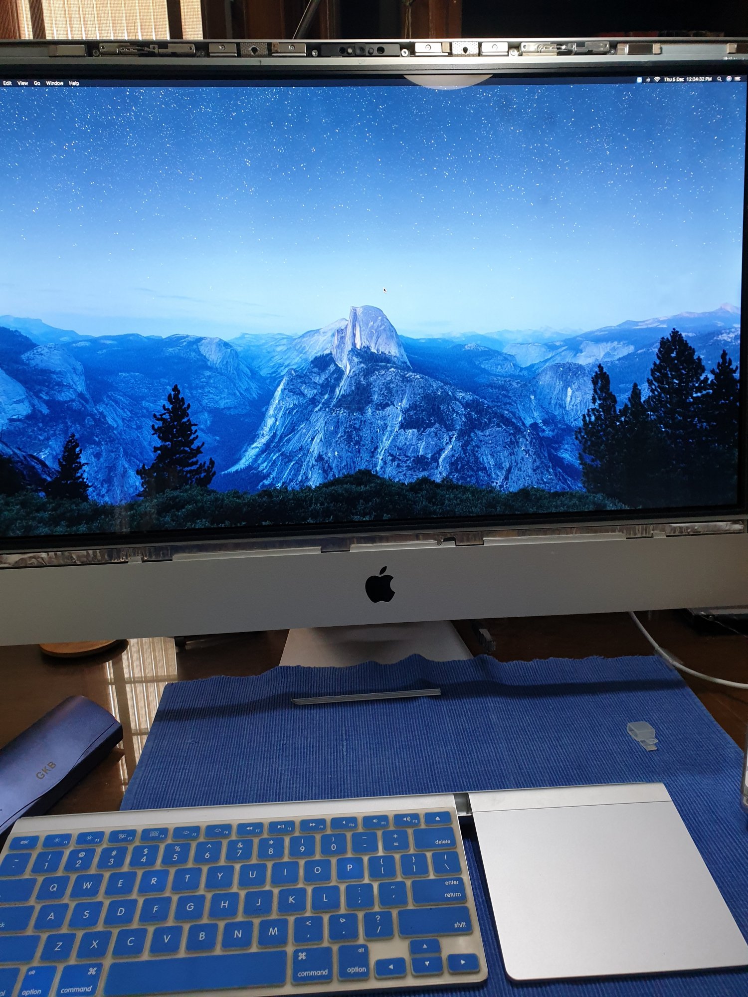

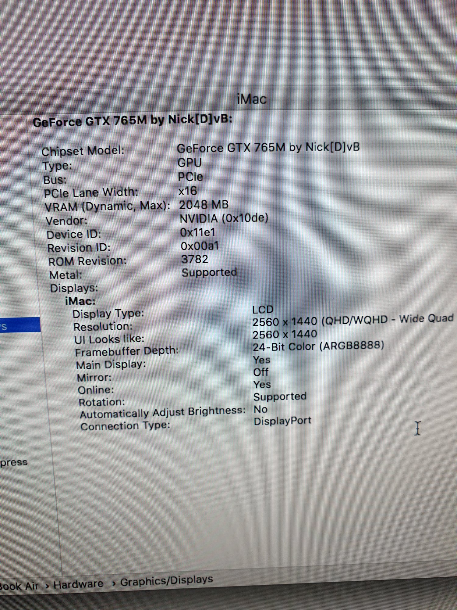

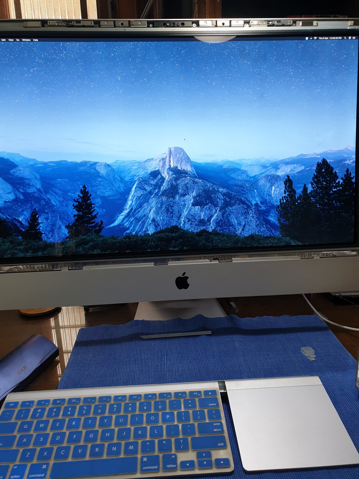

Special Thanks to all dear friends in this community which has made it possible to get my iMac alive from the dead Graveyard.
I finally got success and my iMac 27 inch mid 2011 is perfectly working now. Wow! I just cannot keep up with the emotion I am going through.
My special thanks to @Nick [D]vB , @FlorisVN , @jborko , DosDude1 and many good people who gave their excellent inputs and work around to make it happen. In fact I followed last step of attaching my SSD with High Sierra to Sata 0 instead of Sata 02 earlier and the machine booted.
I have had my fans still full Blast so I got the app Macs Fan Control and custom set the fan presets to ODD-1500, CPU-1163 & left HDD as it is since it is a ssd . Please correct me if the Presets are Okay.
I downloaded the Brightness slider and so far it works to control the brightness.
I shall now have a extra display cable which is in transit (Its always welcome as spare parts)
Now I shall partition my drive and Install Mojave with Dosdude1's patch without Legacy Graphics.
Here are some pictures of the Dell Alienware 765M Card flashed with Nick's vbios Beta 3 working perfectly.
It is a real moment of celebration for Me.:):):):)
