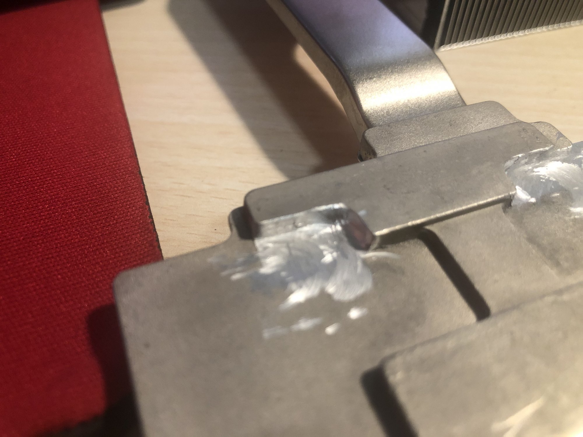

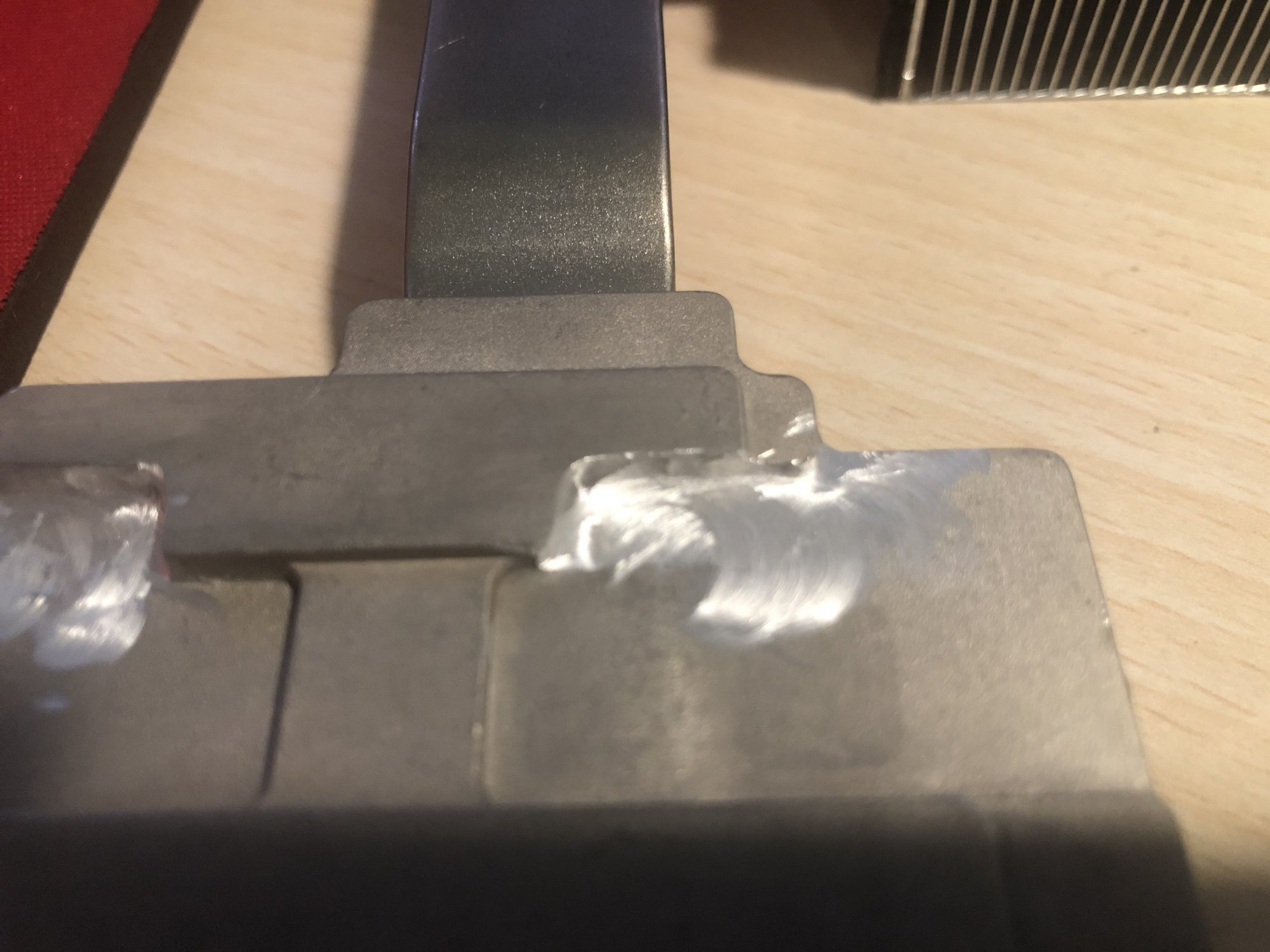

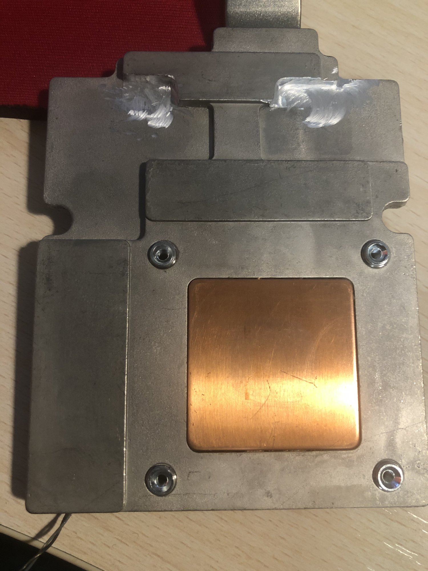

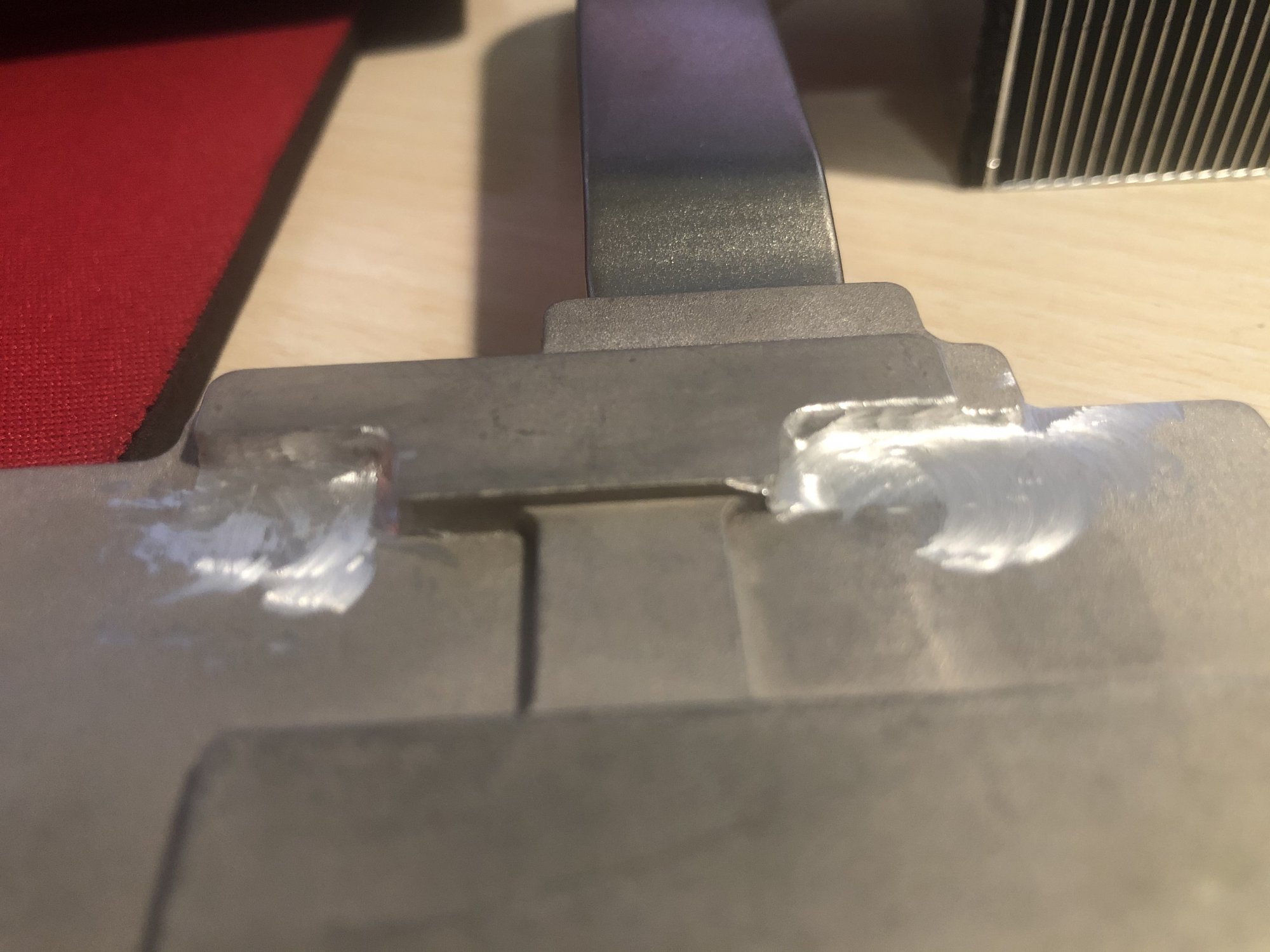

The first mod you need to do is to drill out the holes on the bracket of the K2100M. Second, you need some small washers or plastic things to put under the holes when you mount the GPU, because otherwise it would sit slightly at an angle. And basically thats it, you just need to swap the cards. Also put in an SSD of course, its pretty cheap and the difference is night and day in performance.
I never understood what people meant by "drill out the holes". When I did the swap with a Dell K1100M, I held the card in my hand, used a phillips screwdriver bit, and just pushed the x-clamp out. After that, I threw the Apple X-clamp on there, and it screwed right back into the heatsink and sat fine, no issues.
Some people have the bigger cards with a different x-bracket which will not fit on a smaller K1100M or K2100M card. Then you have to reuse the Dell x-bracket and hammer or drill the rivets out after separating it from the card. Post #1 and the pictures provided by all the people. BTW: Does anybody need big original apple x-brackets 🙂

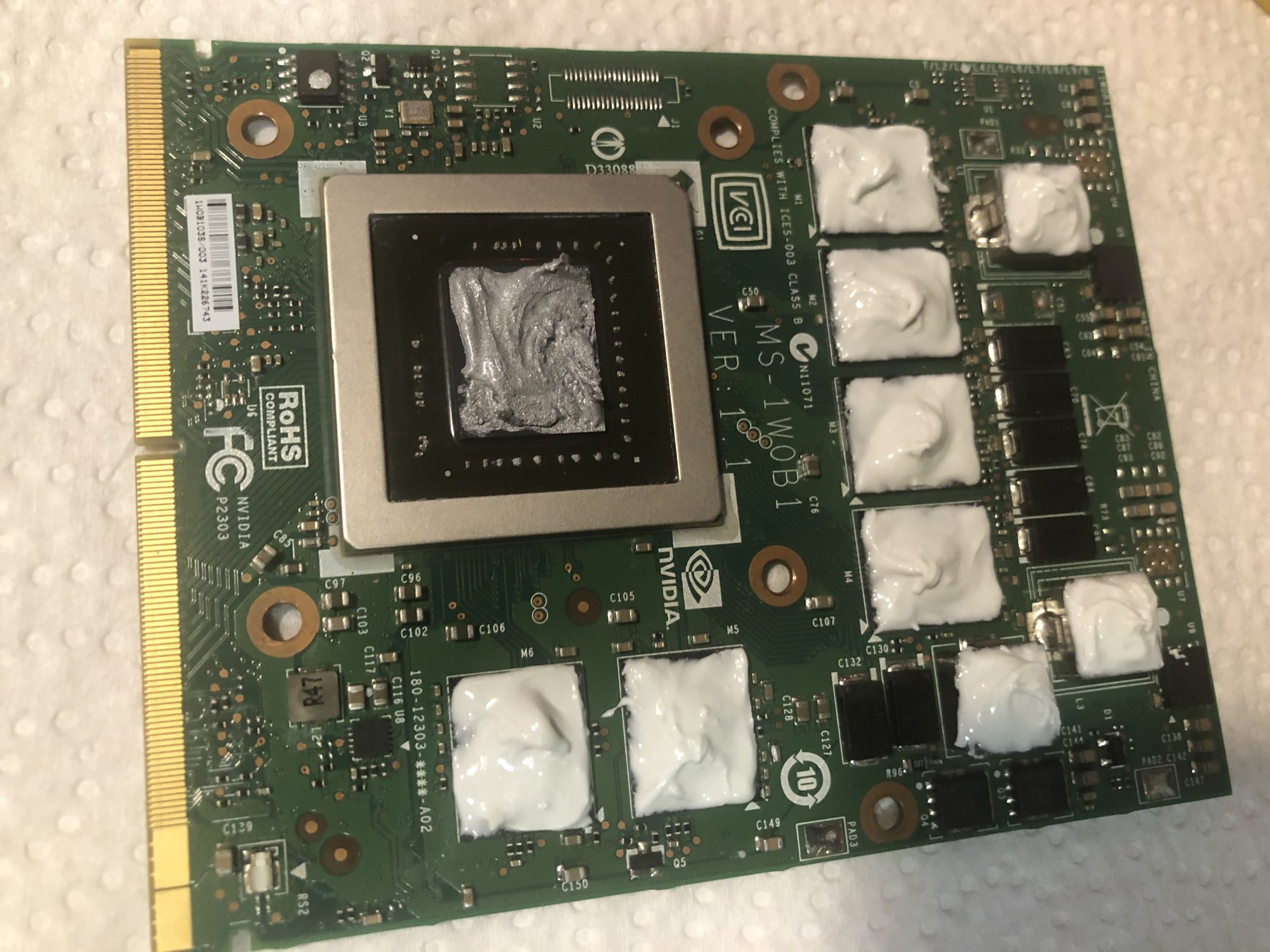

It was a pretty easy straight swap for me. Removed the stock x-bracket from the K2100m and installed apple bracket. The k2100m might up for grabs soon if you are interested 😁
Do you mean the Type B cards? So that means for an MXM-B to A swap you can't just use the Apple X-Clamp?

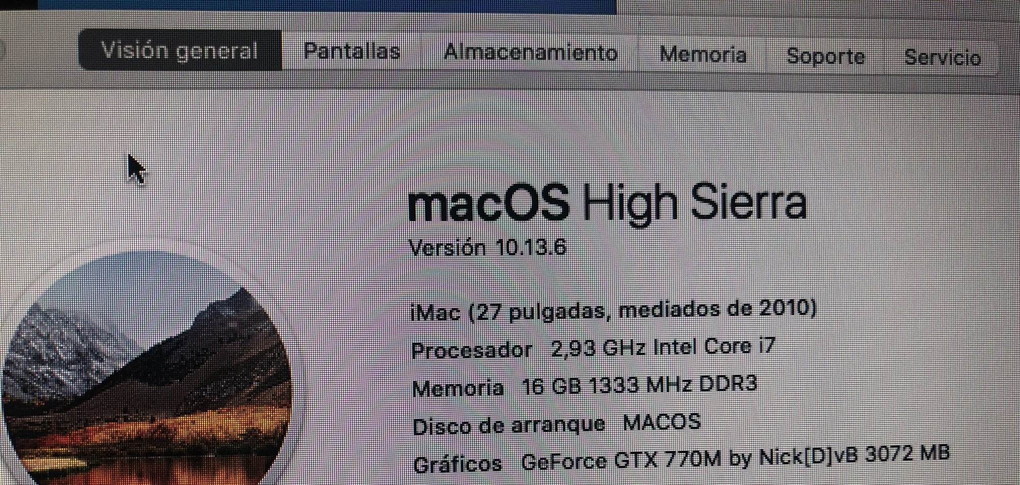

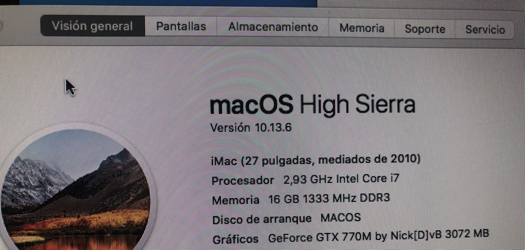

Hi, I have installed a 770m on my mac 27 ". Now I wanted to put the firmware in order to have the boot but I don't know how to do it since I can't find how to flash the 770m bios from mac. Hi, I have installed a 770m on my mac 27 ". Now I wanted to put the firmware in order to have the boot but I don't know how to do it since I can't find how to flash the 770m bios from mac.
Thanks

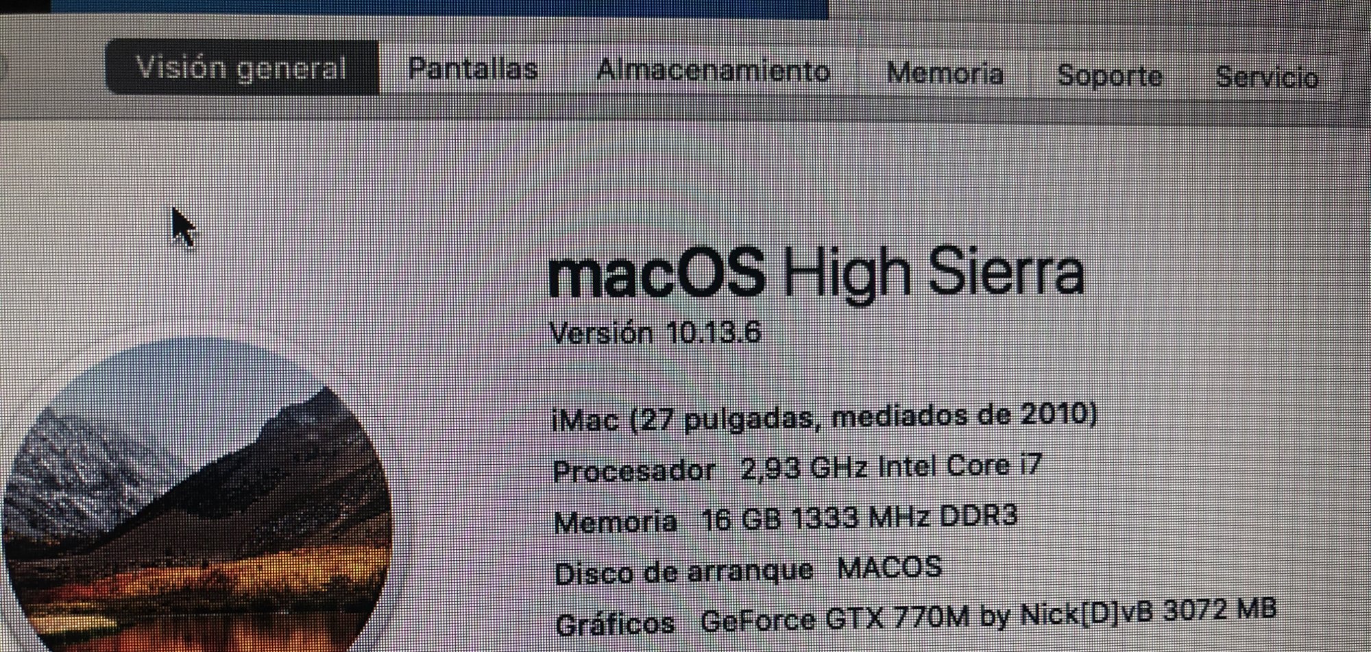

Thanks
Read post #4363 and try out this Linux usb stick/sd card method to write the BIOS directly from the iMac if your internal display is already working. I recently checked out just out of of curiosity. Just follow the description in the link, write it down or print it out if you have no iPad, iPhone to watch it while booting Linux...

Thank you very much, with this system in the end I was able to flash my 770m and I already have it working. Now I will install Catalina to do tests to see how it goes ...
