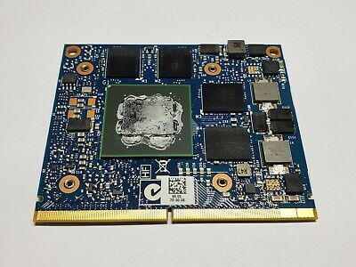

Hello to everybody, I'm waiting for my K2100M :
Dell Precision M4800 carte vidéo GPU Nvidia Quadro K2100M 2 Go 0G4FN0 74431 testé | eBay
Les meilleures offres pour Dell Precision M4800 carte vidéo GPU Nvidia Quadro K2100M 2 Go 0G4FN0 74431 testé sont sur eBay ✓ Comparez les prix et les spécificités des produits neufs et d'occasion ✓ Pleins d'articles en livraison gratuite!www.ebay.fr
I read a lot this thread before making my first post. I must admit that it is not so straightforward to follow (although I'm quite trained to computer HW modifications and upgrades). I will come back to you soon with more precise questions.

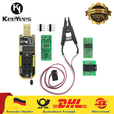

I would like to flash my K2100M with the CH341 method (prefer the old school way) : any reference and ebay link in order to choose the correct one with all needed clip / cables ?
Thanks in advance and talk to you soon.
