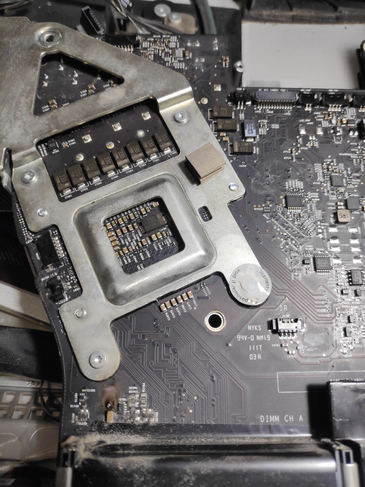

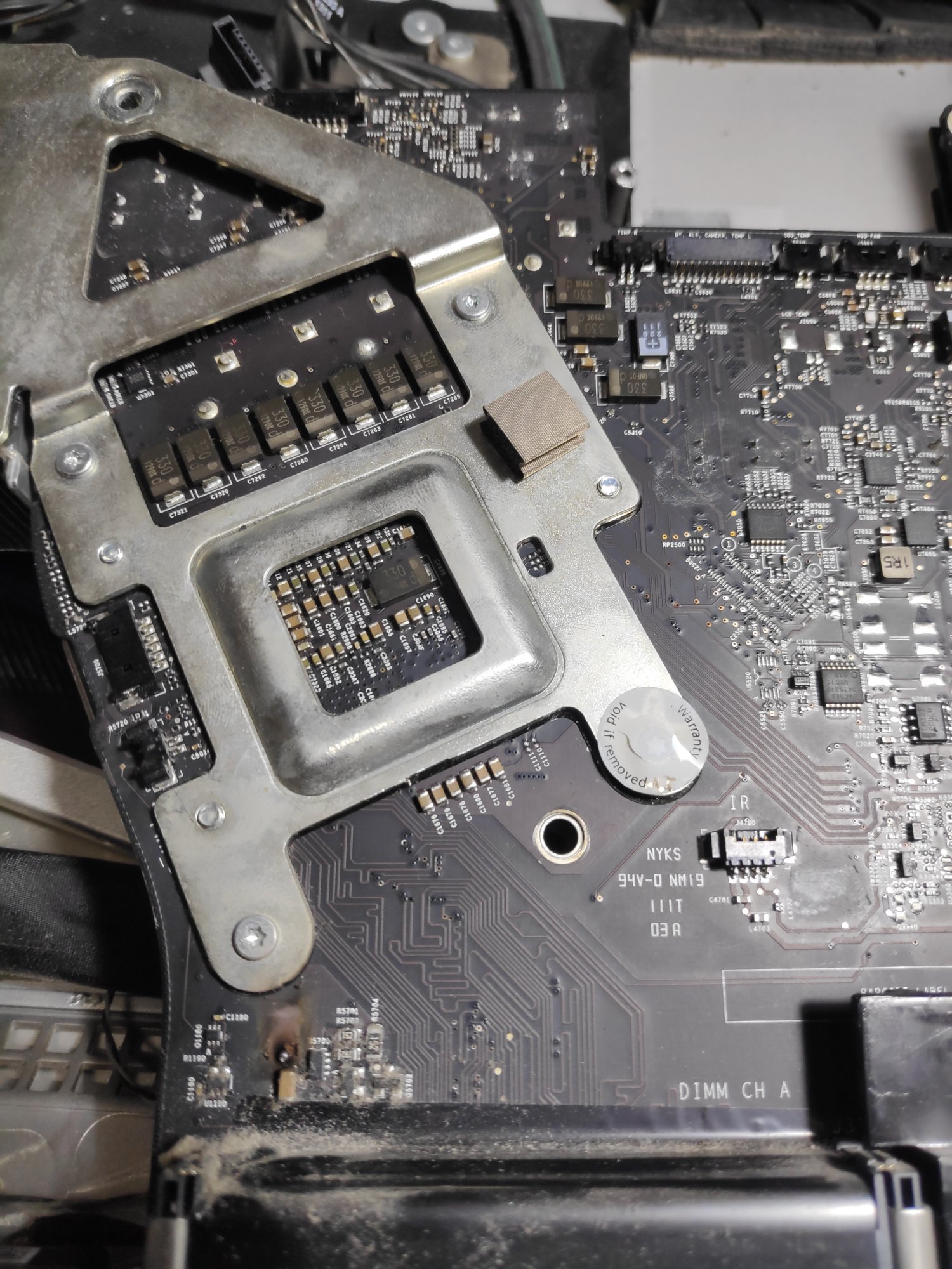

Hi, so I tried to upgrade my iMac 21.5 11' gpu to k2000m, disassemble everything, putting on the GPU and I try to check the led diagnostic before putting on the LCD.
At first there were only one led turn on. I unscrew the logic board and check evry cable at the back in case I miss something, then screw it back on and plug in psu and power cable.
As I was pressing the power button, I saw a spark on my logic board
As you can see on the bottom left 😣
I don't know what went wrong but yeahhh, goodbye logic board
Calm down, first use Contact Cleaner and clean the burned area, then try to look for a short there, maybe is a resistor and you can replace it. Hope u get luck!
Thank you but I think micro soldering is beyond me. I've asked around and the price for the labour to replace the resistor and capacitor is near to a used logic board on eBay. So I might just buy another board and sold this as a faulty unit.
But I'm still curious why there's is no second led on my board, is there a problem with the psu? Would it be a reason the board is shorted?
