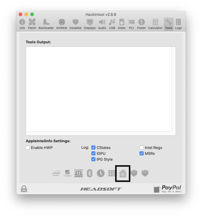

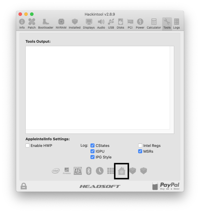

To install this kext unlock your System partition using Hackintool, drag the kext on-top of the kext utility icon let it install/timeout with an error. Open terminal and enter "sudo reboot" skipping this step may leave your iMac hanging at the desktop (A Catalina issue)
How to install:
When booting you need to Hold Alt/Option to bring up the AppleBootPicker, then select the Catalina partition. Since the iMac's Screen is on when using AppleBootPicker the Macs screen will remain on the entire boot process allowing you to log in and then proceed to install the Patched AppleGraphicsControl Kext.

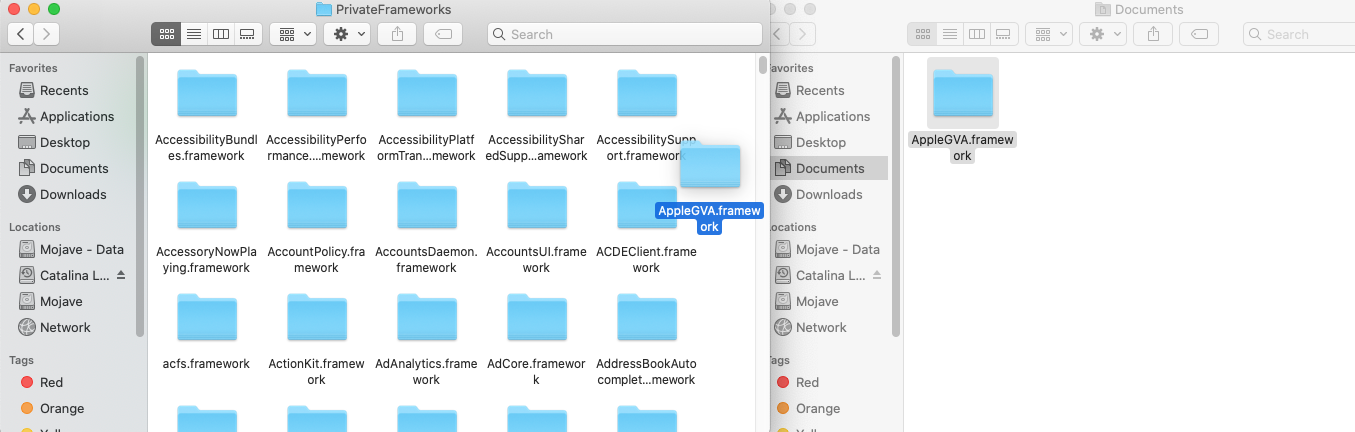

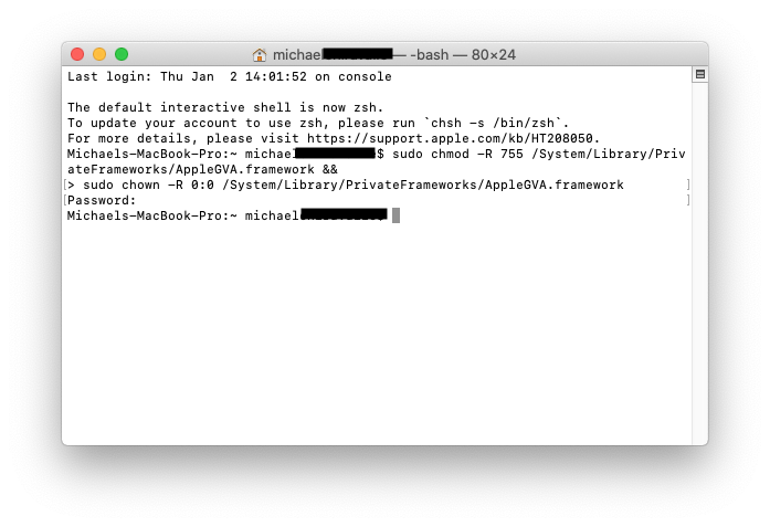

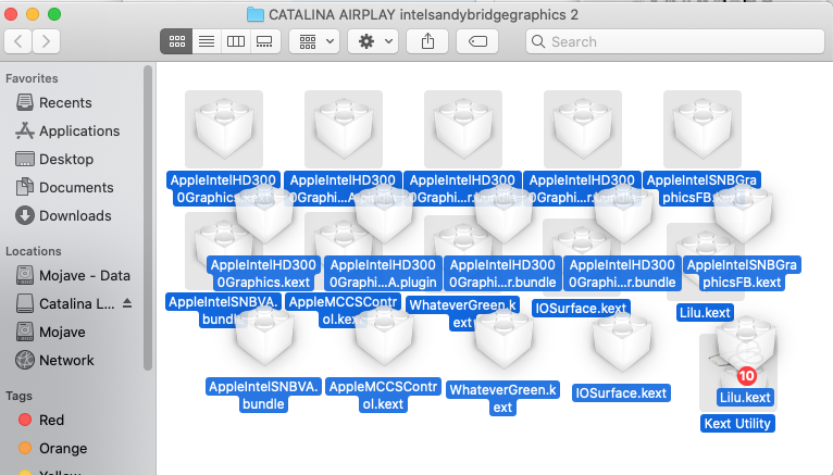

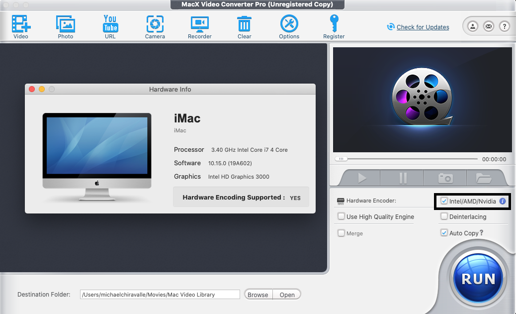

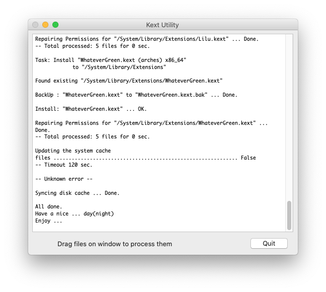

Hi guys :) I'm at it again, trying to fix a 2009 27" with a K610M for someone else but I'm running into some issues and maybe it's me missing something but I'm not sure checked things over and over again now.
So the situation:
  1. 27" iMac 2009 with 2.8GHz i7 and a K610M
  2. Installed High Sierra first to get latest boot rom just making sure
  3. Installed Catalina (10.15.5) through Dosdude's patcher, disabling post-install patches

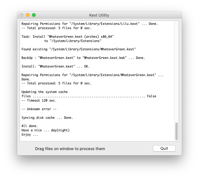

  4. Made an OC USB stick with kexts 3, 4, 5, 6 enabled
  5. Installed Lilu and WhateverGreen manually

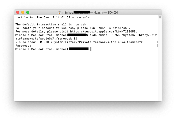

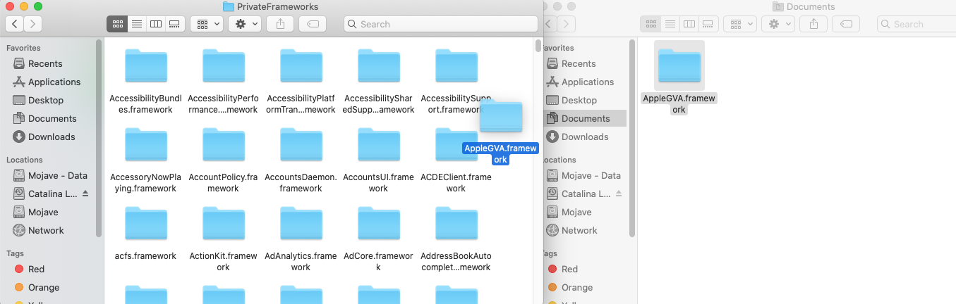

  6. Installed AppleGVA.framework
Didn't have a black screen on startup so didnt install AppleGraphicsControl kext from @highvoltage12v
So far everything that I did 3 times before and worked. However some things don't work:
  • Sound (working in High Sierra and on startup so the cables are connected)
  • WiFi (tried "Fix WiFi Atheros Mojave" as this helped @Ausdauersportler once with this issue)

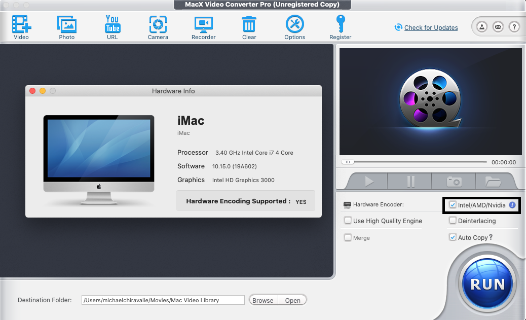

  • Intel Quick Sync is not enabled according to Mac X Video Encoder
Went over everything twice no but to no avail. Could be me since I'm not looking at it with "fresh" eyes anymore but maybe someone knows what I'm doing wrong here?
Edit: maybe try to install Catalina with Dosdude's post-install patches enabled and then fixing the known issues with legacy video afterwards?

The 2009 and 2010 I-series processors did not ever have quick sync, that was introduced in 2011 with Sandy Bridge.

still MacX does not show Hardware Encoder. why?
Come on Jeroen, you knew this... Haha anyway, thanks for pointing out the obvious.

EDIT: 4/17/20 An additional AppleIntelSNBGraphics.kext has been added to the pack to include board ID for iMac Pro/AMD-WX Series Config.plist. You can now have working sleep when your board ID is changed to 7BA5B2D9E42DDD94 to enable HEVC.
I am creating a guide linked to the first page to show how to reinstall HD3000 sleep kext as well as bring back Airplay and intel Quicksync rendering. This guide is exclusive to 2011 iMacs Running Mojave or Catalina.
  1. download Kext Utility from here http://cvad-mac.narod.ru/index/0-4 download Hackintool from here http://headsoft.com.au/download/mac/Hackintool.zip download and unzip my files at the bottom of this post for Mojave or Catalina.
  2. Move files to the desktop, (Catalina only) Open Hackintool, move to the Tools tab and click on the GateKeeper icon, enter your password and Finder should restart, this unlocks the System Partition.View attachment 885972
  3. Unzip the Mojave or Catalina files and unzip them to the Desktop. Drag Kext Utility into the same folder as the kexts. Drag the kexts onto Kext Utility, they will install but Kext utility will give a timeout error in Catalina, this is normal. You can reboot your iMac now, Sleep/Airplay should work. View attachment 885982View attachment 885983Part 2: Enabling Intel QuickSync for rendering using the IGPU.
  4. Since Mac OS Mojave, Apple changed the "AppleGVA.framework to longer be compatible with Sandybridge CPU's. To reenable QuickSync we have to reinstall a Private framework from High Sierra. The 'AppleGVA.framework' included works with both Mojave and Catalina.
  5. (Catalina) Use Hackintool to unlock the System partition as shown earlier
  6. navigate to /System/Library/PrivateFrameworks/ take the unzipped AppleGVA.framework and drag it into a blank area of the PrivateFrameworks folder. click "Replace" from the Finder popup. View attachment 885986
  7. Open terminal and enter the following:
    Code:
    sudo chmod -R 755 /System/Library/PrivateFrameworks/AppleGVA.framework THEN ENTER
    sudo chown -R 0:0 /System/Library/PrivateFrameworks/AppleGVA.framework
You can reboot now.
Optional you can download Mac X video recorder and check to make sure intel QuickSync is enabled.

I have figured out the slow boot issue in Catalina and allowing the HD3000 kexts to be installed along the "AppleIntelSNBGraphicsFB" that was mentioned earlier. Turns out you need to modify the IOSURFACE.kext file (File from @dosdude1 patcher, all I did was replace it within the kext) and install the patched iosurface.kext with the HD3000 kexts. Now I have a normal boot time and proper sleep/wake function.
I also added the AppleGraphicsPowerManagement.kext from the patcher, I have not done any testing yet if this kext has any improvement on MXM cards, but it's a newer version than the one from High Sierra 110.23.46 vs. 110.23.37
EDIT: looks like the AppleMCCSControl.kext should be added along with IOSurface.kext to prevent artifacts in Safari.
To install I use "Hackintool" to unlock the Catalina System partition to install, then drag all the files on top of Kext Utility to install. Alternatively you can open terminal and type
