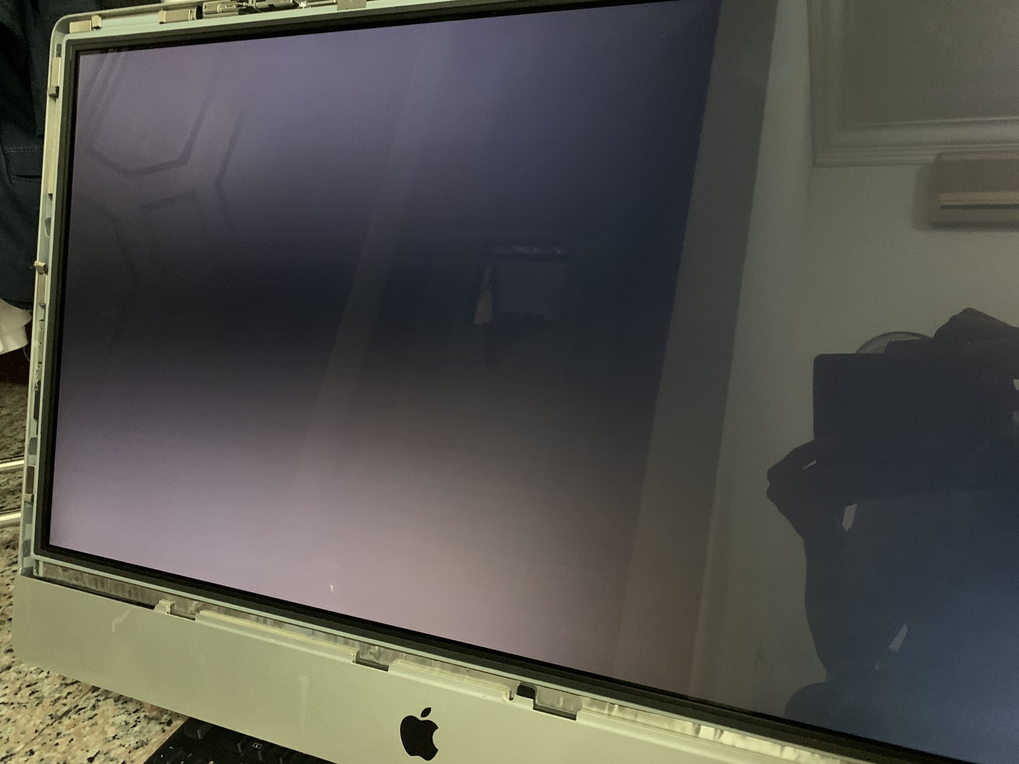

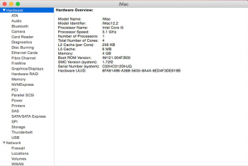

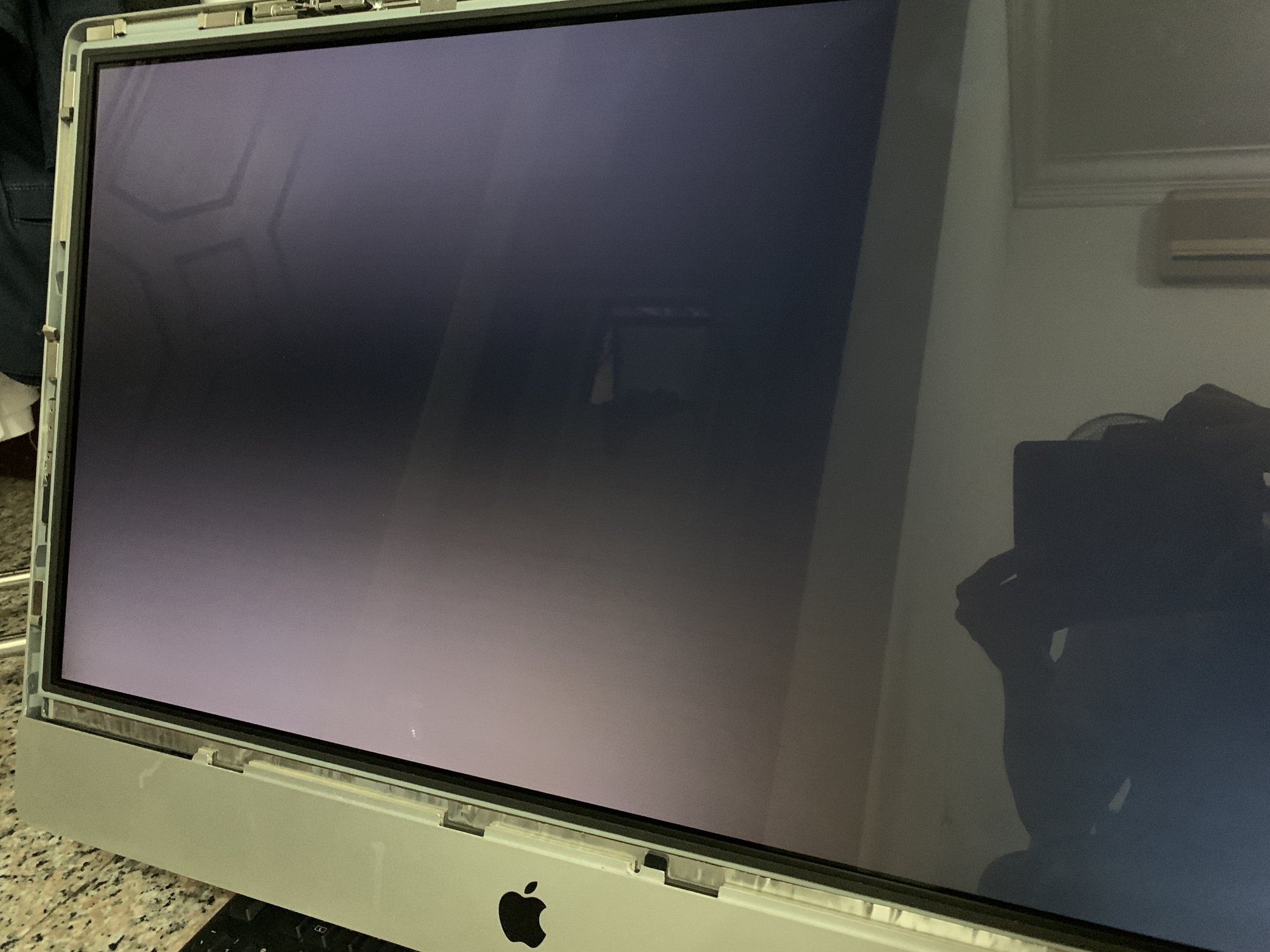

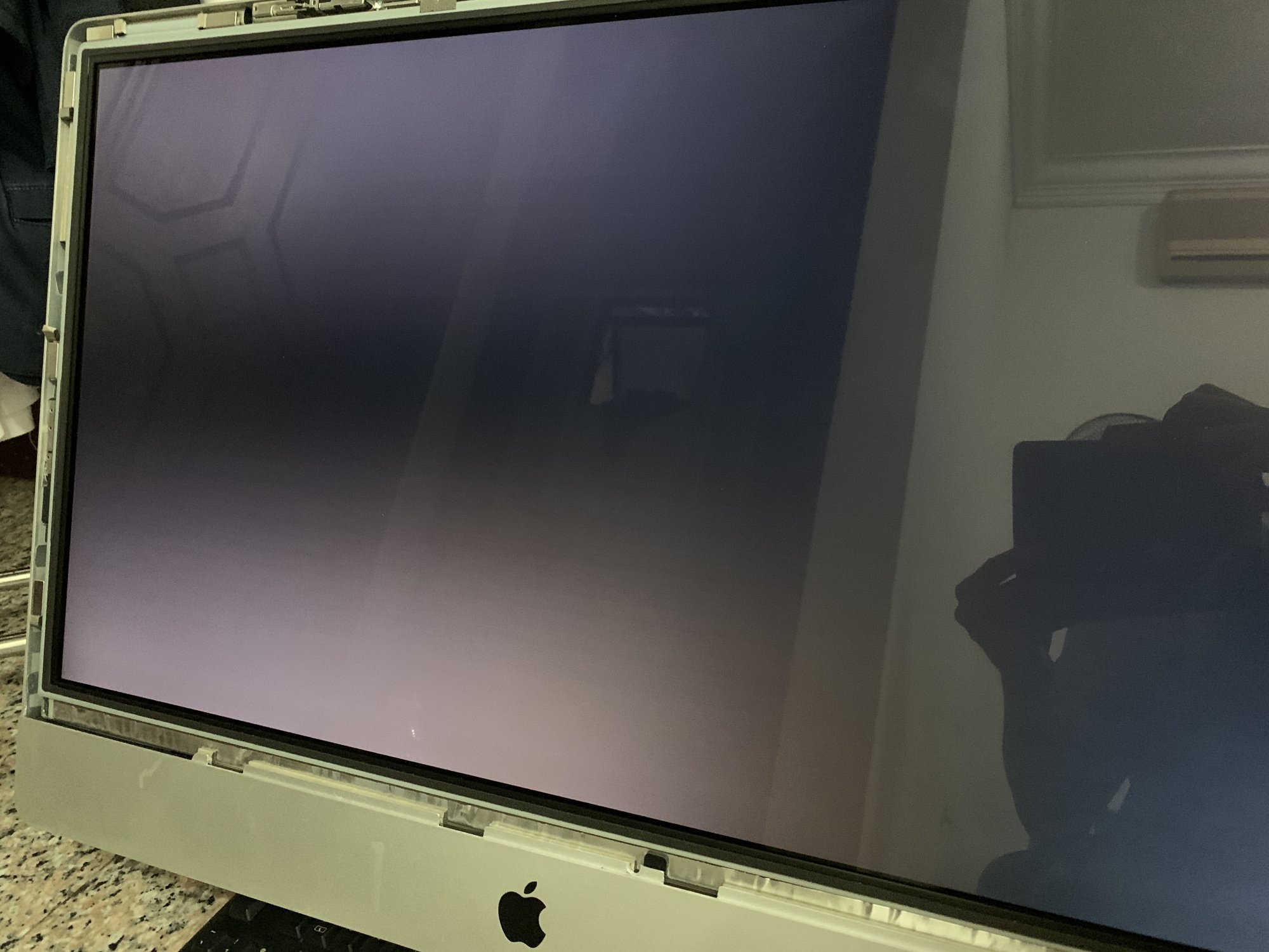

Hi, I was wondering if anyone can help me out. I have an iMac 27" mid 2011 i5 160GB HDD 4GB which I bought a K1000m to go along with. I know that the graphics card is working, as I have tested it on a iMac 27" mid 2010.
Problem
Upon installing the K1000m on the 2011 model, the display lights to a black screen. (It's lit up, but everything is black and will remain black). I have flashed the card multiple times to ensure that it's not a rom issue. Having screen shared from another Mac, we can see that the chipset is indeed Quadro K1000m by Nick, but the display is showing 23" 1280 * 1024.
Troubleshooting
I've tried replacing:
  • Display
  • Logicboard
  • LED board
  • HD with different os. 10.11.6 experiences kernel panic, and requires safe boot in order to screen share, whereas, 10.10.5 works fine.
  • Installed Nvidia web drivers.
I've read page one of this forum with people having black screens on 10.13.6 and higher with 003 update installed to install a modified kernel extension. Can anyone provide a detailed step guide on how am I going to do that.
Anyone has any encounter with this issue? Kindly provide your valuable advice. I've attached some photos/screenshots to this post.

You do not even have Sierra which is to my knowledge the first OS where people observed the "black screen issues". So I do not know what is your plan with this machine is right now.
If possible - I would go on to High Sierra and getting the last firmware update to get the machine ready for APFS and Mojave and Catalina, later. After the plain installation of High Sierra your system should work fine, the black screen comes with the 003 update published in June 2020. Having High Sierra you have the Nvidia drivers included with the OS.
Installing a kernel extension has been documented several times here and in other threads, there is a search button to look it up. I have no experiences with 10.10 or 10.11 on this type if upgraded iMac - most of us did the upgrade because we are moving on the more recent OS versions.

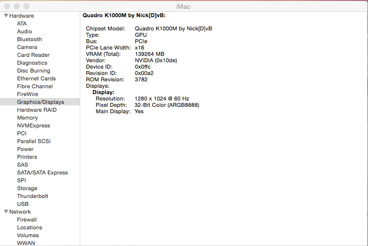

:apple: At the moment I like the Quadro K2000M in my 27" IMac (2011 i5 3.1Ghz - 16GB - 250GB SSD - 500GB HDD) :apple:
...Unigine Valley scales with CPU (I think) so I have sometime more than 40 frames / sec with about 50 degrees
Celsius, 😄 I buy this card from ebay computer store as K1000m for 45€ 😄 LOL

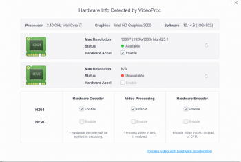

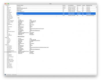

Do NOT use the Lilu/WhateverGreen from my installer, they are outdated. Just verified functionality by using a New whateverGreen/Lilu. The same goes for OpenCore users too. These kexts always need updating with OS versions. I'll attach another 10.13.6 GVA framwork as this one might be newer than whats on the old post too. For WEG/Lilu please download them here https://github.com/acidanthera/whatevergreen/releases
  • hs.zip
    hs.zip
Reactions: 0607557 and jovonov

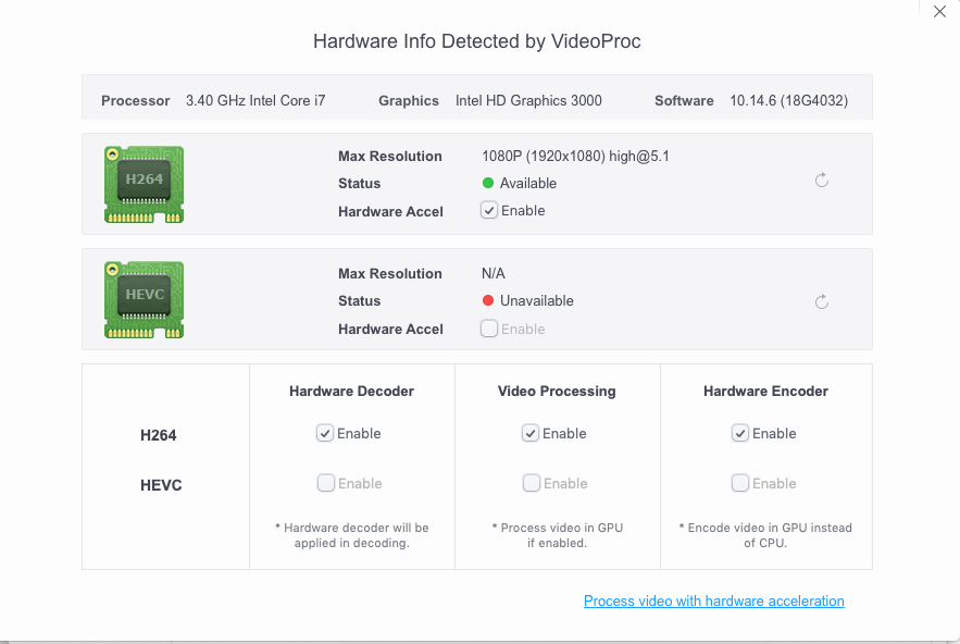

However, I still don't get H.264 acceleration. I downloaded the latest versions of WEG and Lilu kexts from github and ran them through the Kext Utility. I verified in the system report that they are the latest version.
Then a reboot.
Next i copied the new AppleGVA.framework to the System/Library/PrivateFrameworks. Ran the two sudo commands, another reboot.
Still no hw acceleration 🙁

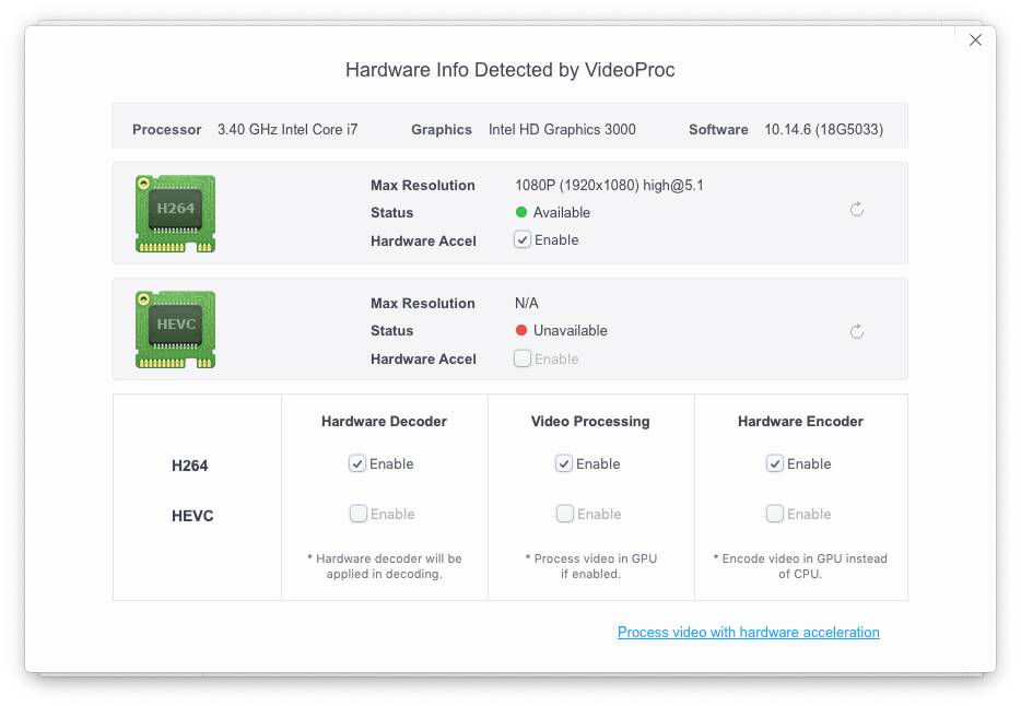

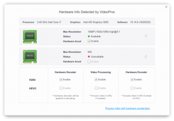

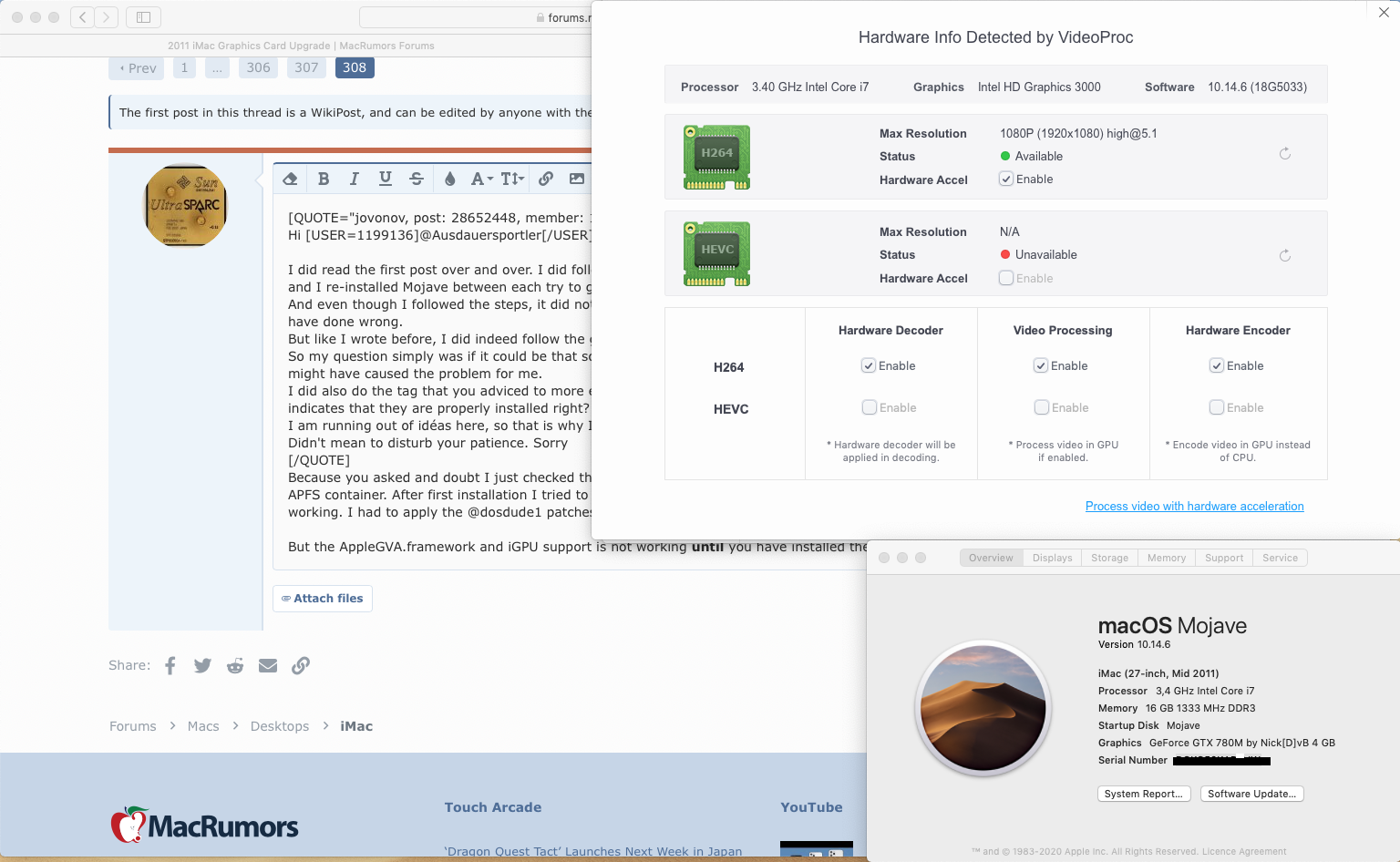

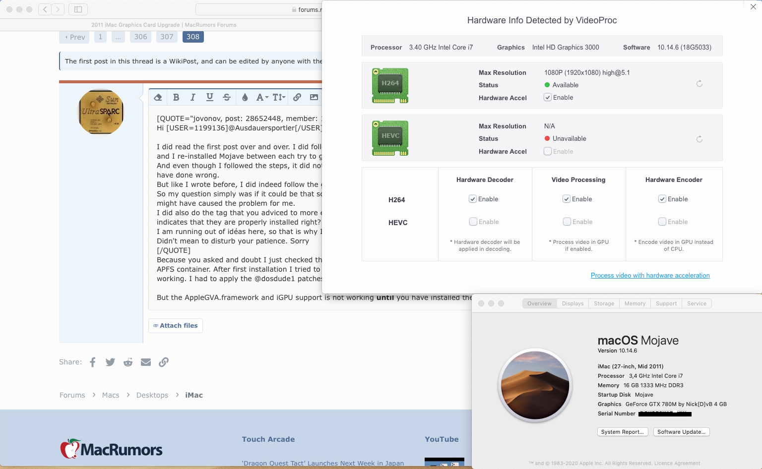

I installed the latest security update 18G5033 and still have h.264. Had to to replace AppleGVA again. Are you running the correct commands in terminal?
sudo chmod -R 755 /System/Library/PrivateFrameworks/AppleGVA.framework
sudo chown -R 0:0 /System/Library/PrivateFrameworks/AppleGVA.framework

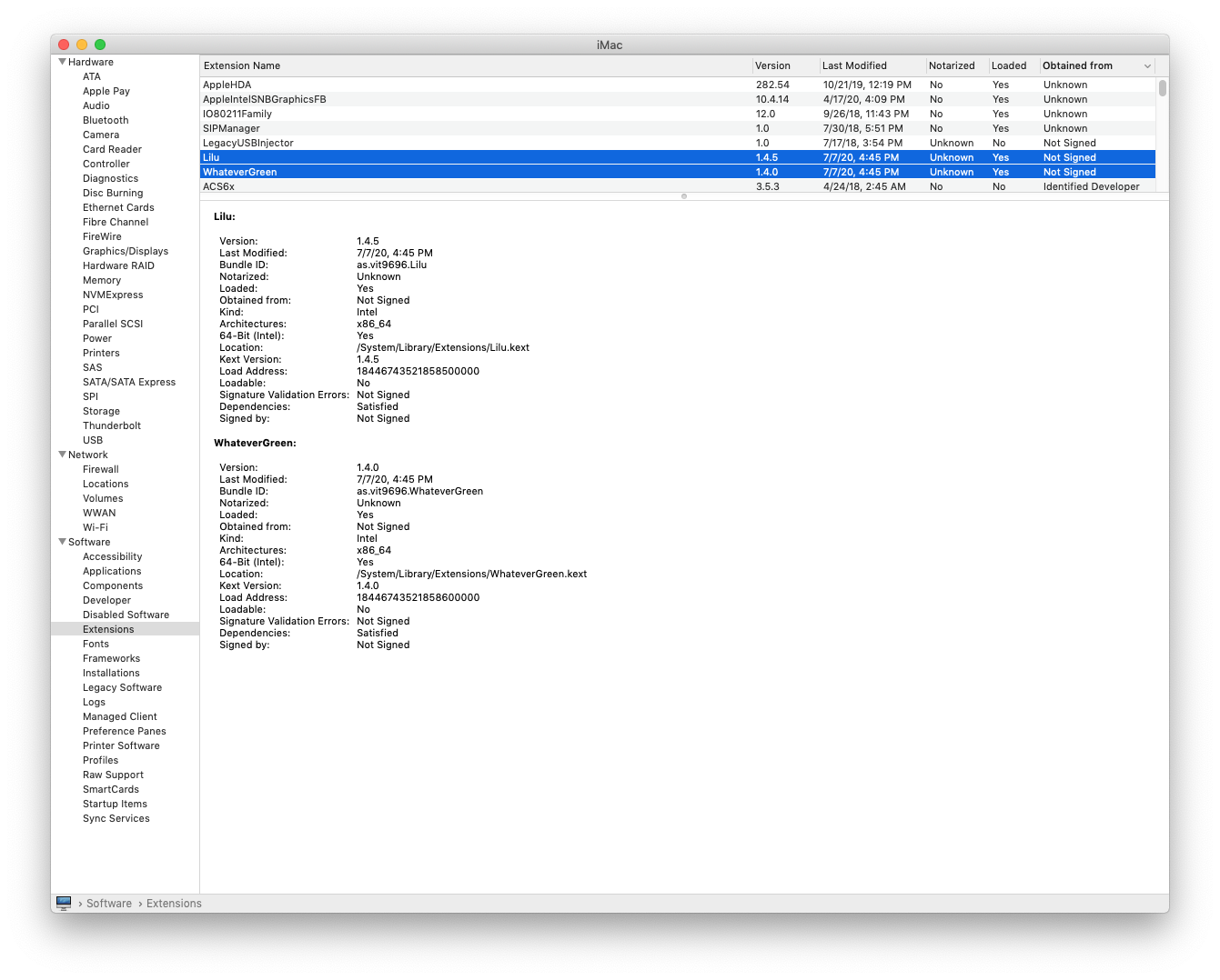

You have working sleep correct? These kexts need to be in System/Library/Extensions
  • AppleIntelHD3000Graphics.kext
  • AppleIntelHD3000GraphicsGA.plugin
  • AppleIntelHD3000GraphicsGLDriver.bundle
  • AppleIntelHD3000GraphicsVADriver.bundle
  • AppleIntelSNBGraphicsFB.kext
  • AppleIntelSNBVA.bundle
  • Lilu.kext 1.4.5
  • WhateverGreen.kext 1.4.0

Try at least to follow the guide and redo until you have success.
The original post published by @highvoltage12v linked from the first post on the first page gives you a step by step installation guide. Just follow this, we cannot remote control your mouse or keyboard. Yes, there is a simple way of checking the success: sleep and h.264 will work after correct installation. I tag the files with a color to find them later more easy in the folders.
Hi @Ausdauersportler , thanks for answering.
I did read the first post over and over. I did follow the guide thoroughly. In fact I did the same procedure over and over and I re-installed Mojave between each try to give it a fresh installation.
And even though I followed the steps, it did not work for me so I turned here to ask for help or advice on what I might have done wrong.
But like I wrote before, I did indeed follow the guides (I always do) without success.
So my question simply was if it could be that something in the guides was interpreted incorrectly by me, and that this might have caused the problem for me.
I did also do the tag that you adviced to more easily find the kext and I can see that they all have todays date, which indicates that they are properly installed right?
I am running out of idéas here, so that is why I turned to you guys for more advice.
Didn't mean to disturb your patience. Sorry
How could we help other than provide you with a step by step guide? If something goes wrong following such a guide there are two possibilities: The guide is bad or the user made a mistake. We cannot check your mistakes, because nobody can see what you have really done. This is my point. In principle there is no other way than pointing out the guide, again. And you have not asked if something is wrong with the guide or the extensions published there, you have not even asked for other Mojave users experiences. I did the Mojave installation on a mid 2011 several times in the past seven month. The only thing I do not know is how it works after the latest security upgrades. Have you installed the latest security patches from May or June, 2020? The more precise you describe your problem and setup, the better the support can be. A simple „it does not work“ does not help.
Recently user @Wania did the installation with success, another hint that the guide is and files are probably still correct.
EDIT:
Just did the upgrade with the latest security patches on Mojave and sleep still works, unfortunately I have on this machine a WX4170 installed, so I see only the 4K H.264 provided by the card, not the iGPU support. Have to find a Nvidia based system.

Because you asked and doubt I just checked the functionality with my 2011/780M system installing Mojave in a separate APFS container. After first installation I tried to install @highvoltage12v patches and succeeded at least to get the sleep working. I had to apply the @dosdude1 patches to get audio and Unigine Valley running, again.
But the AppleGVA.framework and iGPU support is not working until you have installed the available (latest) Apple upgrades for Mojave. This introduces the "black screen on boot" issue, but a solution for this has been published, too.
