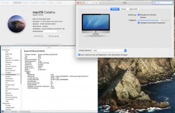

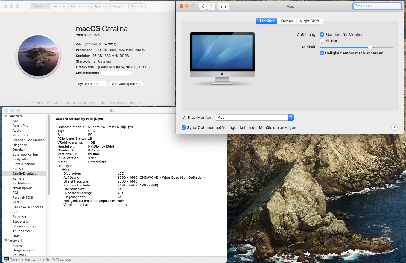

I can confirm the K610M is working just fine with my 2011 27" iMac and Catalina latest using the original Catalina Loader. You probably messed something up?

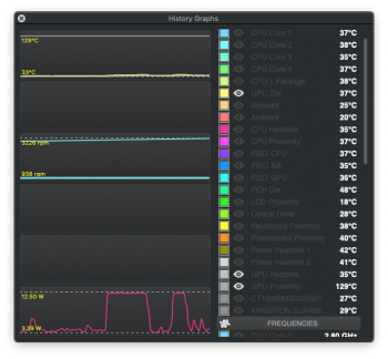

One thing I've noticed in HWMonitor, the GPU die temp looks fine, but the GPU proximity temp is very high and not updating (screenshot attached). Anyone know where this sensor is? I didn't see any more loose cables when I checked. Maybe it's not one that actually exists?
Again, sorry if I'm missing something in the guides and asking people to repeat themselves.

129 means no infos from probe.

Yes GPU Proximity is a useless/unused value. GPU Die (with FakeSMC/ plugins) and GPU heatsink are all that matters.

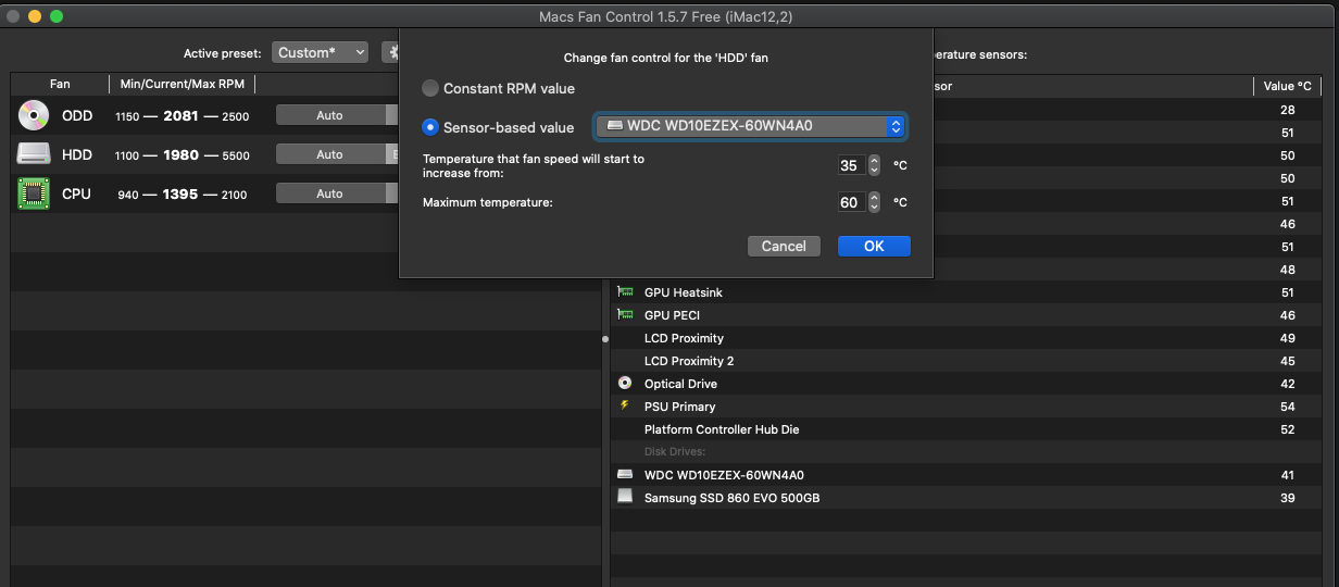

Just download mac fan control and set a custom limit for the hdd sensor, this is the setup that I run:
Note that my settings are based in the safety data from WD.

Perfect, thanks guys! I was just downloading Macs Fan Control as it happens; that's done the trick, spot on! :)
