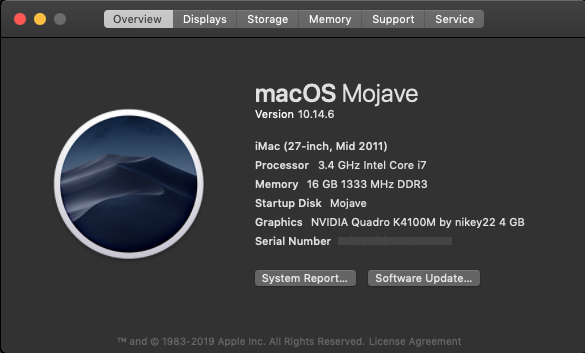

I finally got my K4100M card in my 2011 27" iMac working. First card was not correct. The second card I got which was a Dell turned out to be bad. Third time was a charm and the replacement card worked the first time.
Here are the lessons learned from this experience:
  1. Do not use HP versions of the K4100M card. Something is different about them and they don't work.
  2. The Dell version of the K4100M cards work.
  3. I learned how to completely disassemble this iMac having taken it apart and reassembled it about 18-22 times in total.
  4. Just put a little pile of K5 compound on the tall square areas, just enough to fill the gaps.
  5. Don't do this work when you're exhausted - too many opportunities to make mistakes which causes more problems.
  6. On the bootable USB image, the scp command - that is to be run from your local machine, not the target iMac that you ssh'd into. Run it in a terminal on your local machine.
  7. This took about three days to do, don't take up kitchen space if you don't want your wife to be pissed off at you.
  8. I love my iFixit toolkit. It came in so handy for this job.
  9. The Linux USB image is the way to go. Super convenient and pretty easy if you're familiar with ssh and such.
  10. Did I mention to stay away from HP versions of the K4100M? Steer clear of them, they don't work.
Thanks to this thread and all who helped me through this process. I really appreciate it. I think I had this thread bookmarked for well over a year waiting for a card that worked better than the existing cards did. Finally the K4100M came to the working list and I was all over it. Thanks again to everyone and @nikey22 for the firmware that allowed this to happen!
