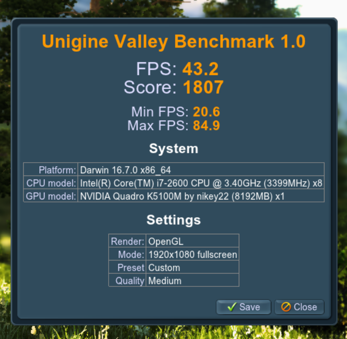

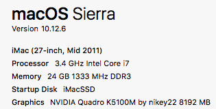

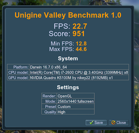

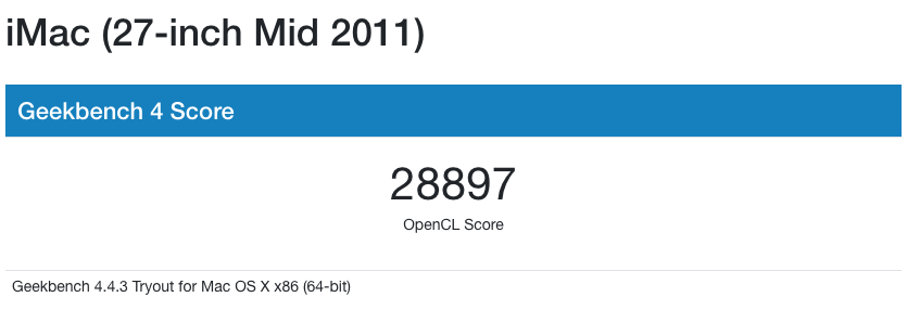

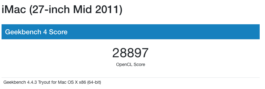

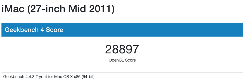

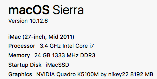

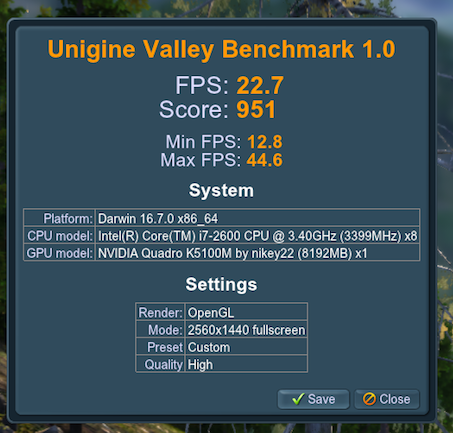

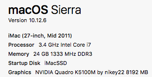

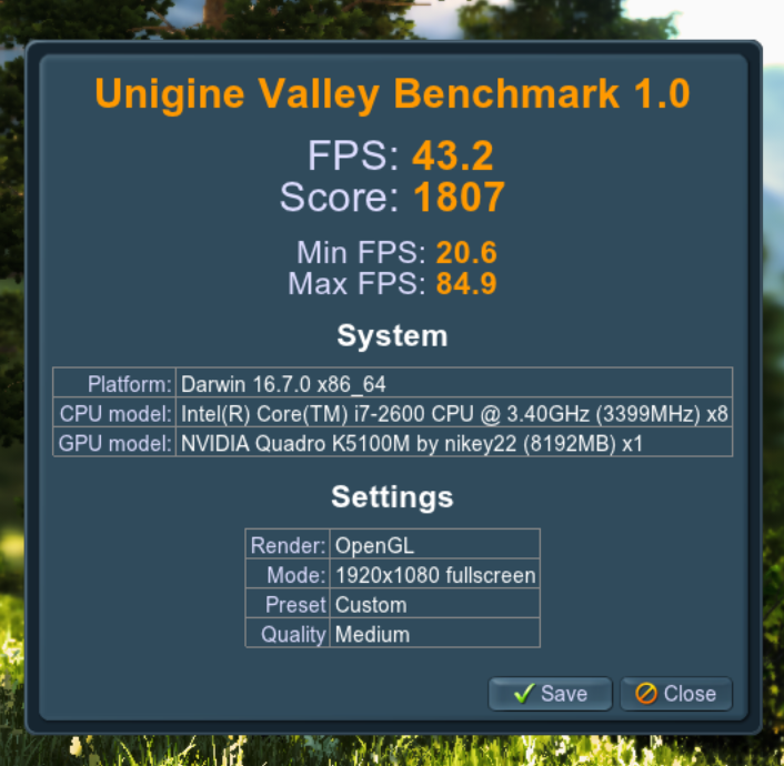

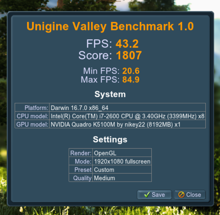

I never did update on the GPU upgrade
Used the k5100m card. and the @nikey22 vbios flash
It was great success!
Thank you @ZenSurfeur for guidance on how to run ssh into the mac and properly do everything.
Also to flash I used the usb linux boot method from @xanderon
Also fixed brightness issue with proper kext file with Hackintool
View attachment 948067View attachment 948059View attachment 948060
.View attachment 948058

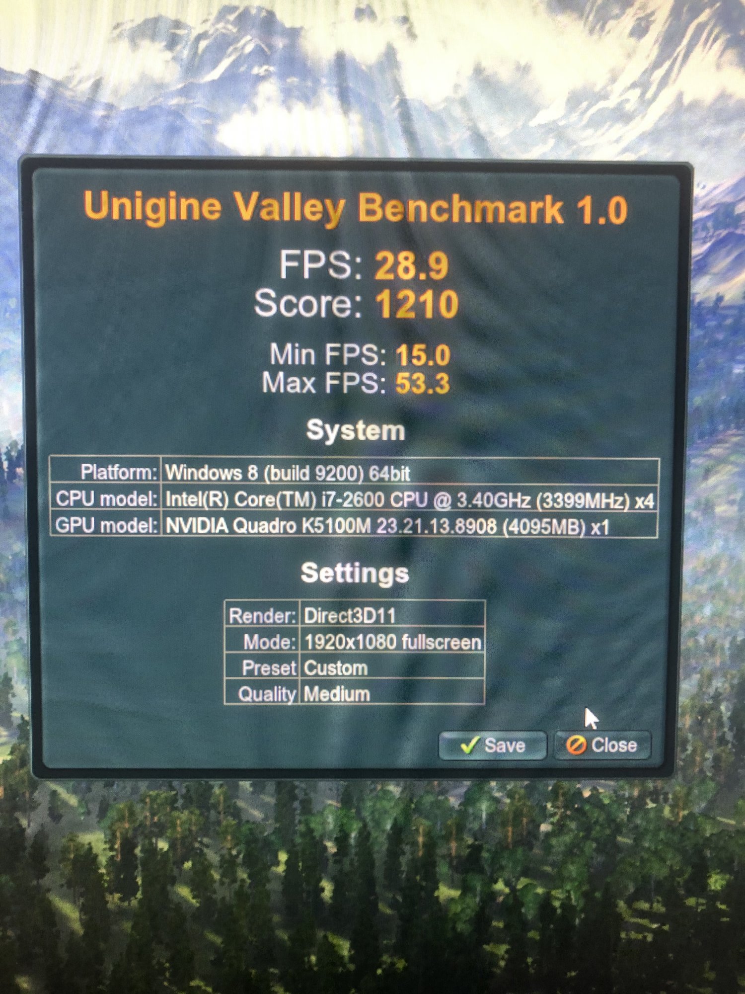

Currently running Windows on a completely different SSD from my macos and once steam is done downloading I'll get a valley score.
UPDATE:
So upon getting a game and valley downloaded and running both I noticed something interesting in valley...
I doesn't say the OS as Windows 10 home... which is listed as the OS in the systems from the start menu.
It notices the gpu but only half of what it actually is... but when I look up the gpu from the start menu it comes up at the full 8gb...
Valley scores were actually lower on the windows side of things
