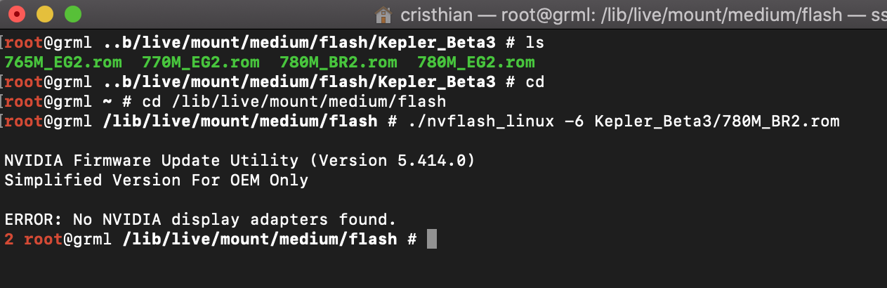

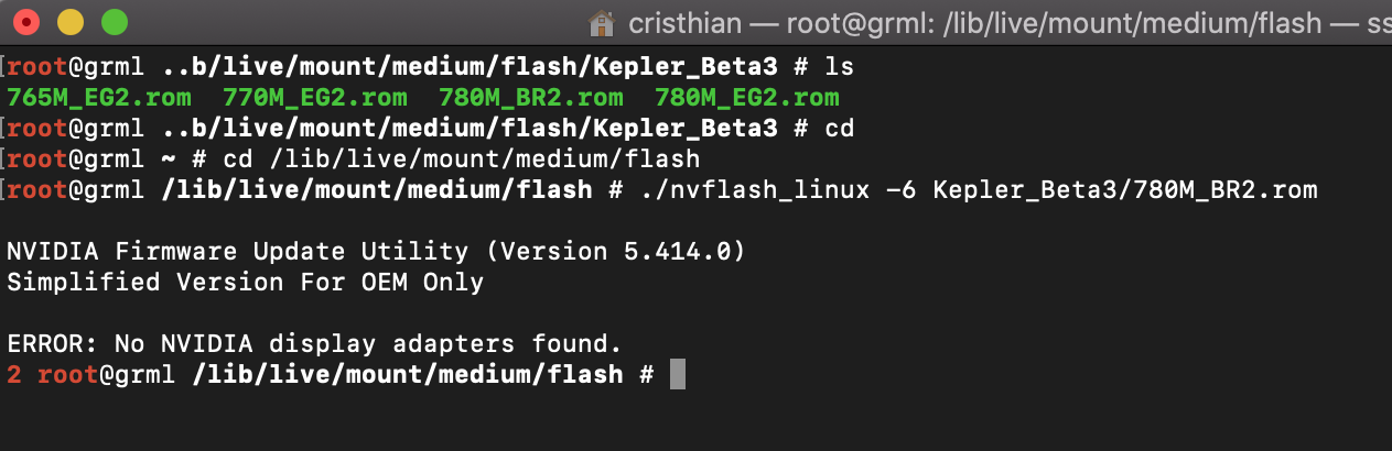

This is unusual. If you correctly seated the card in the slot you should get a feedback using the nvflash...

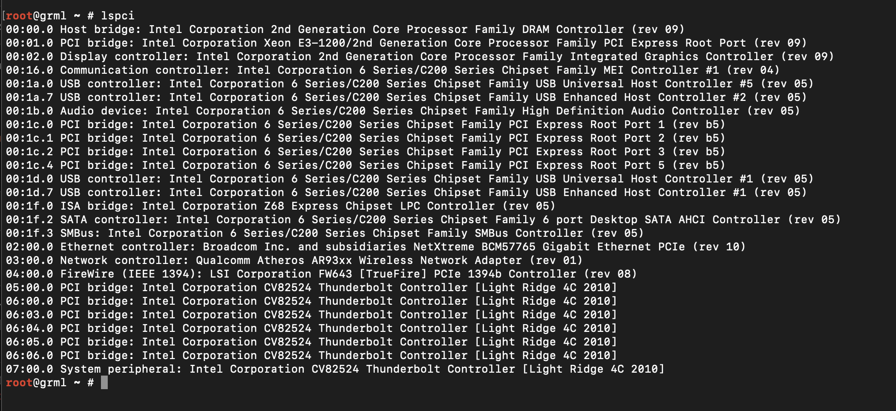

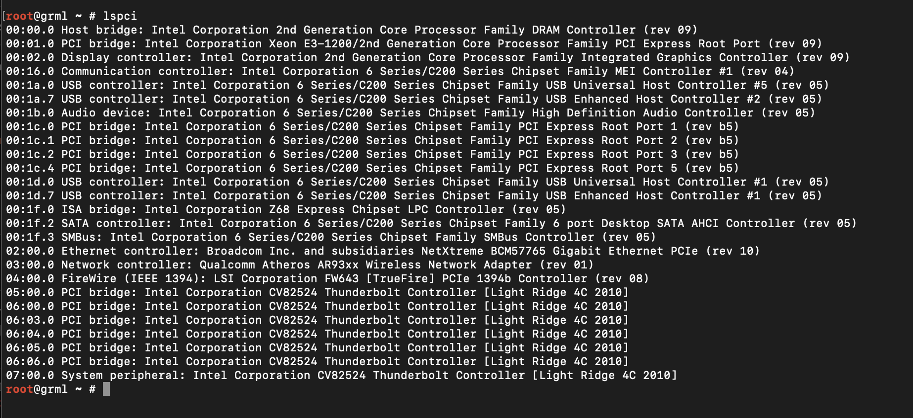

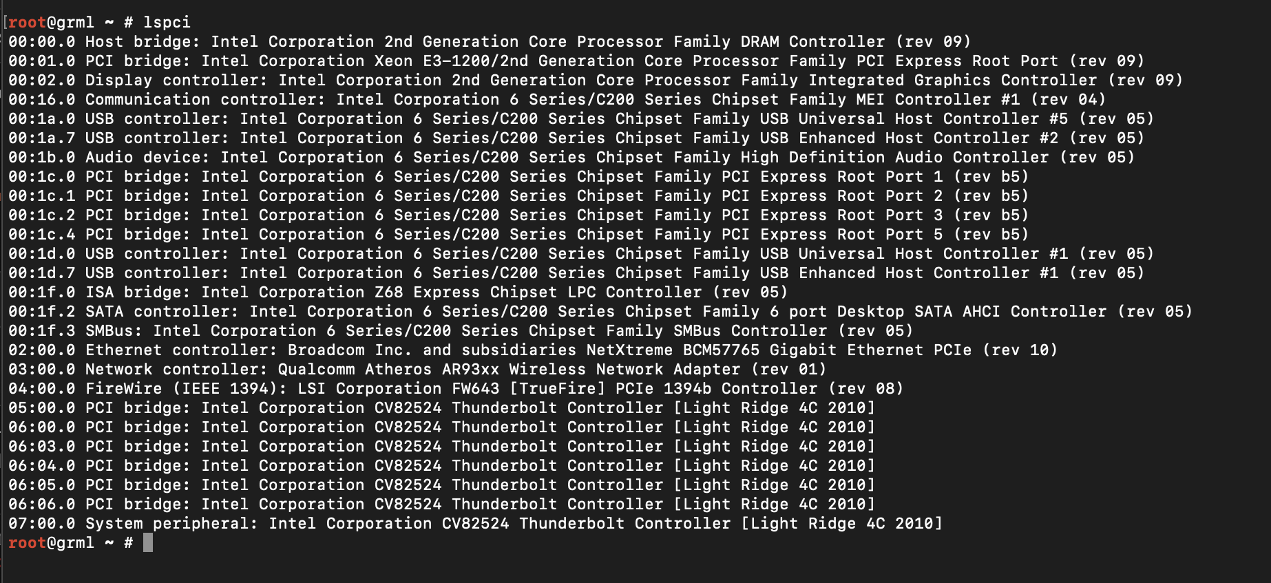

Use lspci within Linux to list recognized devices.
A clip does not help if the card cannot be seen ...
Thanks for replying, I got this
If that works out I see no chance for cards having a WSON type BIOS chip...
After several attempts it manages to flash the card, I had to unmount and connect everything again and it was possible to flash through SSH, now it turns on and the system startup sound and black screen are heard several times (I have a backlight), it has a SSD without operating system. Could you help me with what I should do to have the option to install catalina. Thanks for your help

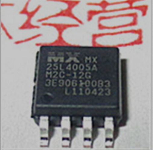

MXIC vs WSON BIOS Chips - HP WX4150 (4GB)
after controlling unsupported BIOS chips on CH341A Programmer I found this
item on ebay (longsheng-electronic). With test installing, soldering and patch
with original APPLE AMD BIOS this on an old HP ATI HD6770 card I can tell you,
that if you have compareable ATI cards from HP, APPLE BIOS would not running
in an iMac...
MXIC BIOS Chip 25L4005A - US$ 2.70
It can be that various intel based Notebooks boot Video card
with mainboard-based BIOS and only important if anybody plan
to use a HP WX4150 which are now on ebay with prices of
about 60$ - don't wonder if it doesn't run - but almost a
good product for resale... ;)

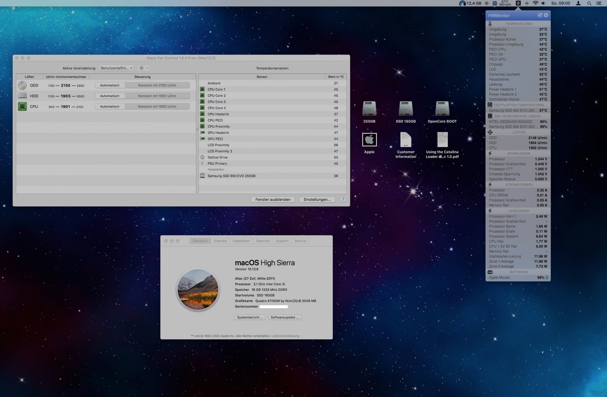

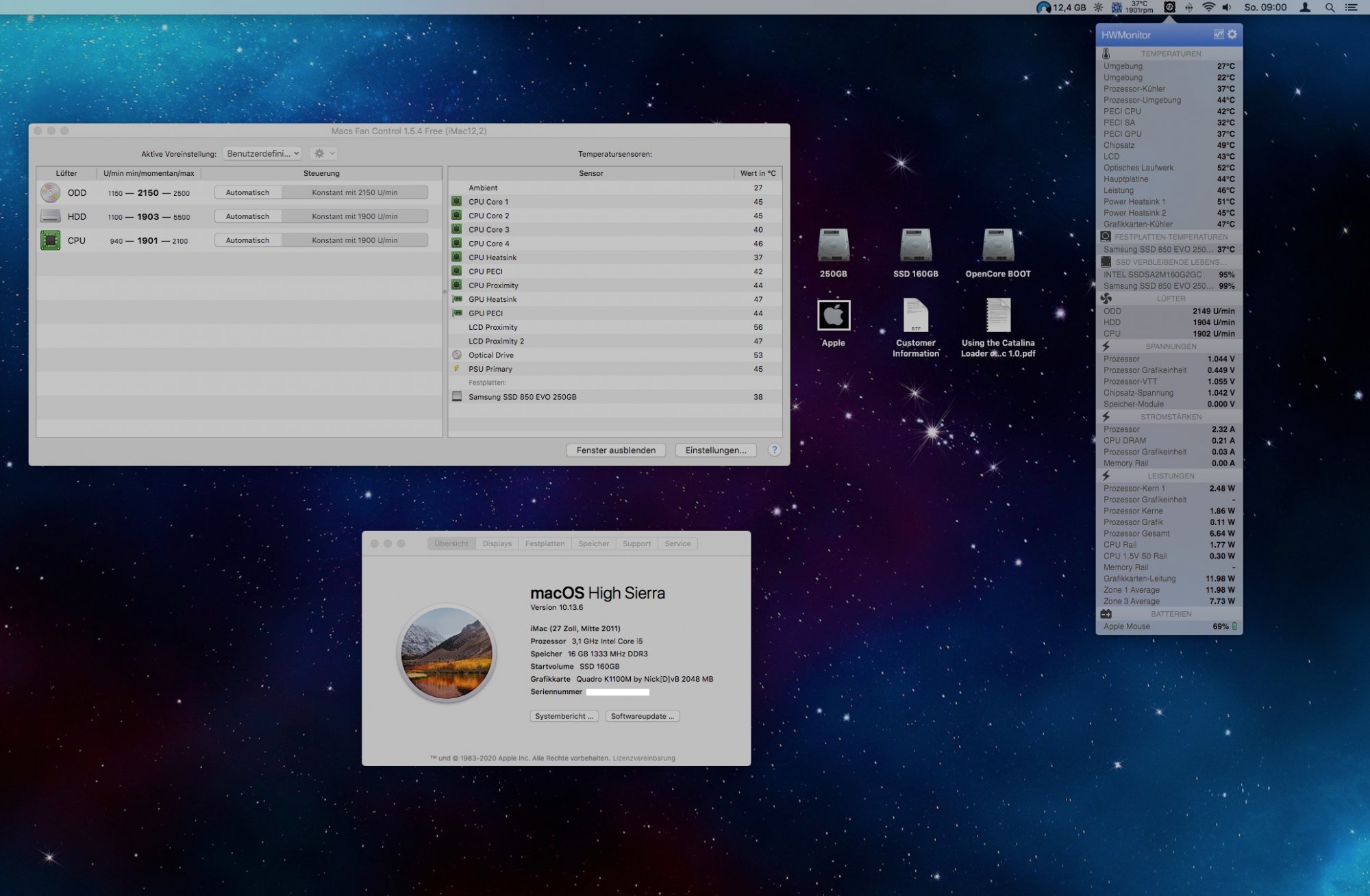

Wheather forecast: it going to be hot - actual temperatures inside...
(...it's a rainy day at 9am and my iMac is deep breething - wake up, buddy !)

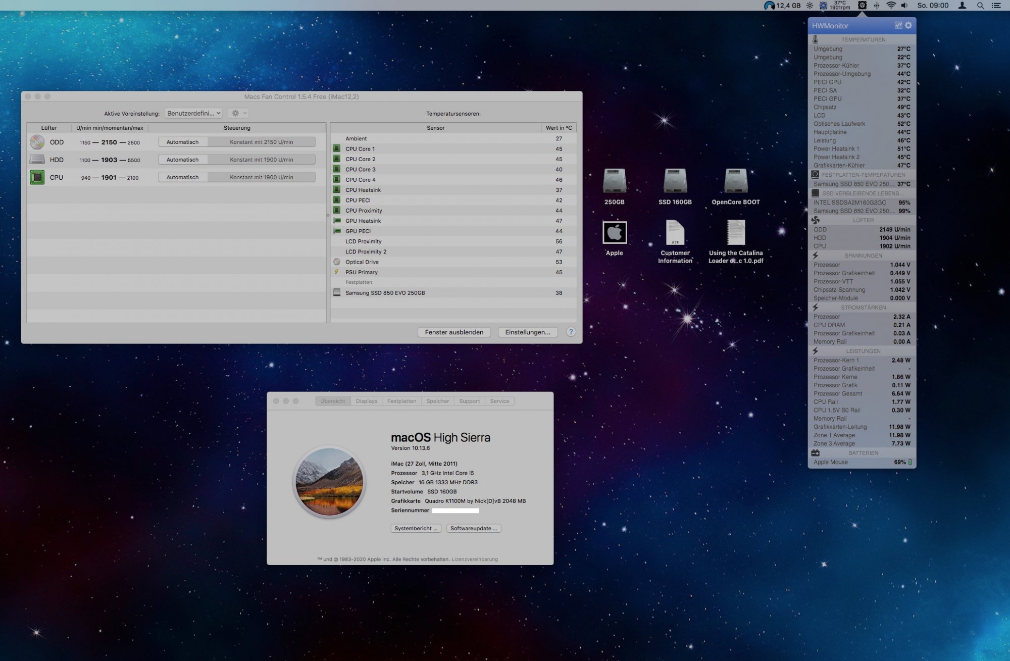

Thanks to Brightness Slider, the pic is a little bit pale - the ODD temp resistor is fixed near the Video card !
