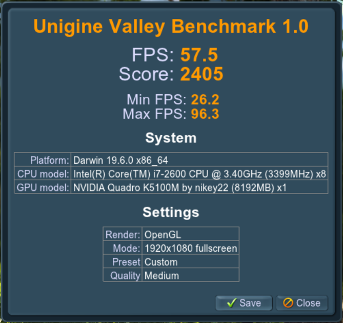

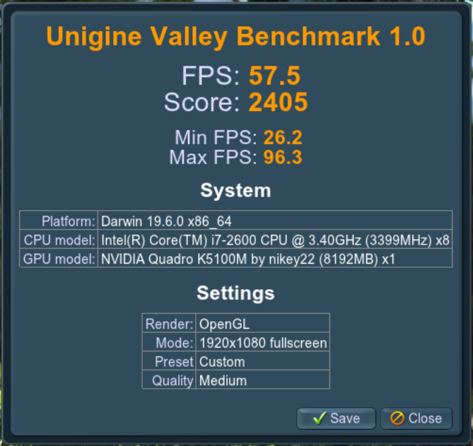

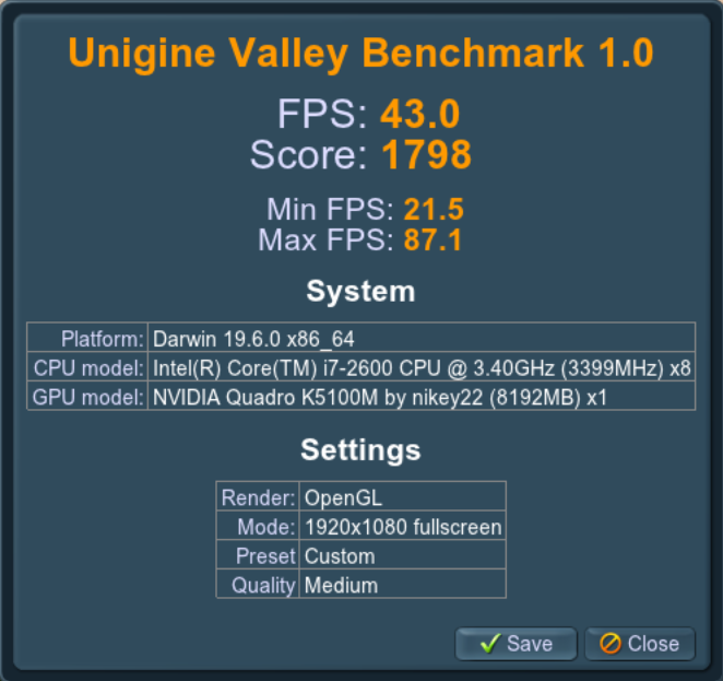

Overclocking the Ram at 2200 (1100 real) works very well there I am at 1045.5 for the GPU, 1006 max recommended.
throttling with Valley, I think the Ram is not cooled enough, I would take care of this problem from time to time.

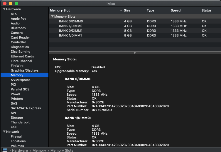

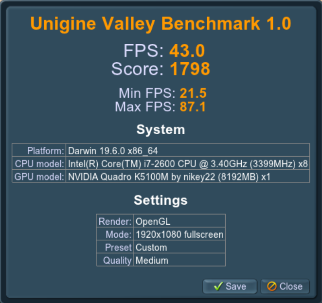

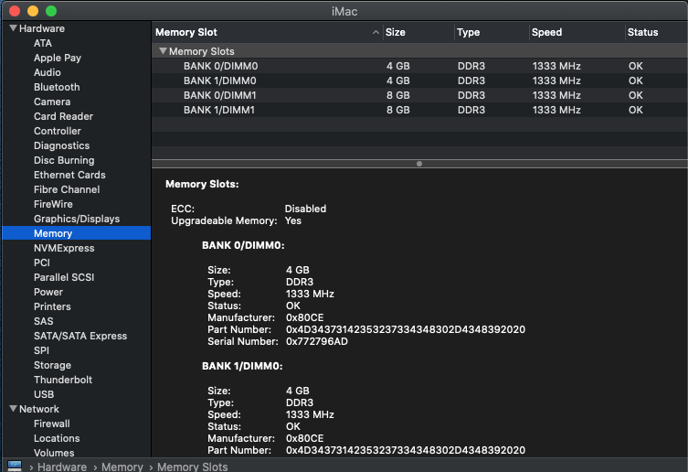

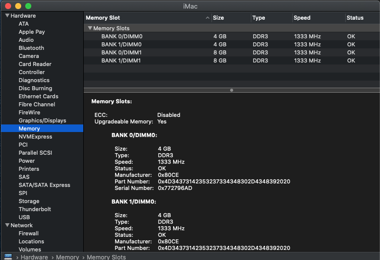

The good configuration to exploit the Dual Channel to get the best performance is “by DIMM” meaning to have same RAM sizes in same DIMM number so your installation is good. You may try to invert the modules.
Done.

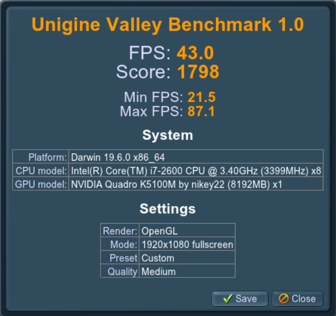

Didn't change performance on valley.

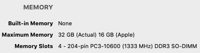

What could be causing this lack of performance or restriction?
Could it be possible the GPU is not getting enough power?
Or would it just be 24gbs of RAM vs 32gbs?

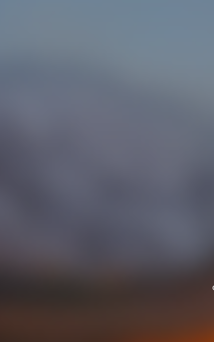

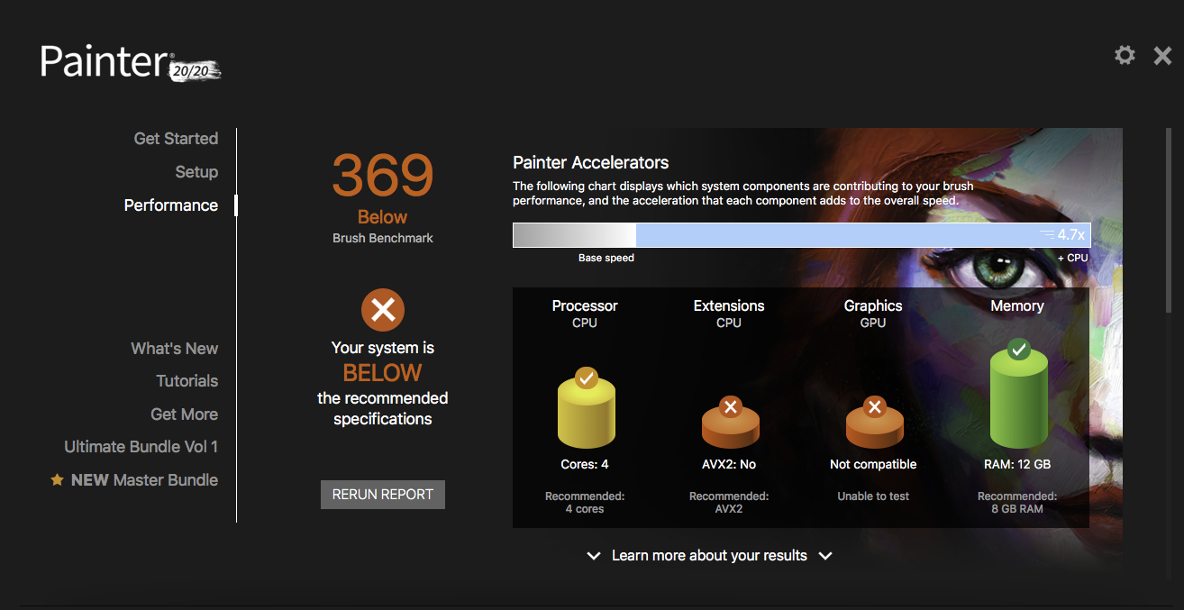

I've tried to reset pram and replace 6770 with 880m. Then Also did smc and pram reset. It works but display color looks so choppy. Is it possible to fix it? High Sierra installed.
Also Adobe Painter didn't recognize card at all.

Did you run Apple Hardware Test (AHT) to rule out a faulty sensor that might be causing throttling?
Just ran it and got No trouble from the test.

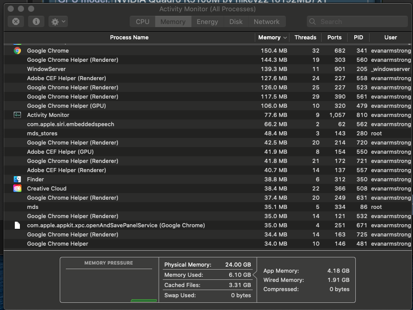

I have just tried with only 16Bg ramView attachment 952091
Well that eliminates RAM being the issue.

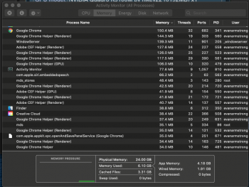

Is there any program I could run that may give a clue as to what's causing the restriction?
Could these potentially be the problem restricting
Did you run the benchmark after a sleep cycle?
I did not. Upon startup

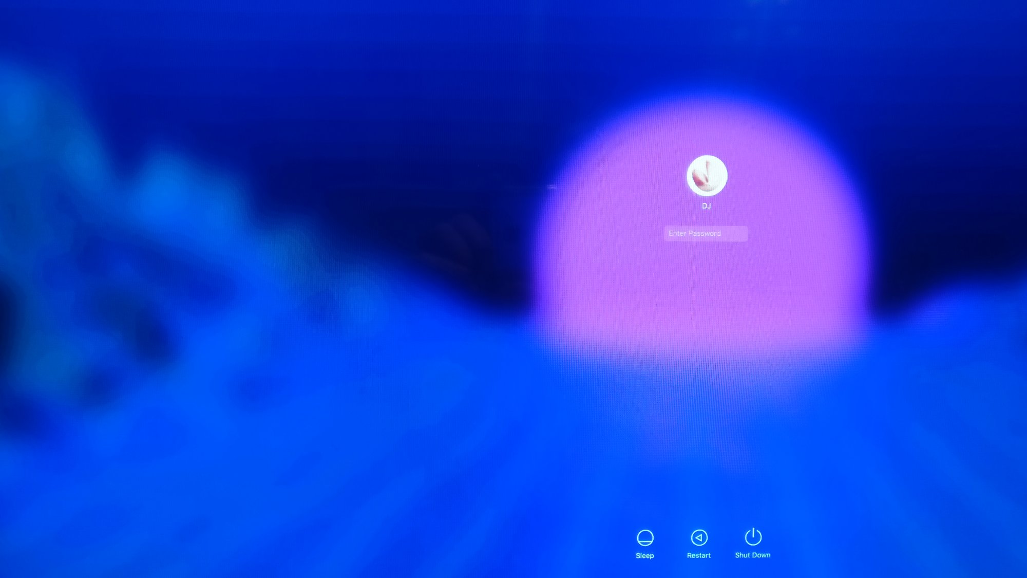

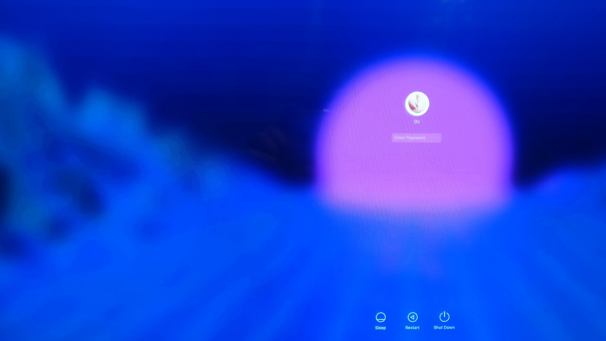

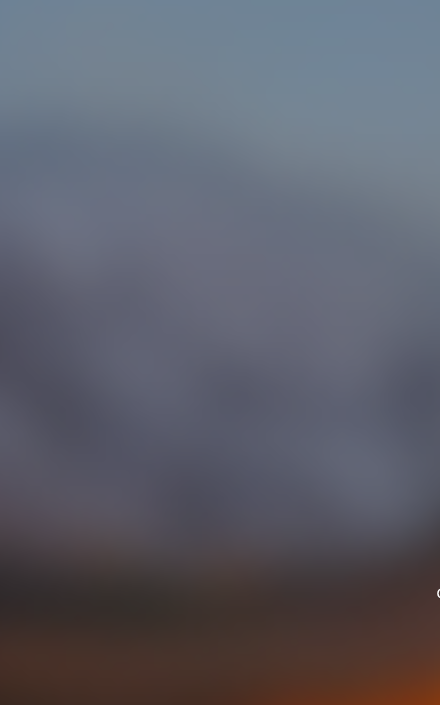

I noticed that on the login screen on both Sierra and High Sierra.
Didn't notice it on Mojave or Catalina
Using a k4100m here and the login screen on HS does indeed look choppy, was already wondering what could be the cause of this. Once logged in all works fine.

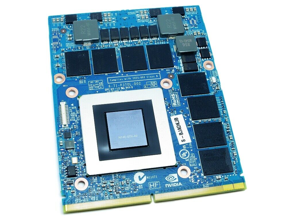

Hello, I installed this GTX 780m in a 2011 - 27" iMac but the 3 led that indicates the communication between the GPU and the motherboard don't turn on (only 2 led on). Has anyone had this problem with this card?
Again: did you flash the vbios available on this forum?
on my first iMac 27 mid 2011, I bought a 780m witch was used on a HP. Same as you, 2 leds. After flashing new bios, waited about 40 seconds (first time) then everything’s working...

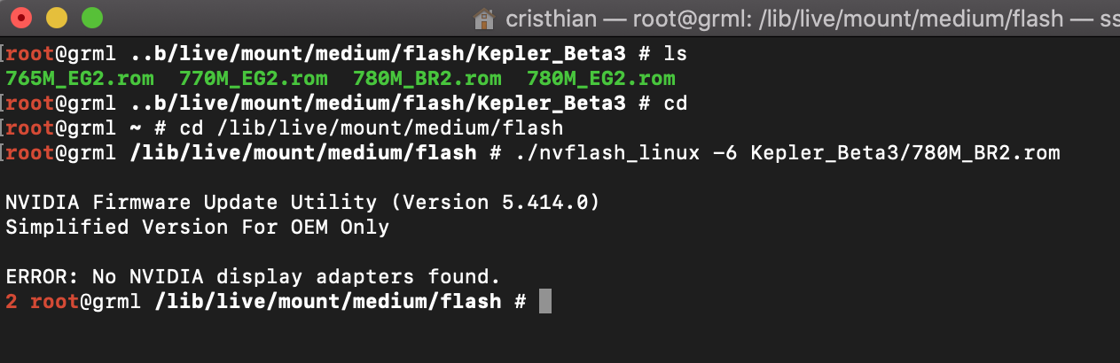

Thanks for answering, I have followed the forum for a long time and read the process many times, I tried to flash the ROM via SSH with linux but it does not recognize the card, my question is whether there is difference in using a 780 from Clevo or one Dell
