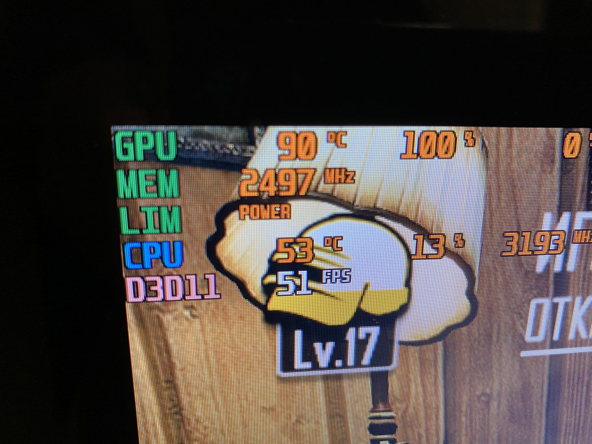

I have 880m with BIOS from the table from the first page (nikey 22), radiator I use from 6970 with 3 tubes. I use windows via boot camp for games, the temperature reaches 90+ degrees. On Mac OS High Sierra, I can't track the temperature because Macsfancontrol doesn't see the video core sensor. In the benchmark the radiator heats up above 75 at maximum fan speed
I have 880m with BIOS from the table from the first page (nikey 22), I use windows via boot camp for games, the temperature reaches 90+ degrees. On Mac OS High Sierra, I can't track the temperature because Macsfancontrol doesn't see the video core sensor. In the benchmark the radiator heats up above 75 at maximum fan speed
It's to much, there is a problem.
Macs Fan Control will run with Windows and MacOS and you can use the Heat Sink Sensor to control the fans. This has been mentioned more than one time...
MACS Fan Control будет работать с Windows и MacOS, и Вы можете использовать датчик теплоотвода для управления вентиляторами. This has been mentioned more than one time...
I have configured radiator management by the heat removal sensor in MacOS, in Windows on the GPU (Windows sees the GPU temperature). The problem is that the video card does not cool down even at 2500rpm ODD fan.
Than your ambient temperature is probably too high. I do not have this problem. But the worst thing I do with this card is running Valley 2h...

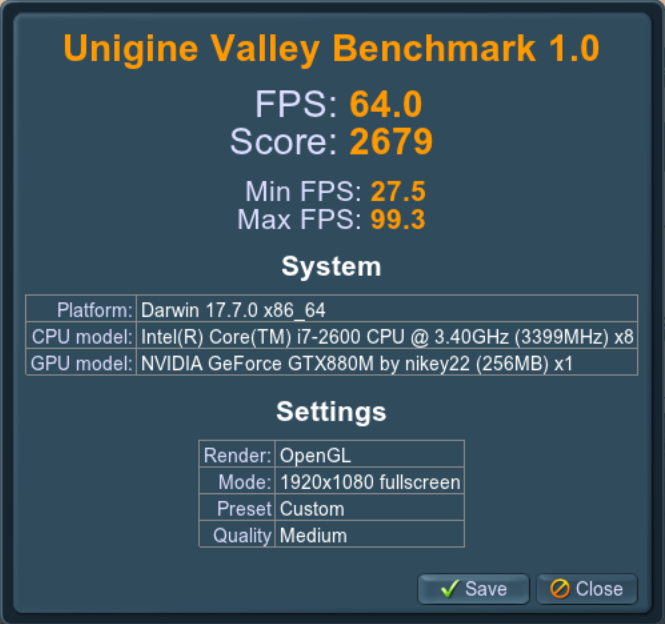

Just wanted to THANK YOU all for everything that goes on here. Just upgraded my 2011 27'' iMac to a GTX880M following all the instructions here and on Curtis video and BOOM! Now I'm rocking an 8gb graphics card with boot menu and full brightness control. Thank you @nikey22, @xanderon and @Curtis Gross and everyone else that dropped nuggets of knowledge here and there. You are all rock stars, THANK YOU!

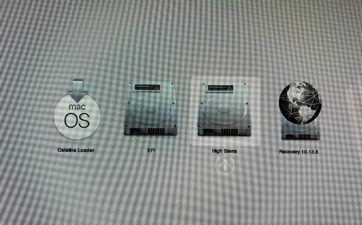

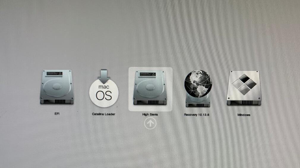

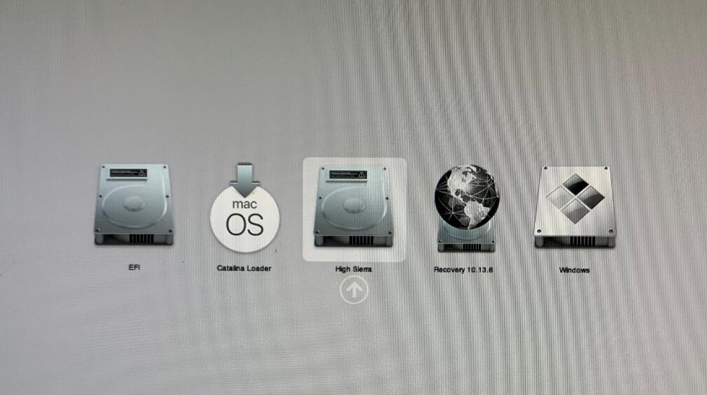

Hi all, I may be missing something simple, so forgive me if so.
I have a iMac 11,3 27”. I put in a K1100M. Updated VBIOS. Have 10.13, 10.15 and Windows 10 installed. Using open core. The speakers chime at boot but do not work in any OS. I have tried removing and adding the legacy audio patch in Catalina patcher a few times. No luck. What am I missing? Speakers should work? Everything else seems good.

After install the patch, have you try to rebuild the kextcache?
  • sudo kextcache -i /
No, you won't get a picture on the stock vBIOS without a back-light mod,
AMD users should flash the GOP vBIOS attached, you can do it from windows.
Then use OpenCore to get boot-screen and brightness control with no other mods!

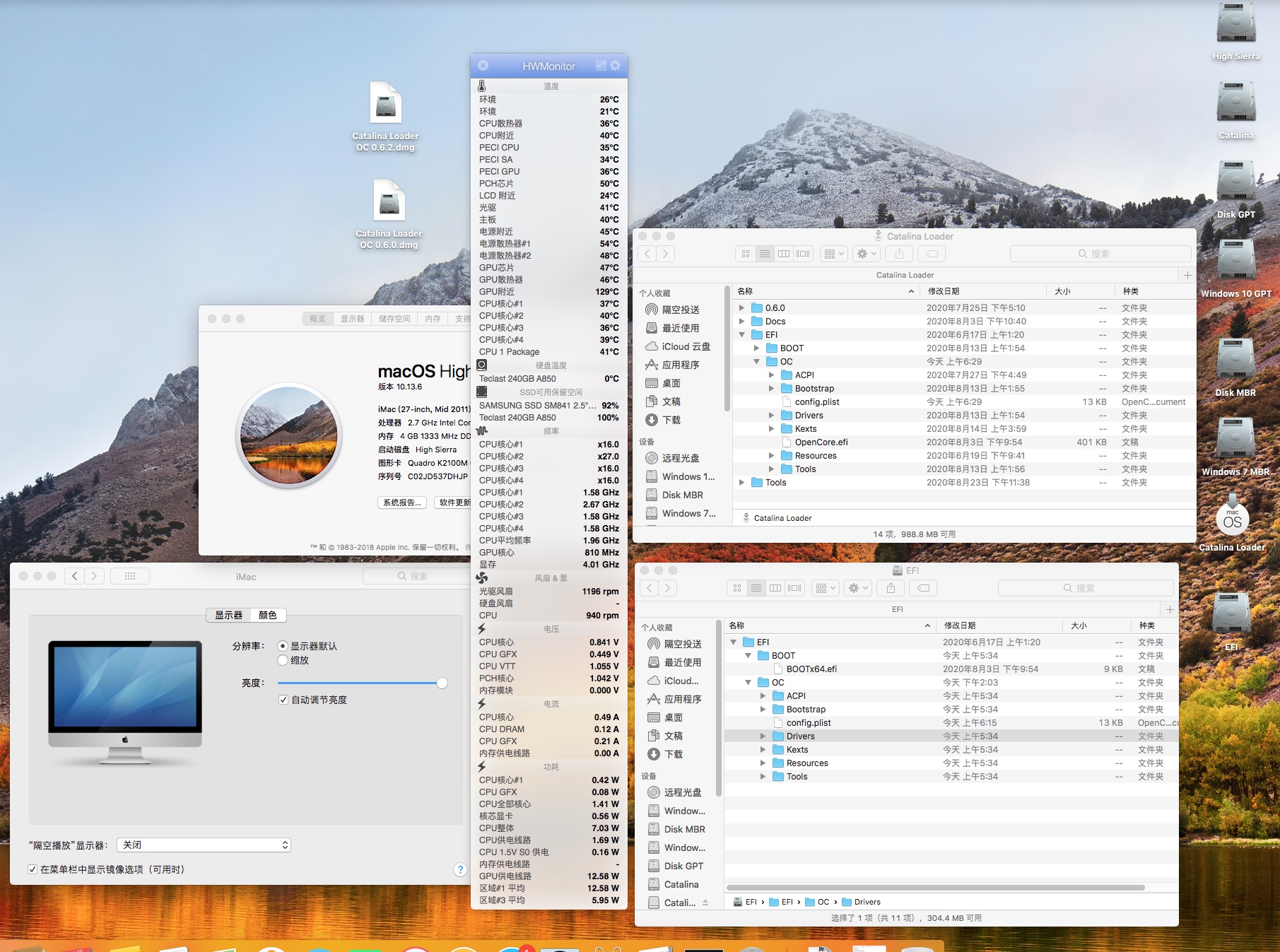

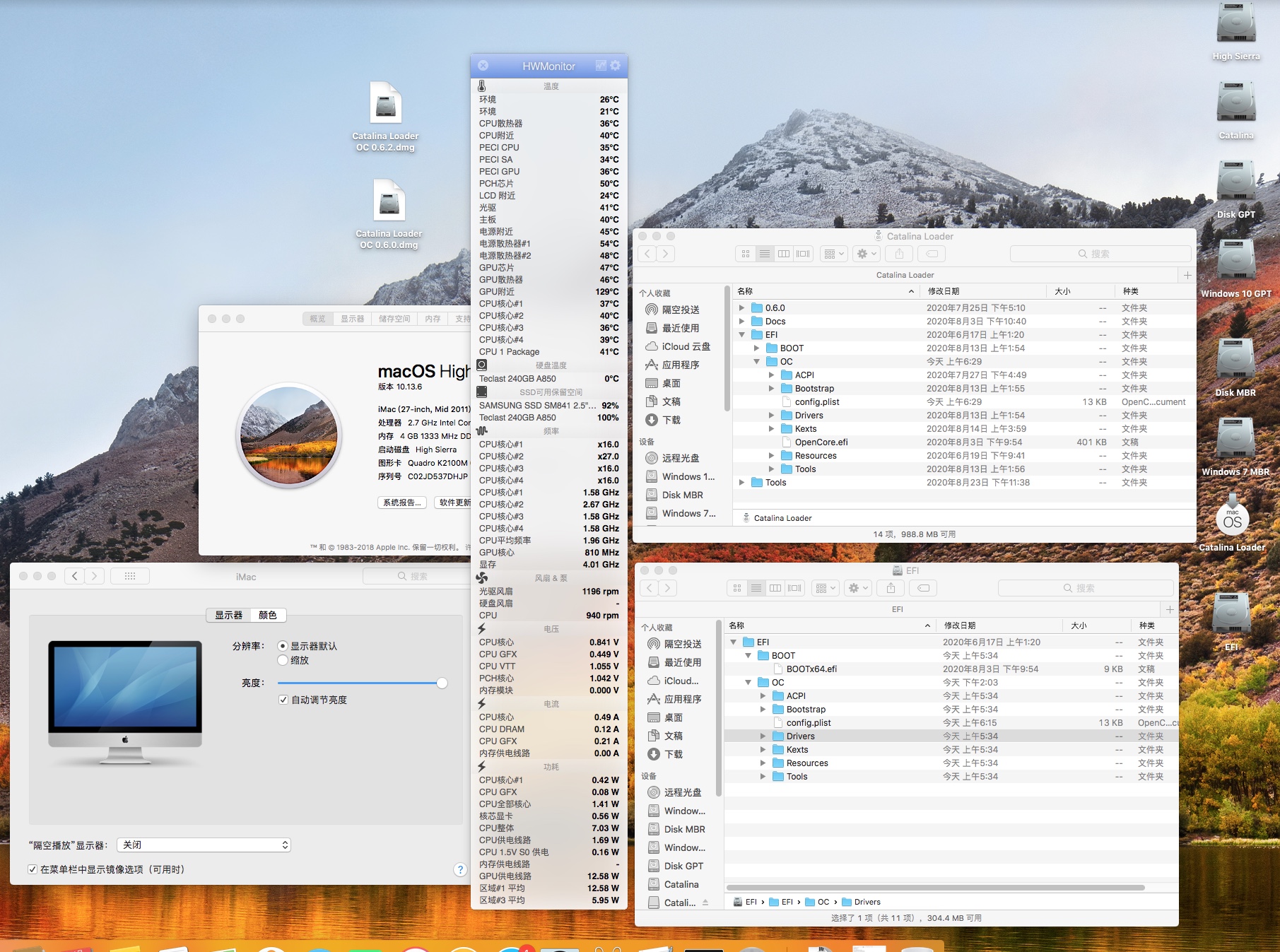

Help oc 0.6.0 version, when oc boot is configured, there is brightness adjustment, only about 80% brightness can not be the maximum brightness. How to set iMac 2011 27 k2100m, oc boot U disk efi copy to SSD EFI partition, unplug U disk oc boot fails. How do I need to configure it, or do I need a U disk oc?

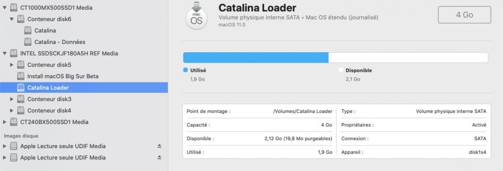

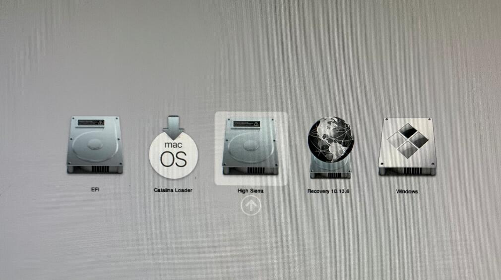

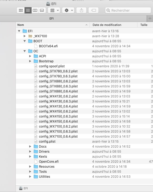

My question is not specific to my config, but more broadly related to the (non) working procedure of opencore install, as i cannot find a way to burn the dmg to usb with balena etcher (i think that's because the DMG has a password "Nick" ) and i would like to keep the SD card and the USB port free so i'm tryn to understand if i can put opencore inside the system EFI (or the reason it's not advised)
You can create a small HFS+ partition and put there all files from Opencore image (invisible files too).
And as you have an NVIDIA card with a Native Apple bootscreen because you flashed it, you can put just the Opencore EFI folder in the EFI partition of a secondary SSD, not the main boot disk. This way, if you have to do a PRAM reset you will default to Apple Bootscreen.
It's dangerous to do that with an AMD card because, in this case, you have no Apple bootscreen (GOP vbios) and can be stuck if you misconfigure Opencore. With no other solution than reopen iMac to disconnect physically SSD or HDD to make your boot selection.

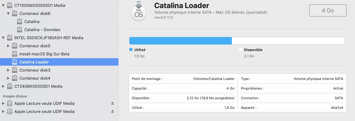

Hi, First thank you for all the work to make this available. A question on the OpenCore Loader: is it possible to put the loader on a separate APFS volume and boot from it, instead of using a SD card(or external USB drive) to boot?
No, it has to be a Journaled FS, no APFS. Read the original OpenCore docs on Github or search for the Opencore on Mac thread to get an idea what options you have. We kept it that way because it is easy to maintain for the mass of users not being able to do deep dive terminal explorations.
Do not follow these options with an AMD card, there is no native boot screen available and you will it be able to recover from a bad config other than plugging your internal drive.
