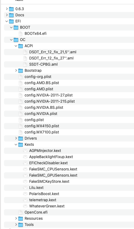

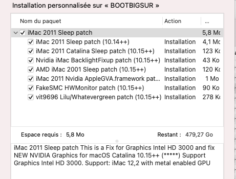

I have a SD card with OC 0.6.3:

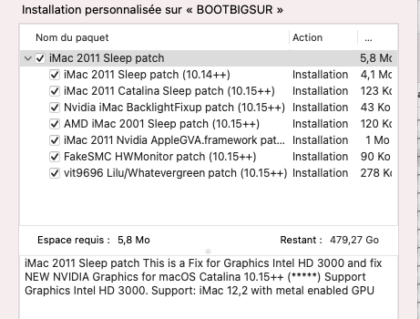

Should I install your patch with only select "AMD iMac 2001 Sleep patch" for my Imac 2011 with AMD WX4130 ? (201 should be 2011 in the description in your patch install ?)
You are kidding me?
These installer packages are are made for Catalina or Mojave, NOT Big Sur.
Please start to read my posts before press the download button. And read what is printed in the windows....

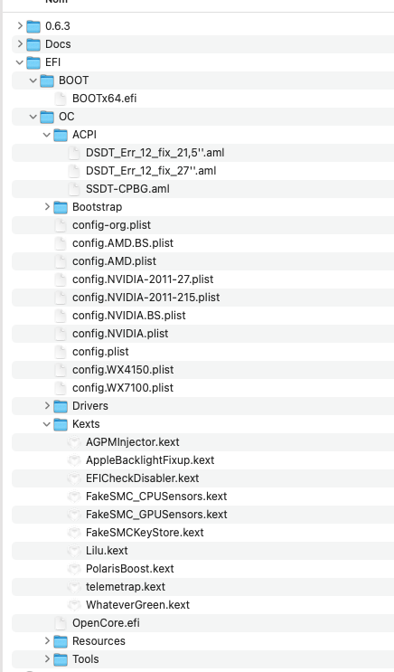

Upon testing the RX480 for a few days, it really works very well WITH the OpenCore Catalina Loader 0.6.3 seamlessly.
But it does run a little hot with an idle temp of ~50C, reaching ~70C during benchmarking, and dropping down to ~40C upon waking from prolonged sleeping.
I have an internal SSD partition into High Sierra and Catalina in APFS format, and the OpenCore Loader in the SD slot.
I noticed that after setting the Startup Disk once to the OpenCore Loader, even if I reset it to the Catalina partition, it will still start up automatically to the OpenCore Bootloader pickup screen.
If the Loader is removed on restart, nothing comes out for internal display or external display.
But on key press, I can hear the sound response, just no video out.
When I try to reboot to High Sierra via either the Bootloader or by setting the Startup Disk in System Preferences, the 1st stage boot (full brightness screen) can work all the way to fill the status bar but then stop there, without proceeding further. So, now I can't boot back to High Sierra.
Any possible solution to that ?
I am thinking to put the patched AppleGraphicsControl.kext into the S/L/E of Catalina partition for the black screen when without OpenCore Loader as that seems to be culprit as described by many in previous posts. Will see whether this will solve the issue when I am back from work tonight.
However, I don't think it will solve the problem of failure to boot back to High Sierra with the Bootloader. Probably the OpenCore components need further fine-tuning as it is meant to boot into Catalina (and BigSur) but not older OSX.
Problem solved. It is related to corrupted prelinked Kernelcache on replacing the AppleGraphicsControl.kext into S/L/E. I rebuilt them in Terminal and can dual boot again with or without OC.

You are kidding me?
I'm sorry :( I was a little tired yesterday and I translated too quickly in my head "[...] install files on Catalina 10.15.4 and later ! " later by later OS . Your post is clear, no problem, I was the one who made a mistake.
May be that's why the EG ROM is now favored by Ausdauersportler for troubleshooting.
At least you would have an external display for manipulation of the system.
But I don't dare to flash the Bootrom of my iMac at this early experimental stage yet in case I brick it. :oops:
No AGC and no AppleBacklightFixup for AMD cards, ends up in the situation you are describing. Have you really checked the RX480 post I made with @internetzel new Bios?

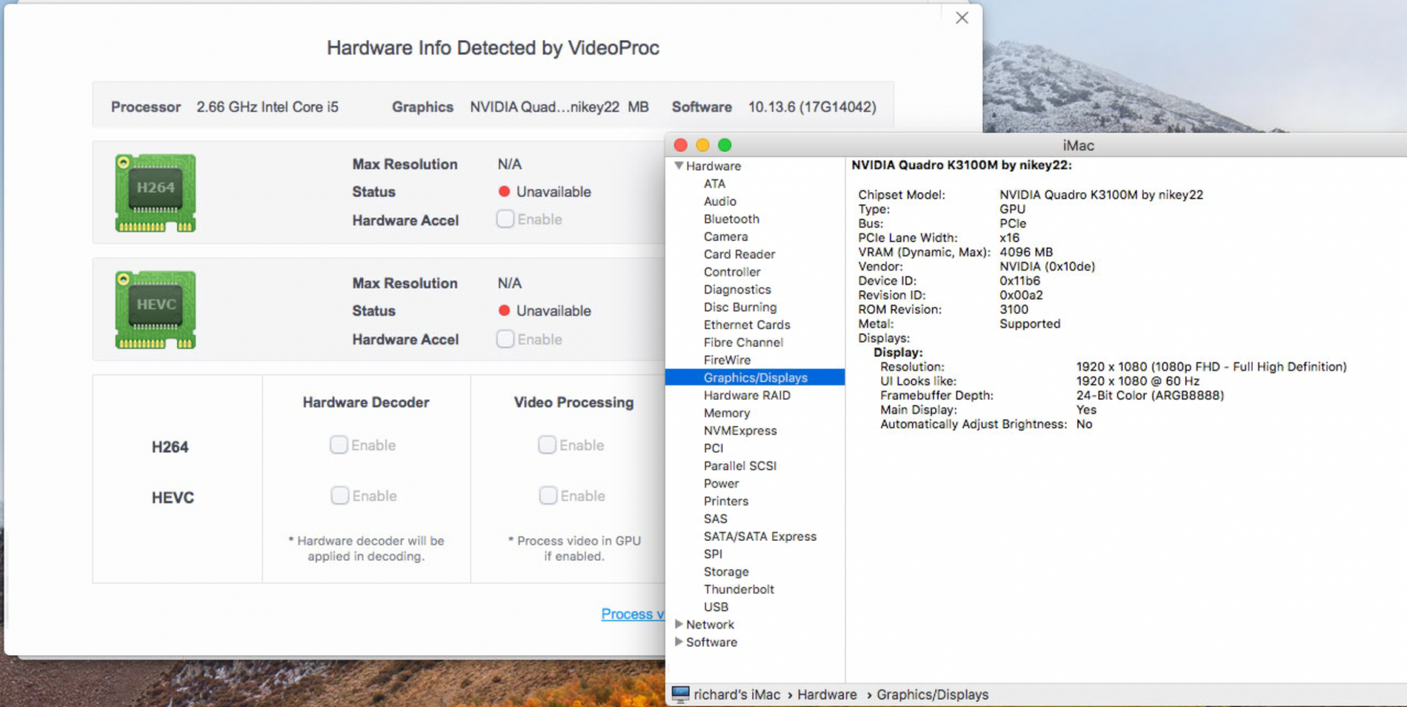

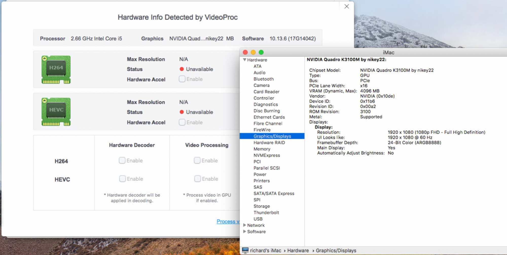

So I put the old ATI back in and eventually managed to boot the thing in safe mode to install HS via an external screen. It's since done all the updates successfully. In an overly excited manor I've put the K3100 back in but have forgot to disable SIP.
The issues remain basically but slightly different. I can boot in to HS with the K3100 but the external display is corrupted now, I did enable VNC with the ATI installed and that thankfully works fine. The card is correctly found and I can see the BIOS is by Nikey and everything appears to working well. Hard to say over VNC but seems HW acceleration is working.
I can't boot in to the recovery console to disable SIP as it appears to get to the same point as described in the boot process and lock up. I can't boot the Catalina Patcher either as it also gets to the same point in the boot process with the same IOConsoleUsers message as the last entry to the screen if I do a verbose boot.
Argh! looks like the ATI back in and SIP disabled and I'll try the AGC patch. Not convinced that is going to work. Suspect I might have hardware issues somewhere :-/
So further picking at it shows that while it appears that the card is recognised, should it now not show in videoproc as having HW acceleration enabled? See below - anyone got an ideas what's up?

I've updated it....for more context, the iMac (late 2009) wouldn't boot to the High Sierra installer with the K3100 in. Put the old ATI card back in and booted in safe mode for the install. Put the K3100 and I have a scrambled external display (VNC works) and I can't boot to recovery console. Each time the boot failure stops at an IOConsoleUsers message, also does this with a Catalina Dosdude boot. I haven't yet got AGC updated for the internal display, will that affect this? (because I stupidly didn't disable SIP while the ATI card was in).
The AGC fixes the black screen, not a scrambled screen. If you cannot get an Apple Installer or an Apple macOS version to boot into graphics mode the card is probably damaged.
And at this point all my help stops. Go back to post #1 and read the post about hardware problems.
Cannot be really possible. And now please report output of this script....to cross check.
chroot: /: Operation not permitted - this is the issue probably. Should i try to run this from the USB installer / terminal?
Unknown GPU model. This may be a patcher bug, or a the original Apple iMac AMD GPU which is
not really supported by Big Sur and will run without any graphics acceleration.

This code is part of the patch-kext.sh - so if if works right now on your system it should work within the patcher, too. Therefore I do not understand why your patching came back with "unknown GPU".
Checked the code here on several systems with NVIDIA and AMD card from the booted Big Sur terminal app and the recovery USB Installer. Worked in both environments....
You may revert patching on Big Sur by patch-kext.sh -u and repatch after reboot from Big Sur by calling patch-kext.sh, again. Then you might save the terminal output ...
Yeah, i'm not sure whats the issue is, but i modified the patch and included my device id manually and run the patch like this, works fine now. I think its a permission issue with the chroot... line, not sure why it doesn't work for me. But doesn't really matter also, i'm up and running now :)
I would like to find the root cause. Patching from Big Sur needs the admin permissions anyway and asks for the password at the beginning - possibly this is a recovery problem? Which environment did you use to patch?

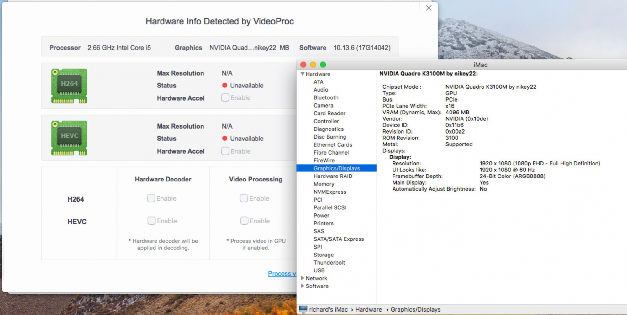

I am trying to get an iMac 27" 2010 (High Sierra) running a K1100m to run Opencore for brightness but it is hanging on a black screen when the graphics loads. It also does not see a boot camp partition. I used the default Nvidia plist file.
Any ideas?
I am trying to get an iMac 27" 2010 (High Sierra) running a K1100m to run Opencore for brightness but it is hanging on a black screen when the graphics loads. It also does not see a boot camp partition. I renamed used the default Nvidia plist file.
Any ideas?
Go back to post #1 and search for the "black screen" issue. And about OpenCore and BootCamp you probably just search for the original announcement @Nick [D]vB made and which is still linked to the post #1. Cannot comment on this, most moved to UEFI installations...
