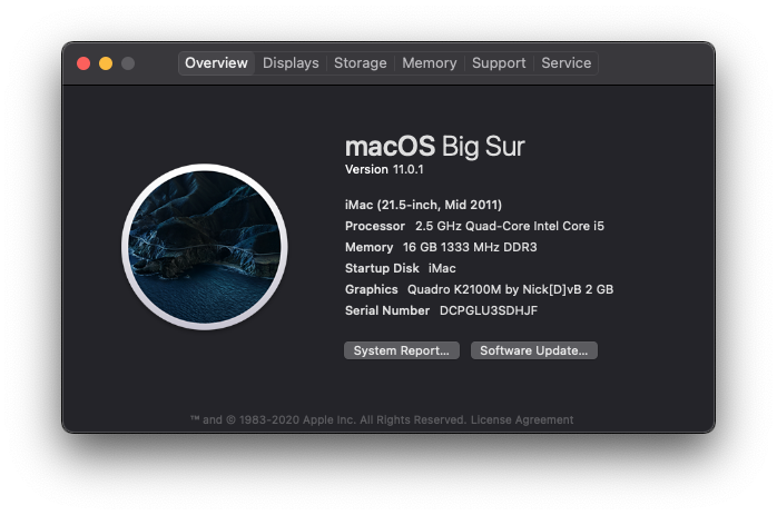

Hi All,
I apologize if someone has asked this. I successfully installed Big Sur onto my 2011 iMac with a K2100M (flashed). I grabbed the latest OpenCore files and copied them into my previously working Catalina Loader USB. I then renamed the NVDIA plist as per the instructions from this post: https://forums.macrumors.com/thread....1596614/page-347?post=28769981#post-28769981
Everything looks good and I can boot from the "Catalina Loader" if I hold alt down when booting the iMac, but I can't select it as a Startup Disk in System Preferences. Confirmed it has the bootable flag in disk utility, so I am not sure what is going on.
Any ideas? Thanks!

Yes, when messing around with two such SD card only the first will get the mount point /Volumes/Catalina Loader and only this will be selectable within as a startup disk.
Just to add it seems I can't boot in general unless I hold the option key. It chimes and then the screen stays black. Likely related.
Ausdauersportler
Hello dear friend! and I also think about installing big sur to be in the trend) but I have doubts, does it make sense? will this affect the speed of the final cut ? if not ) why? what are the advantages? thanks!!!
Hi All,
Any ideas? Thanks!
Have you tried to boot without C.L. inserted?
Thanks everyone. I think there was something wonky leftover from my last install. Dumped rEFInd into the EFI partition and set Catalina Loader as the default boot option, disabled the wait time and now everything is working.

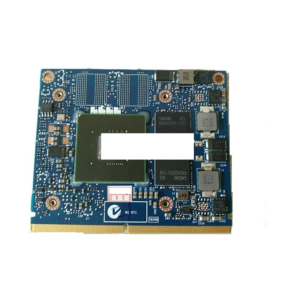

so guys, I have a little gift for you to give back after such an incredible thread :D
hope you like it, the headaches to get it running were immens for me as a newb.
I couldn't stand it to use fckin windows to flash the cards and so I prepared this ~350mb drive
I created a Linux Live USB (based on grml.org) Thumb Drive with nvflash_linux and Nicks Bioses preloaded. and its booting by itself so you can work blind with a new unpatched nvidia card plugged in. Also, its starting a ssh daemon and using DHCP to get an IP so you can remote login :)
Steps
Download
14 days left to download, uploaded here: https://www.mediafire.com/file/cztz4xqj2sru9gj/2011_imac_usb.zip/file
mirror by NOTNICE, thnx: https://cloud.notnlce.com/index.php/s/xkJP34GD6a9WziE/download
Prepare USB Drive or SD Card
so, you take a small usb thumb drive, partition it with disk utility on a Mac: GPT + FAT32
and just unzip the files structure onto the drive, no dd or etcher or something. just copy paste it. folder structure see attached screenshot. (you can remove the .roms I downloaded and download itself if you want to be sure about the correct file size. I did not verify them at all. use/flash at your own risk please)
Test & Try
test your thumb drive with a more or less working GPU/ external Screen or just have faith in me
Swap Hardware
swap your GPU to NVIDIA and (!) disconnect every SSD/HDD, makes it easier to boot blindly from one USB or SD Card, connect the ETH Cable (!)
Find IP
let the iMac boot, everything is black, the boot loader is waiting 20s before booting, so give the whole process 1min time, then head over to your Router Page and find the right IP that the iMac got through DHCP
SSH to the iMac
now fire up your terminal on a Win/Mac/Linux Machine of your choice and ssh to your iMac with
ssh root@YOURIP
Password: flash
Confirm the ssh id with yes and you should be in your iMac
Working Directory
cd /lib/live/mount/medium/flash
read the RADME in there… I will enjoy my brand new k2000m in my 27" 2011 iMac with Catalina 10.15.3
… and because this is so easy, I rebuild it to a K1100M and flashed that also :D :D :)

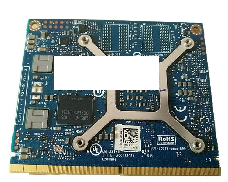

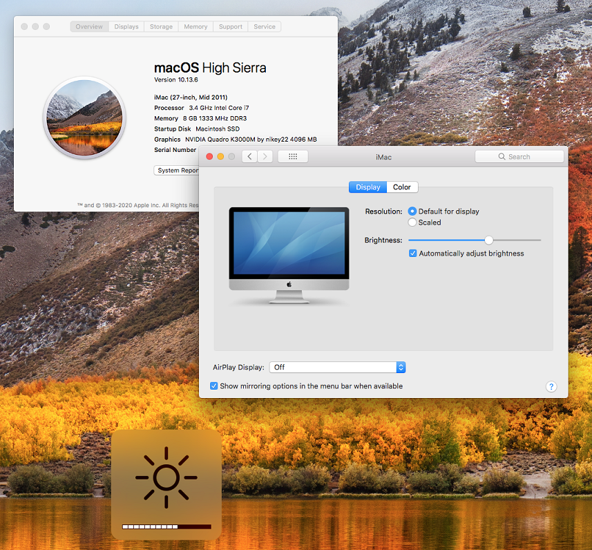

** NVIDIA Quadro K3000M Mac Edition ROM **
Genuine Native Boot Screen & Brightness Control
Preamble:
These cards are designed with a PCI legacy 2.3 architecture (2002). This is reflected in their roms which has led to some trouble developing a compatible rom for the iMac. My rom has a modest clock table boost as well. These workstation Quadro cards really boost well.
Pre-installation Requirements:
- iMac (27-inch, Mid 2011) , model: A1312 (EMC 2429) Mac-942B59F58194171B (Test machine)
- BootROM: 87.0.0.0.0. Please use High Sierra to update your BootROM to latest version.
- Nvidia Quadro K3000M, GPU Variant: N14E-Q1-A2 Dell or HP
- Heatsink 3-pipe with appropriate clearance mods for the inductors
Known working GPUs:
-Dell K3100M vbios: 80.04.5A.00.01
-HP K3100M vbios: 80.04.33.00.2E
Post-installation Requirements:
Brightness Control Stepping Mod:
-Turn computer on, hold down Command(⌘)-R
-Choose Utilities > Terminal
-Enter:csrutil disable
-Reboot
-Download and open 'Kext Utility v2.6.6'
-Navigate to S/L/E (System/Library/Extensions)
-Copy "AppleBacklight.kext" to Desktop
-Edit: AppleBacklight.kext/Contents/Info.plist
-Scroll down to: IOKitPersonalities > AppleIntelPanelA > ApplePanels
-There you find several Apple LCD profiles.
-For the iMac 2011 27" machine locate:
Code:
<key>F10Ta007</key>
<data>
ABEABgALABQAHAAnADMAPwBOAFwAZwBzAIEAkQClAL8A2wD/
</data>
-Change the <data> section to:
ABEAAgA3AF8AigCzAOsBJAFnAakB1AIJAlQCogL4A00DlgRpBGk=
-Drag your modded kext into Kext Utility, allow it correct permissions
-Applebacklight.kext.bak folder will be created
-Reboot
The above data pattern will allow for a wider span of steppings for the brightness control and utilizes more of the capacity of the HD3000. If you have a different machine, your panel ID can be found by going to System Preferences > Displays > Color > Open Profile > mmod
Caveats post-install:
-16bit resolution glitch of UGA_DRAW_PROTOCOL - temporary solution: activate a sleep cycle
- 4096MB instead of 2048MB reported by memvendorID {00 10 00 00}: looking into it.
- WSON based bios chip. Clip rescue is not possible
Insanely Great!

HP QUADRO 3000M 2048 MB BIOS vbios: 70.04.42.00.05
any solution or this video card it doesn't work?
Many thanks!
You have an incompatible HP QUADRO 3000M, you need a compatible Kepler K3000M - you see the difference?
